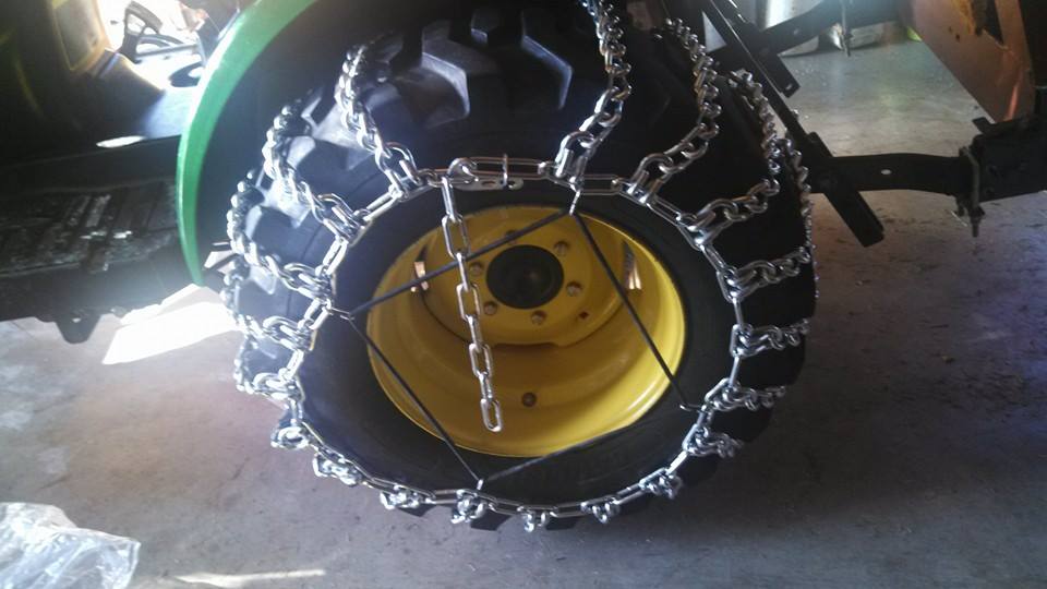

Three of my neighbors chipped in and bought me snow chains for the tractor because their driveways are on slight hills and hard to keep tractions on.
I got a 2 link chain from tirechains.com that needed a little adjustment to get them to fit tight enough - had to drop 2 cross links and then removed about 4 side chains that would otherwise be banging around..
My questions is- Are the chains suppose to be straight across or is it 'ok' for them to be a slight diagonal? you can see in the pic that each side drops down in between the lugs and are just slightly angled.
At 56 lbs. per chains they are not the easiest thing to get on, much less trying to reposition them while getting them tight enough that they run straight across.
thanks

Ill will add - IF you have to remove any cross links dont waste your time with a hammer and cold chisel.. I spent 45 minutes last night trying that method and could not get one side of a link wide enough to get them off.. I ended up using a long handled screw driver to pry the links open. it only took a few minutes per side doing it that way..

I don't see a problem with your chain mounting. You could cut off all but three links of those dangling ends. I would save a couple because sometimes it is easier to cinch up first with the second or third link, then re-cinch using the first link once you get the chain pulled into position.
A 4" angle grinder with a steel cutting wheel is your friend for cutting those chains.
   / Snow chains question #6
Contrary to the popular belief around these parts, tractor tire chains should not be tight. Unless you have serious clearance issues and plow at higher speed, they should be very loose by car/truck standards. You should be able to get your fist between the side chain and the tire. Most tensioners are a waste of time. The goal is to continuously drive over the chains and not have them fall between the lugs.

There was a discussion about that a while back. I don't see how "driving over the chains" avoids a lug landing between cross chains? There are more lugs than cross chains. I've seen chain mounting instruction videos that show the fist clearance from Tellefsdal, the company that made my chains. I still don't get it. :)
I do have side clearance problems on the inside. If I turned my wheels around I would have fender clearance problems on the outside. My chains are not "fist" loose, they are loose enough to creep around the tire if there is slippage.
