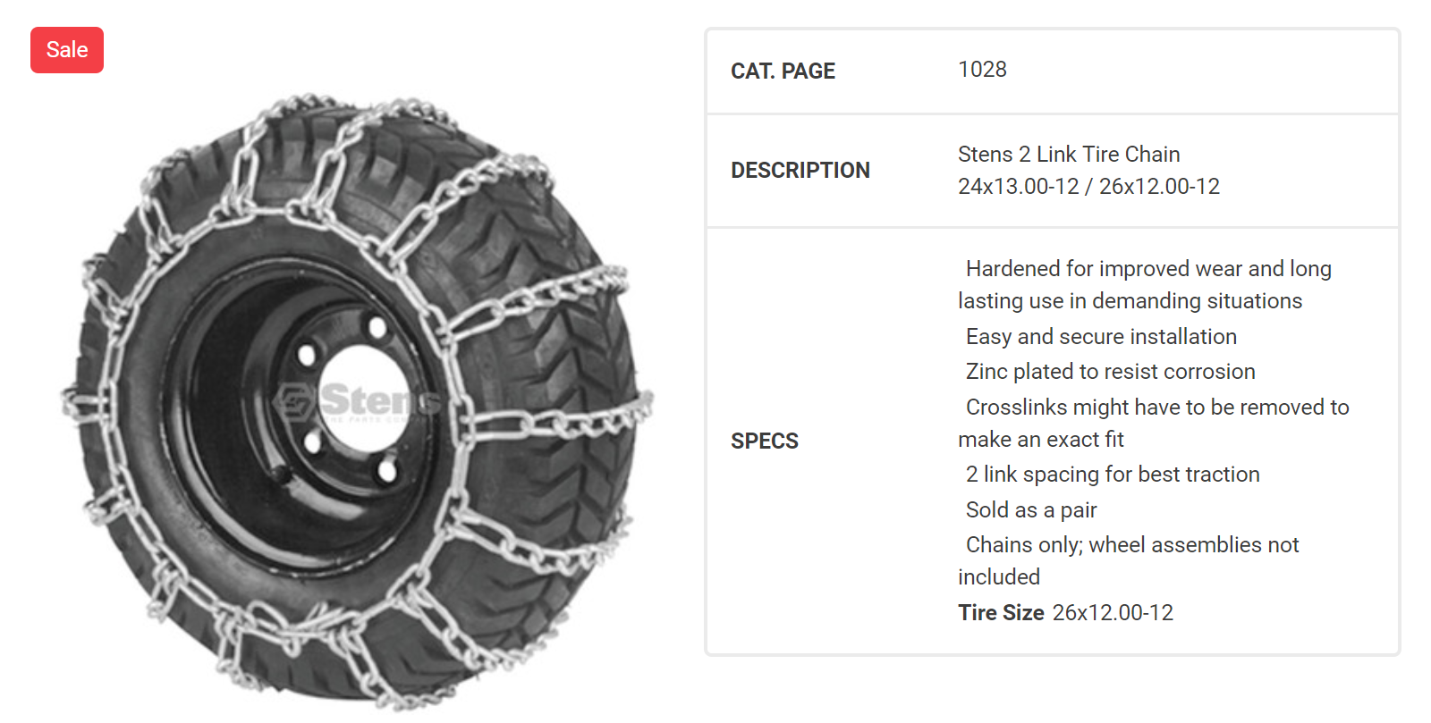

I just ordered 2 pairs of these:
At ~$85 /pair they seemed like a decent option. No spikes and no webbing, but I have used this type of chain for years on other applications and never had a problem, besides adding some springs or bungee cord to keep them tight. I am a little worried about the clearance, but we'll see. It wouldn't be too hard to make some wheel spacers either. Obviously the 1850 has stud-length to spare, but I'll let you guys know when I see them.

those look very similar to what I have......I will warn you that with bar tires my experience has been that you can never get them tight......there's always a bar interfering right were a chain row is so I just get them as good as I can and accept that there will be a clickety-clack.......lol......I originally got the bar tires thinking they would provide more traction versus the turf tires but after having them I'm not sure it really makes a difference on these machines....especially the smaller models......I'll stall or because of the center pivot I'll crab long before I'll lose traction........Jack

Just bear in mind that bar chains are great for forward drive, but are almost worse for side slip. You might consider getting a chain tool to get those puppies tight. It’s tough to get enough leverage normally.
If they don’t work out, tirechain.com has studded and non-studded net chains. They don’t seem to make the European style net chains in your tire size. (26x12-12)
