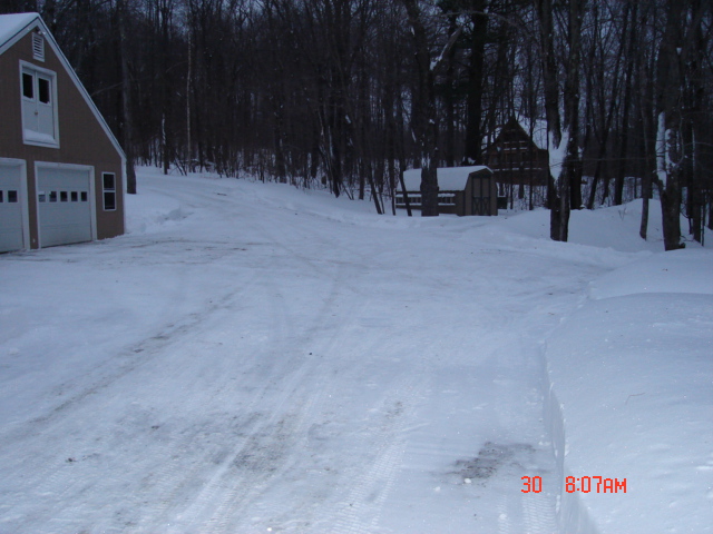

Larry, I bought a set of chains when I got my 2310 & front blower; it came with turf tires so I had my doubts.... but have never need them. They're still shiny new in their box.:D
I leave the BH on for weight in the rear, which I'm sure helps with traction. Perhaps you can see the slope of my driveway as it winds around the side of the garage... it gets steeper (by quite a margin) as it goes up.
The only trouble I've had was with the front getting very light, and steering becoming unresponsive, going uphill- so I just stay in the middle on the way up, then do the rest going downhill, backing up the drive bewteen runs. Two additional downhill passes and it's done.:D:D
