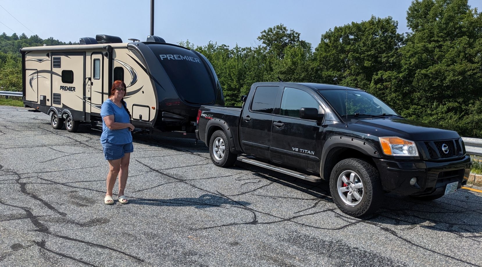

I have more than 1/2 worn E rated Falken Wildpeaks on my 2012 Nissan Titan. I have to drive very alert and slow in the snow and ice. I am taking a chance just to be foolish a cheap *******, planning to hold off on buying three peak rated LT tires just before our camping trip to the Blue Ridge mountains. Hopefull the Blue Ridge Parkway will be repaired by then and meanwhile I dont stuff the truck into something.

Why would you get rid of tires that are only half worn out?
If winter is a big concern (spring is around the corner) get a set of winter tires and wheels. Being in NH a set of true winter tires/wheels would make sense and then run your current tires/wheels spring/summer/fall.

We have extended family on the farm with 7 vehicles, 5 of which have extra sets of mounted winter tires. Plan is to run the Falkens to September and just get a good set of all climate tires. Storage and changeover is a pain.
