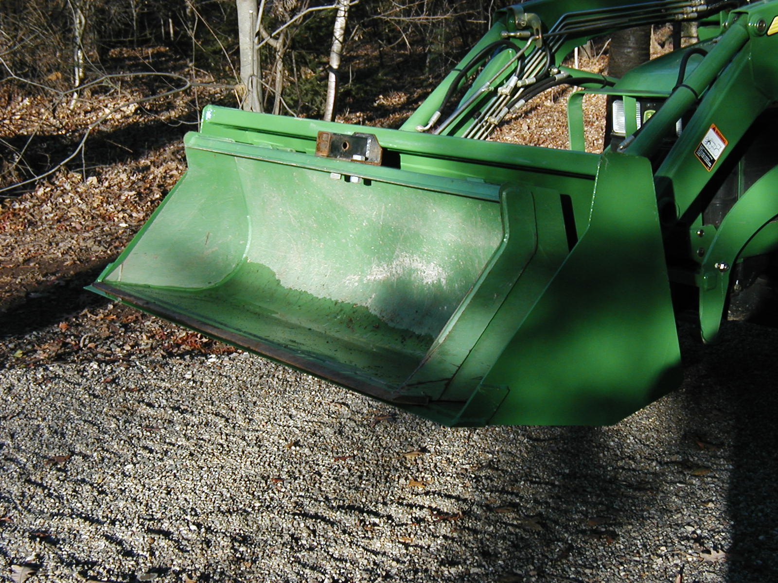

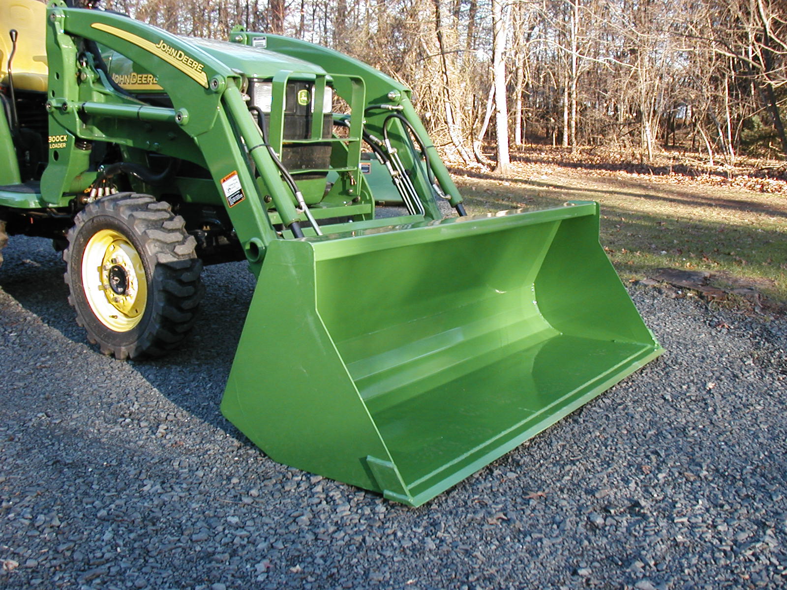

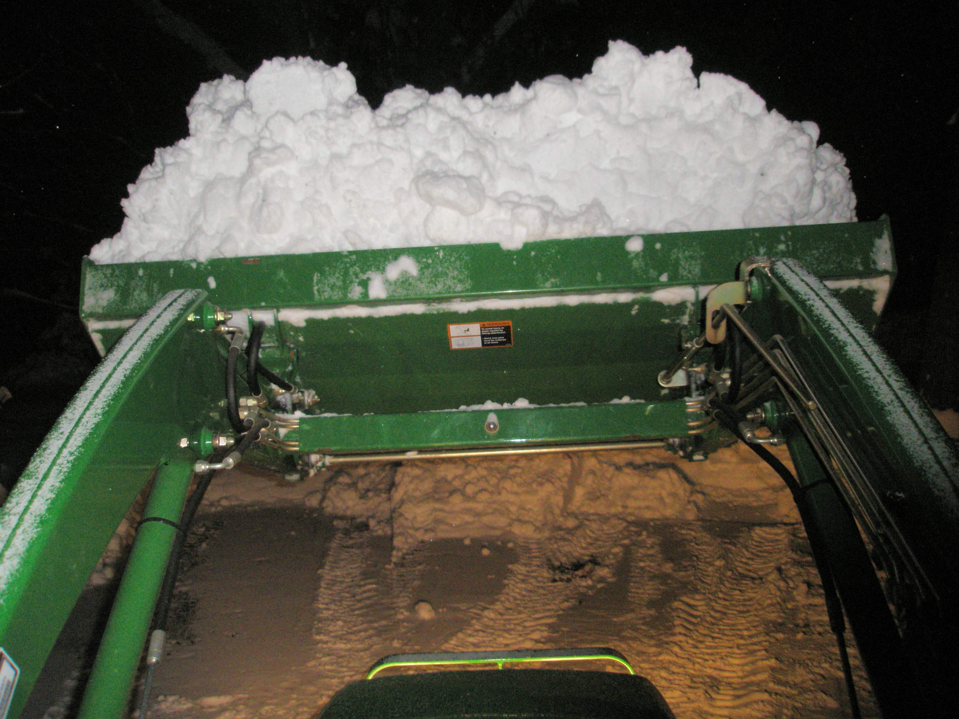

I do the same as Diamondpilot with the plow, for last 2 years but before that I bought the next size up bucket from 61" to 73" also called a light materials bucket.
The bucket is lighter duty but deep and tall for light materials like mulch, shavings etc.
Snow is not always light but the machine handles it and it made a huge difference. Even though I prefer the plow now because it's much faster especialy for lighter snows, I need to put my loader on for a few hours of moving snow out of areas I couldn't push it back any further.
