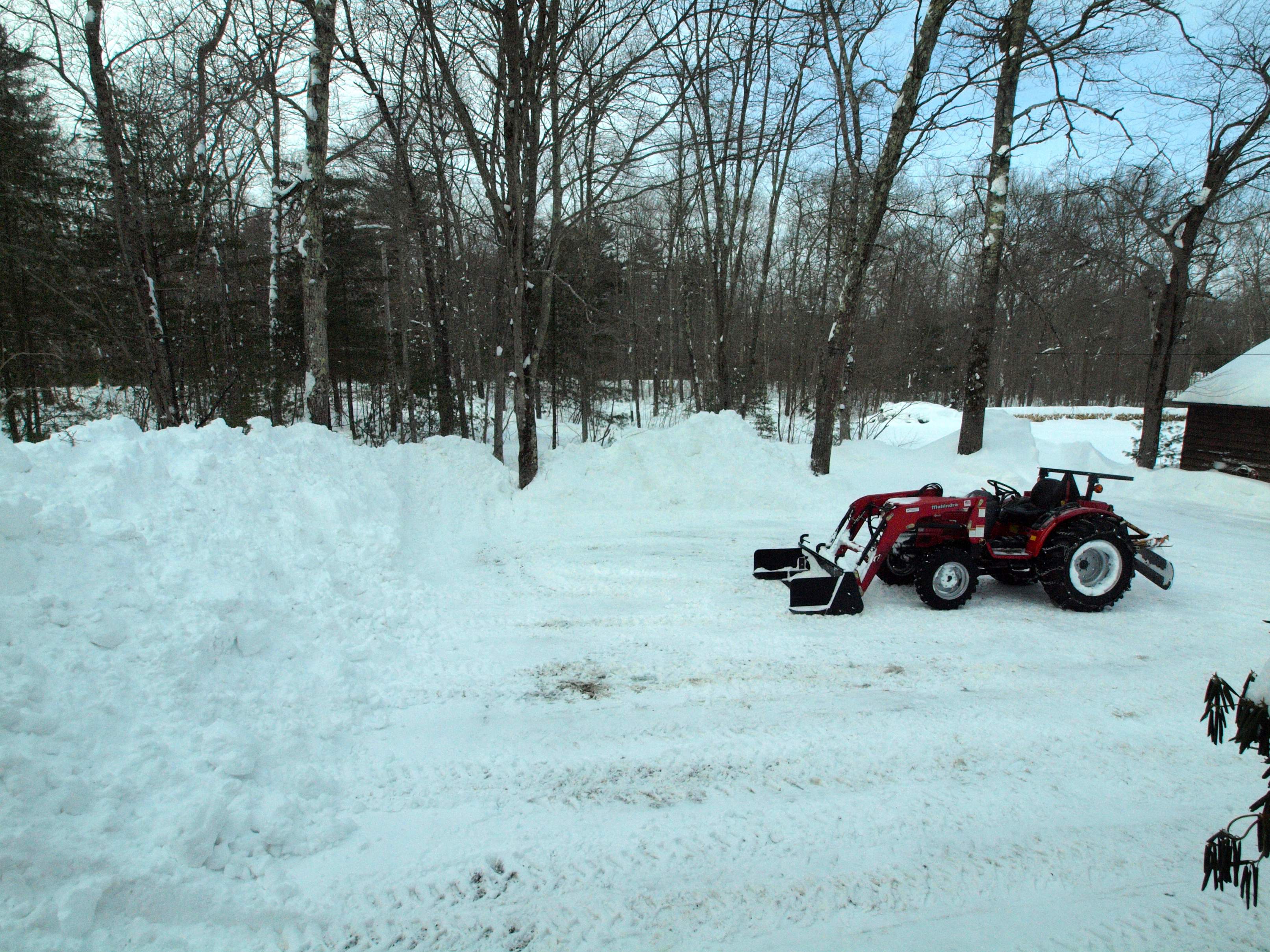

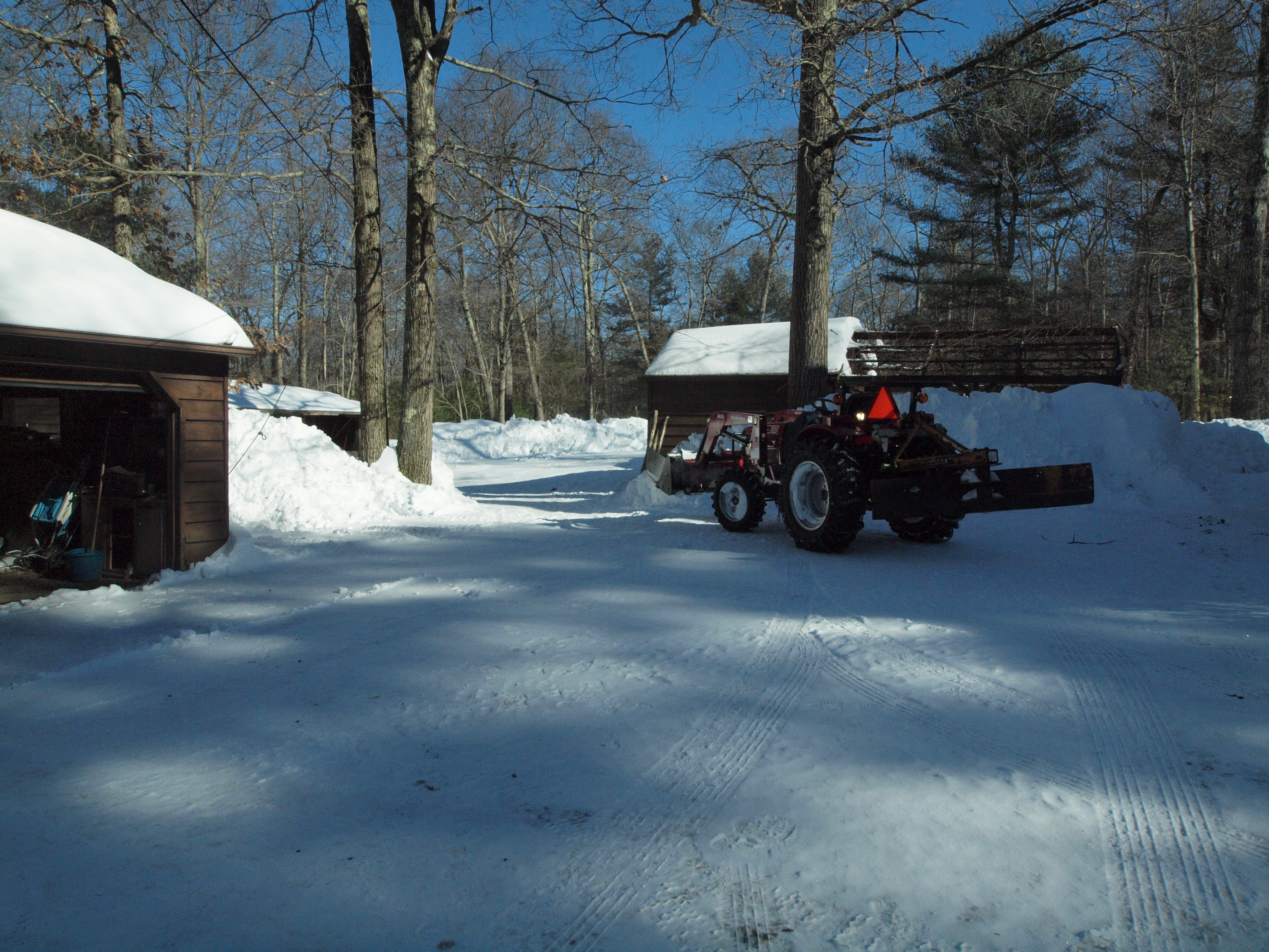

I also have a 130' drive but at 12' wide. I have a lot of "landing" area to clear however that must total about 1/2 an acre. The bucket on my tractor was so shallow, I made a pusher out of it with just a bolt on for sides. 50 bucks. I'd also strongly consider a rear end scraper blade. The two items work very well in tandem.
A snow bucket in my mind would only be appropriate if you had to transport snow out of an area because of lack of room to pile it. Otherwise a pusher and scraper is way more efficient.
