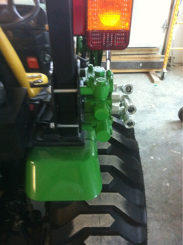

Disconnecting will work, but you will lose control of one bucket function. I tend to leave my bucket off most of winter so I probably wouldn't miss it.
You could also get an additional hydraulic control block if you want and have it plug into the power beyond hoses. You would have to disconnect this block to attach the backhoe.
I added my own rear hydraulics as I didn't have power beyond. The valve would be the same if you decided to add one, except you would have the ease of plugging the hoses into the power ruins.

Not knowing hydraulic controls from "shinola" What would a control be called that I could connect via hoses to my existing PB outlet to operate just the chute rotator? Would that be called a spool valve, and would it have a single handle much like my loader joystick? Possibly there are plugs in unused "ports". Couldn't quite see how many handles on you install (looks quite nice from that view) , but you apparently have two outlets and two returns? I'll visit some hydro web sites to try and educate myself.
