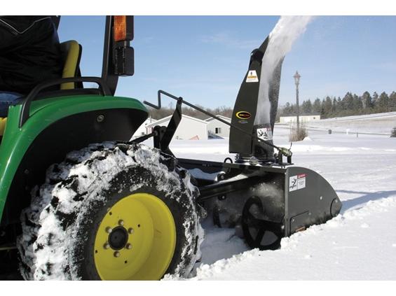

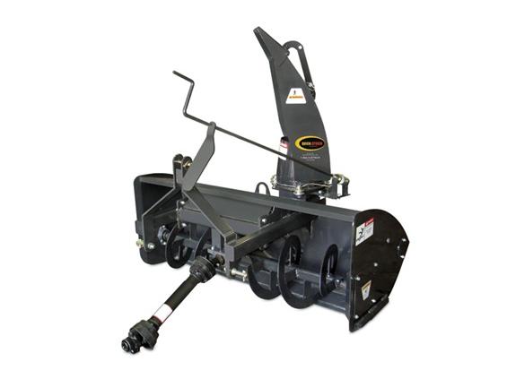

I recently learned about this "pull behind" snow blower model by QuickAttach Inc. This would be the model I would choose if I was buying a snow bower.
   / Snow Blower help #9
Pull behind is nice so you can drive forward. BUT remember you have to drive thru the snow before snow blower blows it. Your packing it down and if it's big drifts your driving thru it or trying to.
   / Snow Blower help #10
Yes thats true. The most we get here is about 18-20" at one time. Thats only 1/2 way up my front tires. That may not be the best for some locations. I like the front mount models too. Drifts are another matter. I could always knock them down with the loader bucket.
