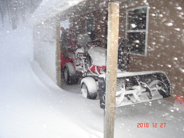

   / Snow Blower for GC2400 #8
Yah... see all that wet stuff hitting the windshield of that cab and dripping down? Guess where that all lands on my cabless 2310.....:(:laughing:
...But at least it's fun, right?? :confused2:
I'm just too stubborn to give up my parking spot. If I had a cab, it wouldn't fit.:(
  • blizzard 12:27:10-5.JPG
