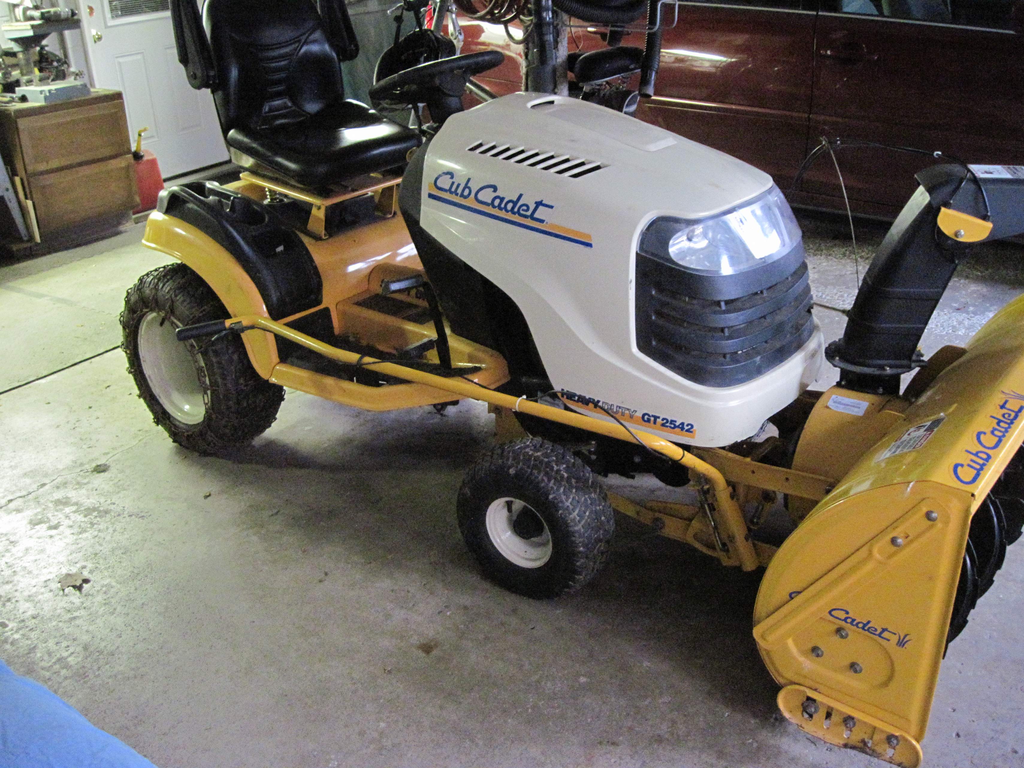

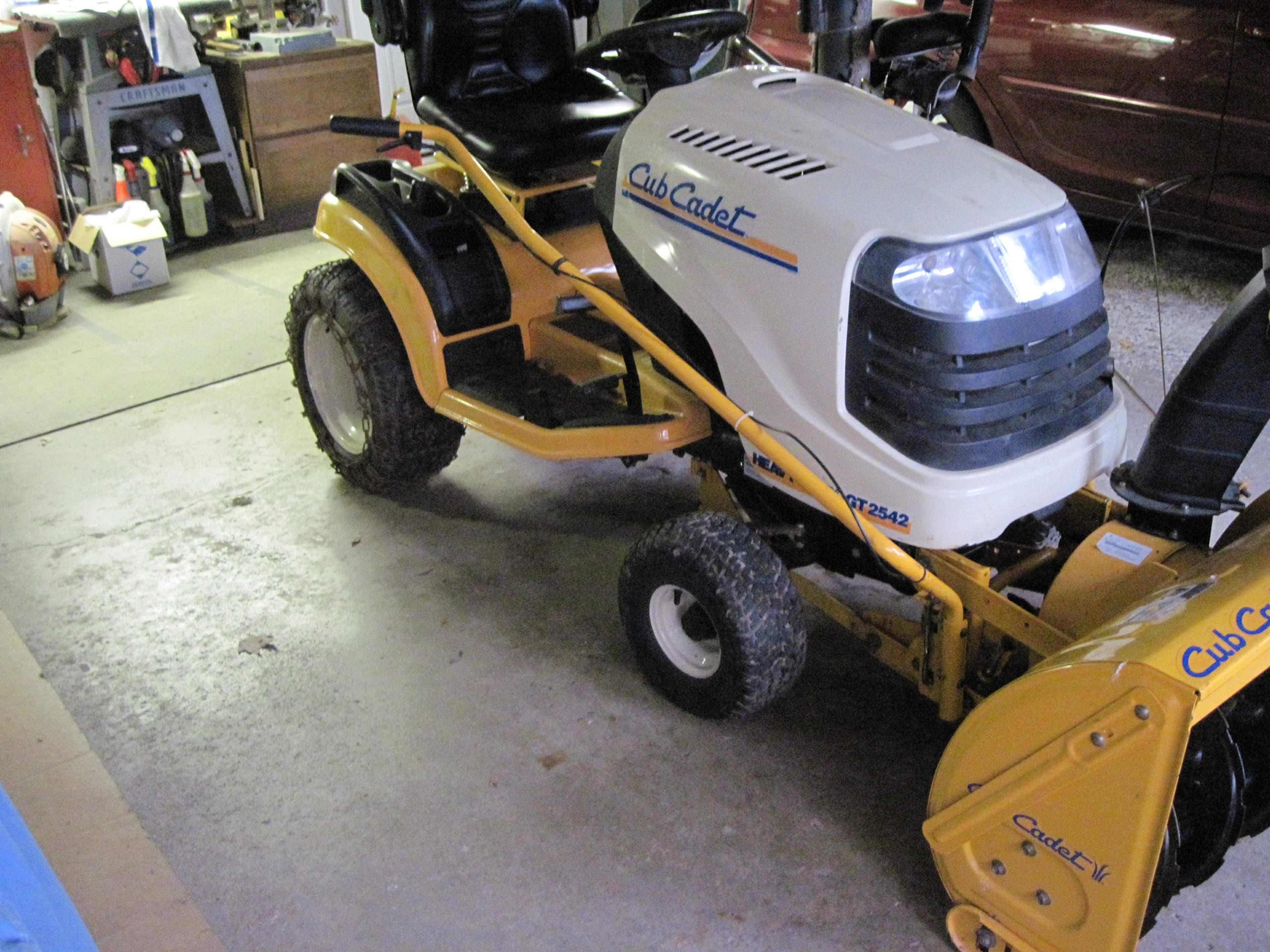

I finally got around to mounting the 190-341 snow blower attachment to my 2542 Tractor. When the snow blower is on the ground ready to blow snow the "lift handle" is approximately parallel to my arm pit. When I raise the attachment with the lift handle, the handle is parallel to the foot rest. This seems awkward and is not easy to accomplish. Is this correct? I purchased the snow blower and it was all bolted together so I have no installation manual or literature to go by. Any thoughts or help would be appreciated.
   / Snow Blower Attachment #3
worse case scenario....Modify the handle to turn up at about a 90 degree angle and you should have a more comfortable position both in the up and down position.
