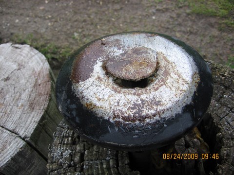

I have a PT-422 with a snow blade on which I installed skids instead of the PT wheel kit. I suspect the wheels may work better than the skids. I am thinking about using the stem caster wheels from my mower and fabricating the support brackets.
Do any of you have pictures of your snow blade wheel kit that you will share? I am willing to share my experience with skids compared to wheels.

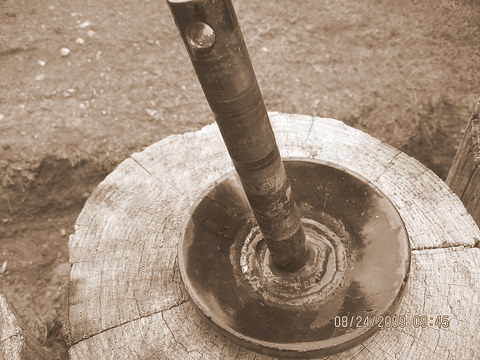

Yes, my skids act the same as your wheels when changing the angle of the blade. One of the problems I have with skids is they seem to produce more drag than I assume wheels produce. The second problem, I wear the skids rapidly. I had them welded twice. They are heavy duty snowplow skids. Third, the skids mark up my asphalt driveway.

I have an asphalt driveway, too. The wheels leave no marks.
I am very surprised that you are wearing out skids with a 1500 pound tractor. I used to plow snow as part of my job at the airport and never wore out a skid in 6 years. Are they the round pancake style skids or the rectangular ski type skids? Just curious.

I have never even come close to wearing out a skid on my snow plow - incl my neighbors, i plow 1/2 mile of gravel driveways.

I wonder if the center pivot of the PT snowplow has enough "play". The snow plow I have on my skid steer has, by design, allowance for the plow to "articulate". That allows it to make contact across the full width, including when the blade is angled left or right.
I suspect that the wear on skids varies quote a bit depending on the surface being plowed--I would expect that a gravel surface would wear a skid less than asphalt and asphalt would be less abrasive than concrete.

As i think about it more, our driveways ice up and stay that way for most of the winter so it is only part of the time that one hits gravel.

That's the problem. The PT plow has no articulation at all. I think an attach setup similar to the PHD or brush hog would work much better. I find the light material bucket more useful for snow in my situation.

Pictures of one of my skids. It has been welded,
