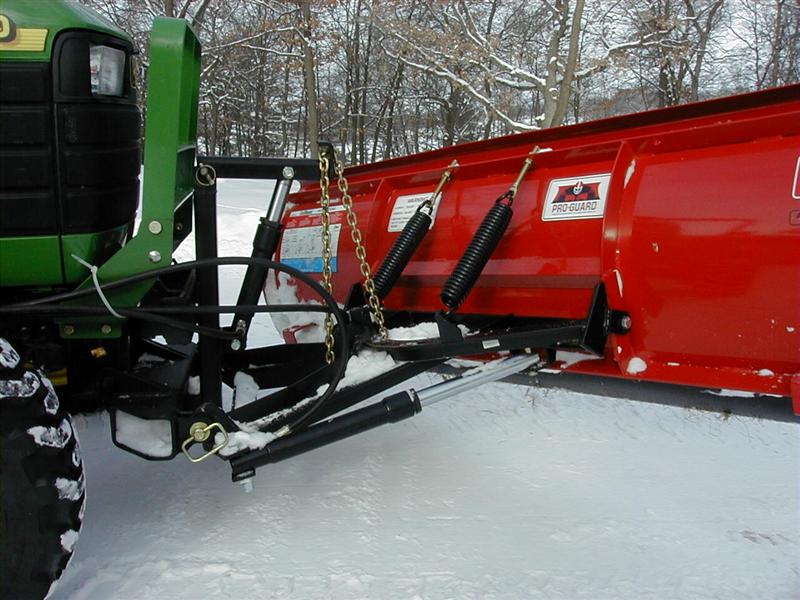

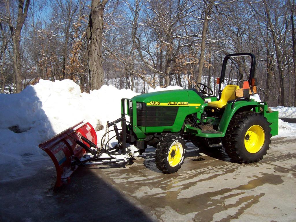

I attached a 7' Western plow on my JD 4300. Yours would likely handle a 10' plow with ease. Built the bracket to quick attach to the front end.

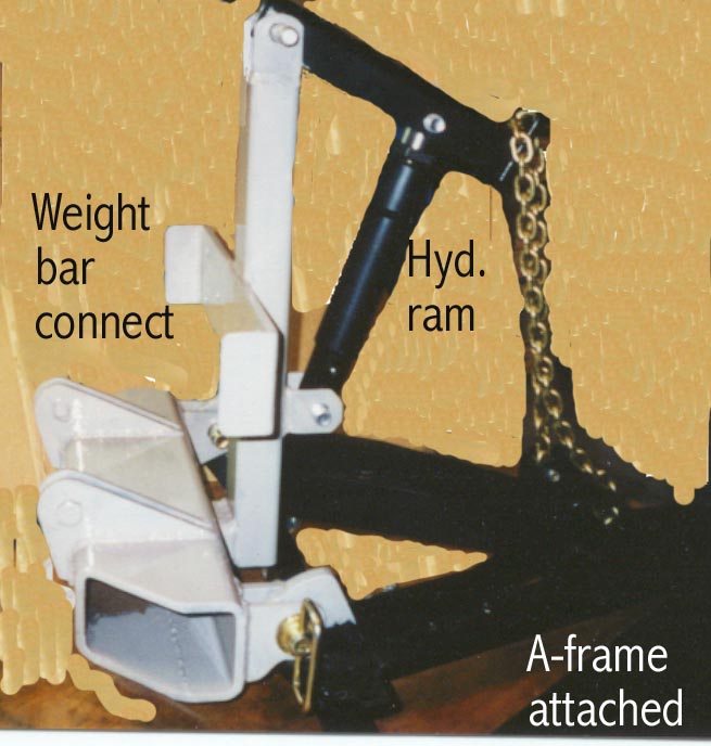

I appreciate the input I have received so far. "Been there" how did you attached it to the frame of the tractor? It looks like the FEL hydrualics were used for the angle rams but don't see a hyd blade lift capability. Do you have to manually lift the blade?
   / Snow Blade/Plow Equipment for JD 55 HP Tractor #6
No, use the conventional Western plow lift arm with single ram.
Here is a pic of the hitch that I designed to attach to the front frame.
(white primer paint).
