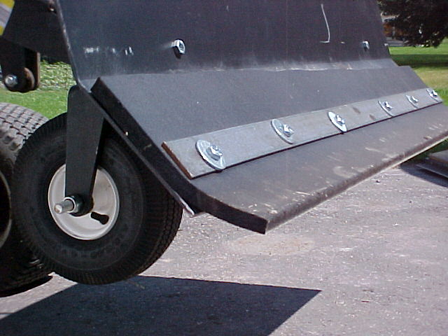

I bought the snow blade without the metal or rubber lip. I did go to a ranch supply store and bought a horse matt for 29 dollars that is 6 ft by 4 ft and 3/4 thick. Cut into strips and attached to the lip and now have a very strong rubber lib with extra when this one wears out. Works perfect for hard surface as well as on gravel.

A little more info on the horse mat please, maybe one of your great pics. Concerned with the method of fastening, I do not have the Snow Blade, but it sounds like the same idea would be beneficial on the Light Material Bucket for certain applications.

What did you use to cut the horse mat? Did you get the wheel kit for your snow blade? Do you remember the name of the store where you purchased the horse mat?

I bought the horse matt at the TSC store for $29. Cut it into strips 10 inches wide and fastend with carrage bolts on 60 inch by 2 inch 1/4 inch thick plate.
Has plenty of give when hitting solid object but solid enough to give good snow removal on gravel or hard surface.

I cut the horse matt with a saws-all. I will admit that it was not easy to cut even with it blocked down. My cut is not very even but it works and based on the amount of wear during the first year of operation will last many years. I purchased the horse matt a a store like TSC for $29.00. It was 6ft by 4ft by 3/4 think. Let me tell you that stuff is very heavy.
I did buy the wheel kit from PT and have not had any problems yet.

Thank-you for the information. The attached picture answered many additional questions. The horse mat was a great idea and it looks like it works well.
