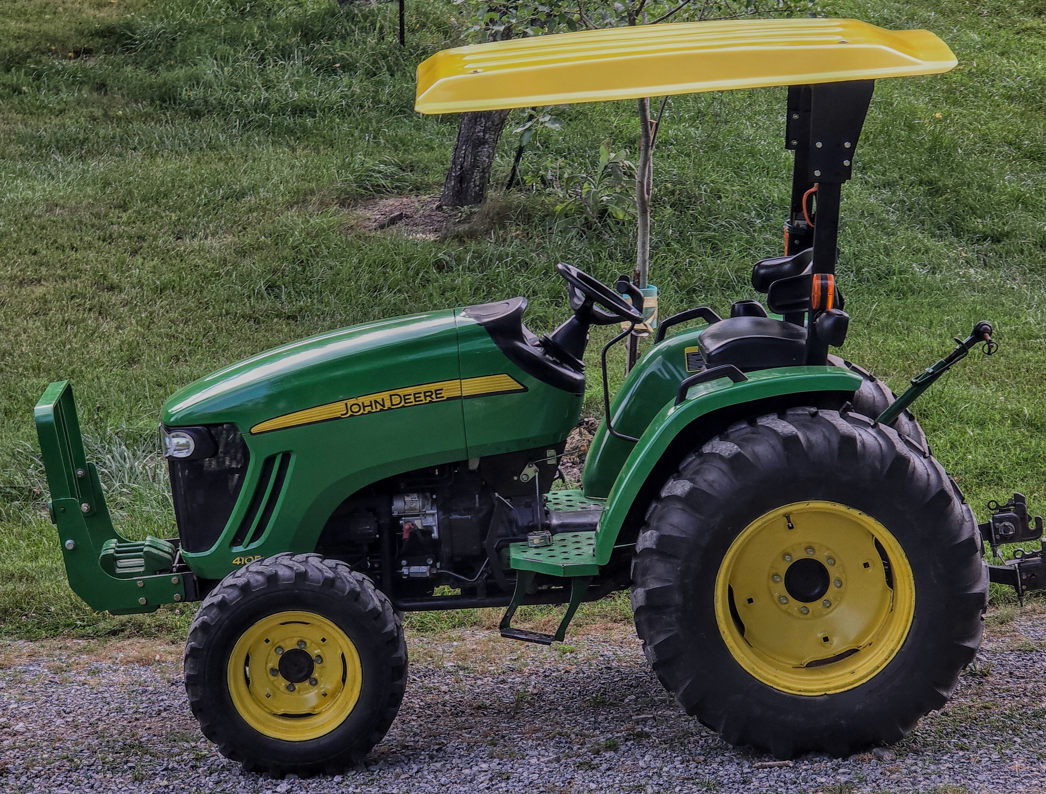

Are you looking for just a canopy or a cab? You really didn't say.

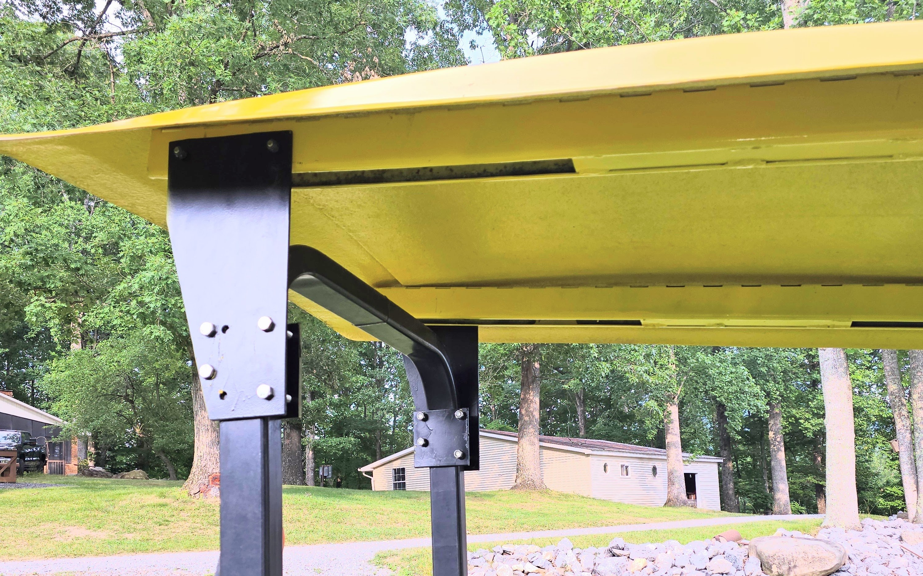

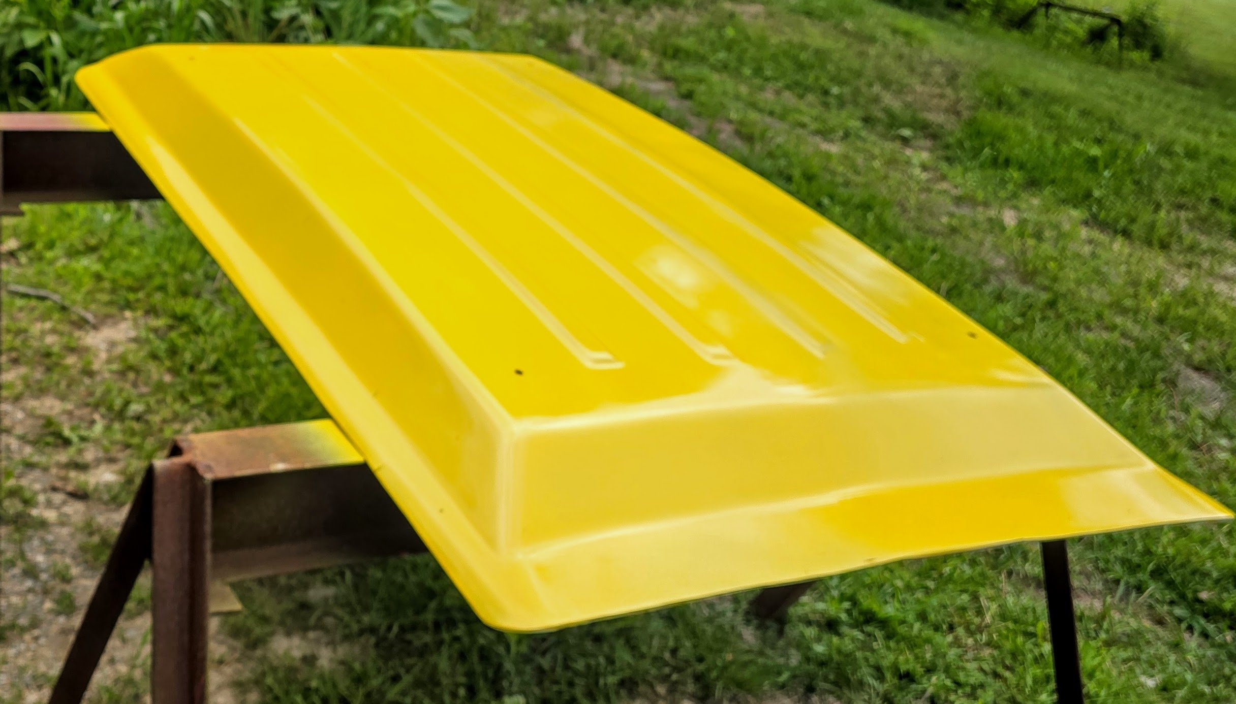

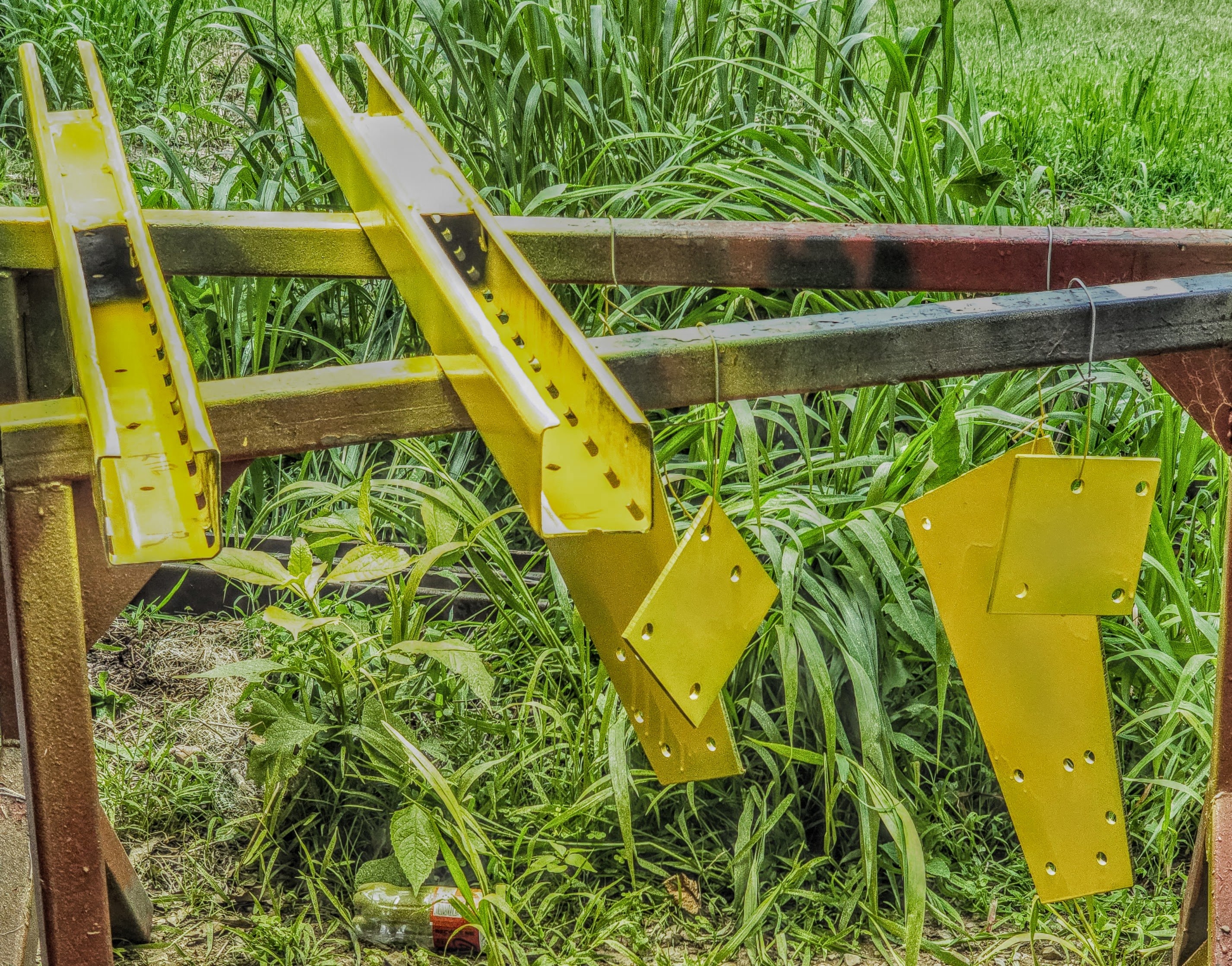

As for a canopy, if your tractor has a ROPS, then you can make your own for under $250. Basically it's a dumpster-lid cover with bracing. On the other tractor forum, this guy bought an HDPE plastic dumpster-lid on Amazon for $65, a few dollars for yellow paint for plastic, and made a few brackets to mount it.
Why pay over $600 shipped by an online retailer?
As for the soft CAB enclosures, for SCUT and CUT tractors, the Arnold snow blower canopy works too. These are sold at Menards for $99. If you buy 2, you can fabricate a soft cab for under $250 vs the on-line retail fo over $1,000.
This person took two of the $99 soft canopies and made this for their SCUT.
