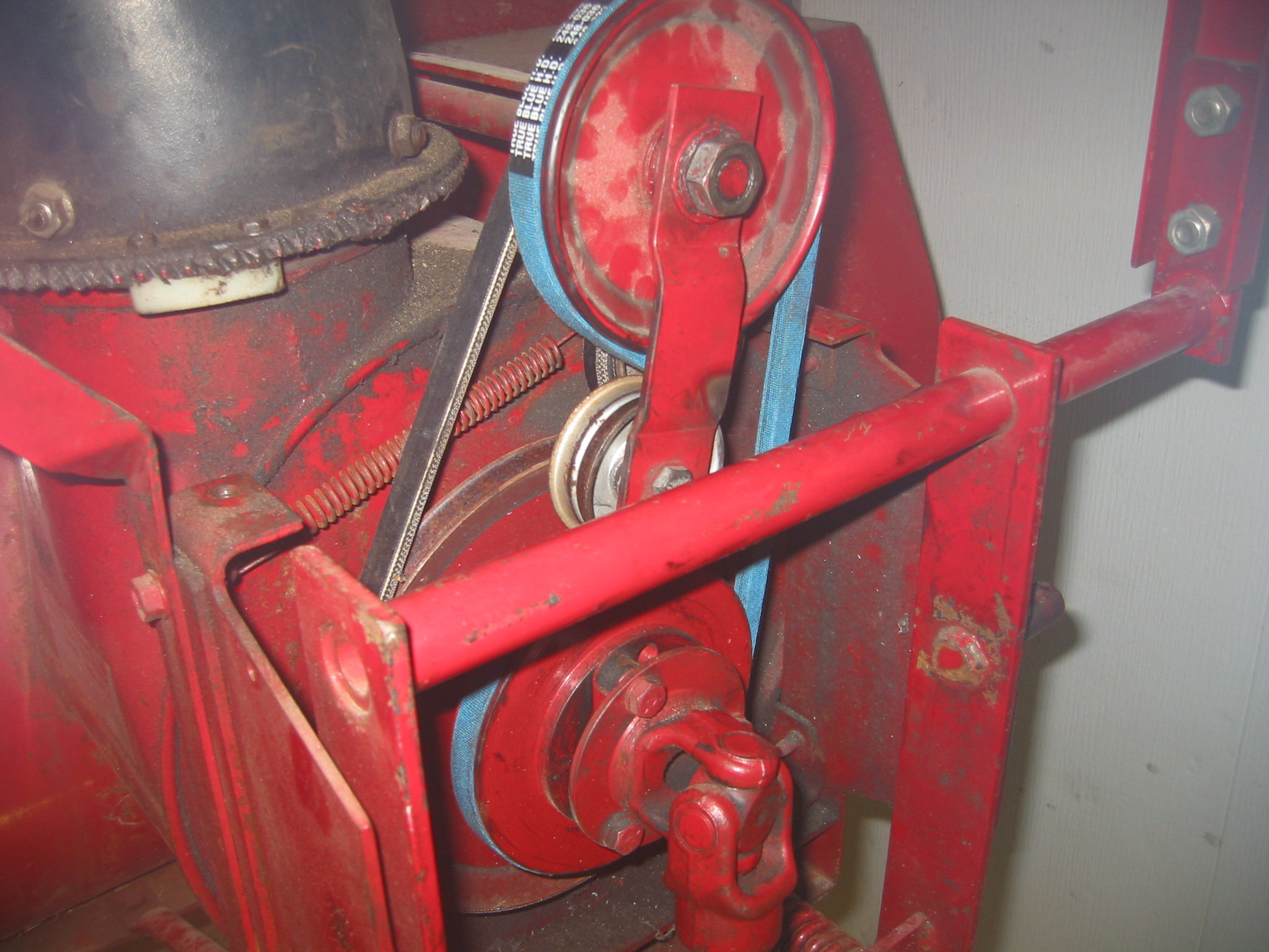

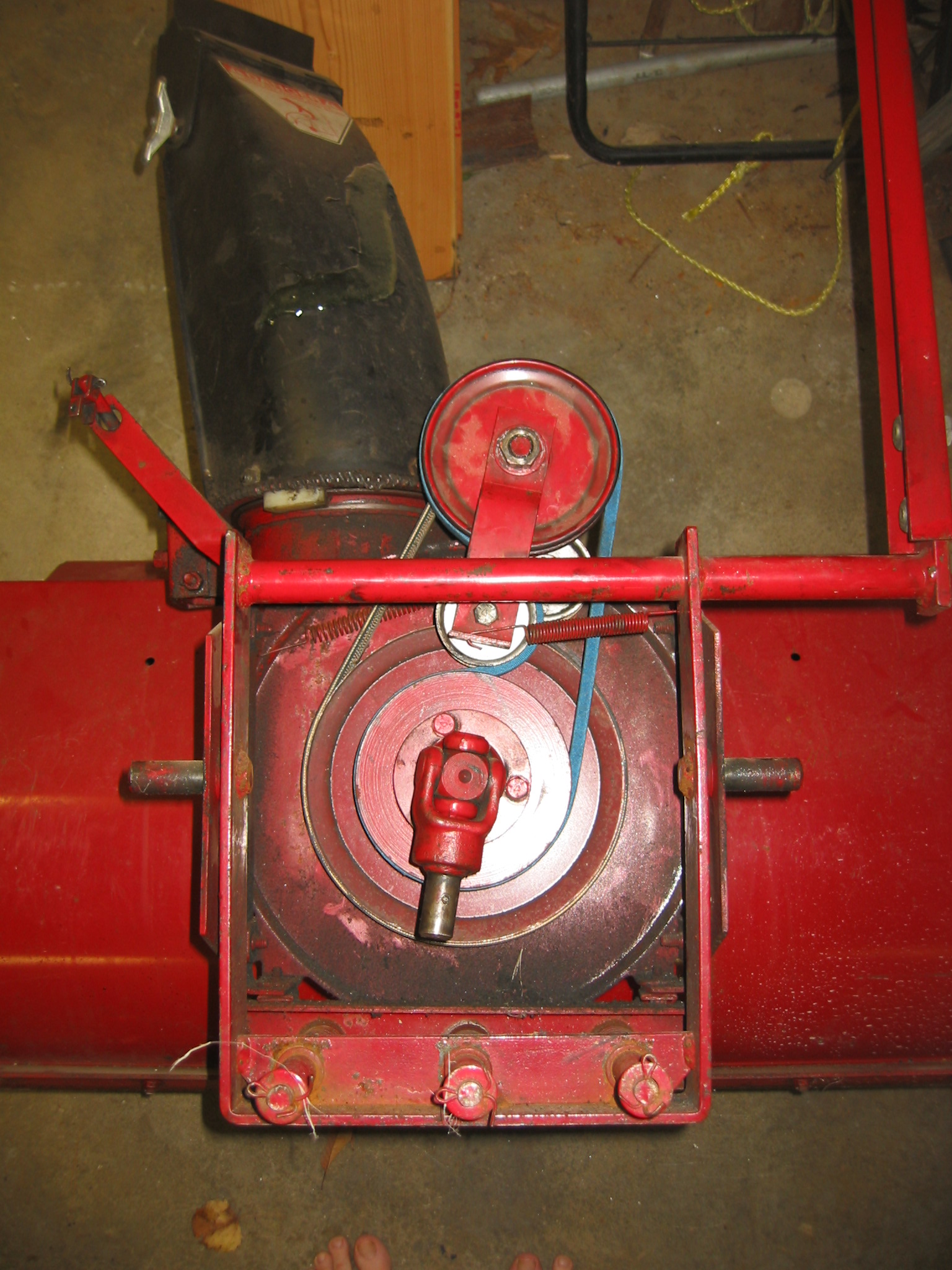

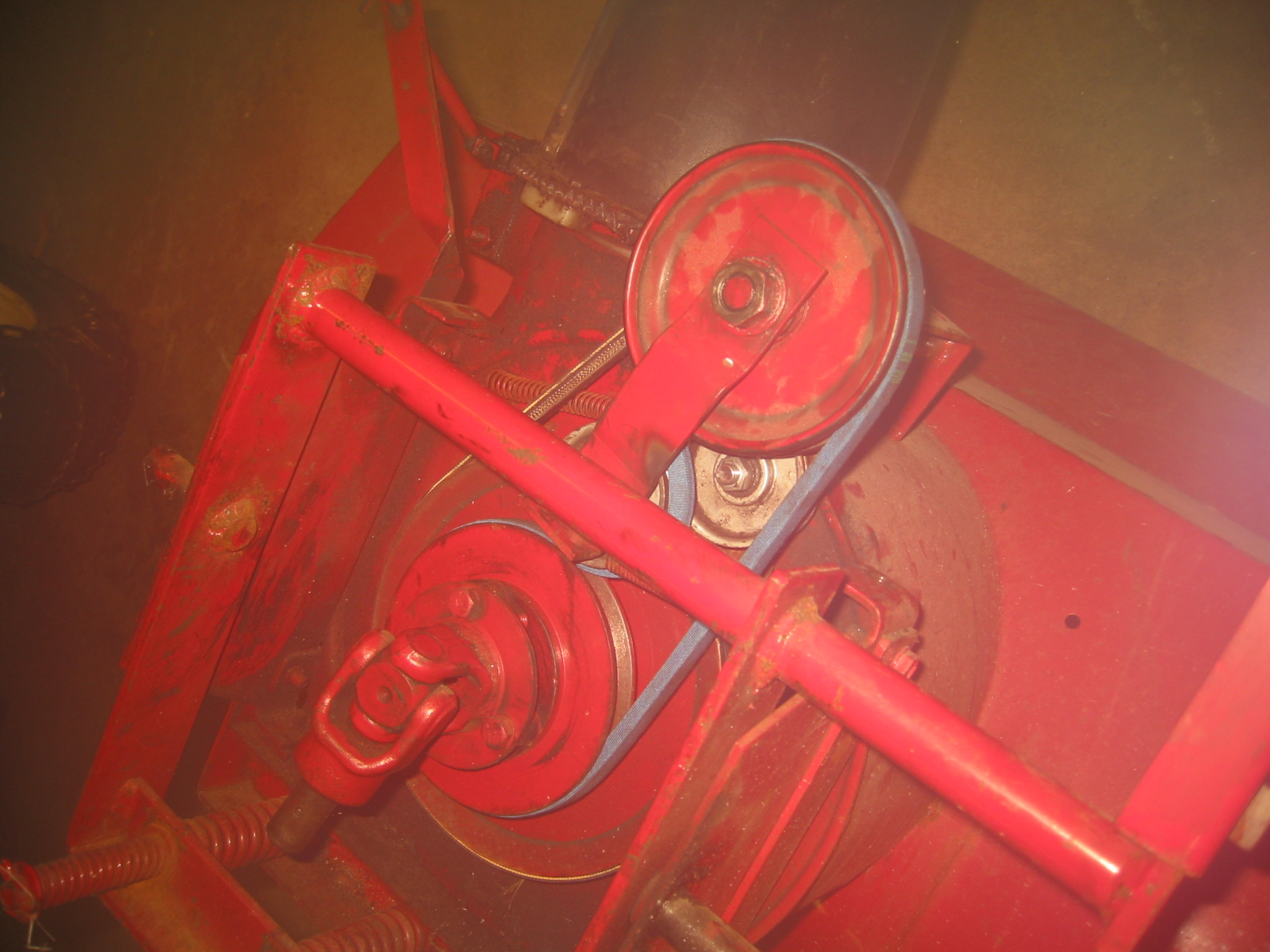

My 36" snowblower belts blew up at the end of last season - I finally put the new ones in yesterday, but had to guess at the routing and tensioner/spring placement (memory isn't that good) - it rolls OK, but something doesn't look quite right to me. I think it is the same as before, but I got it used last year, so who knows what a PO might have done. The tensioner spring on the big pulley has about twice the stretch as the one for the little pulley - seems weird as they are identical springs.
Anyhoo, if anyone is familiar with the Snapper blowers, please check out the attached pics and let me know if it looks correct. A link or manual page that shows correct routing would be great too.
Thanks much - JayC

Hi! By pics I think may be your new belt is too long. I dont know. Good luck! Oldmech

Thanks - appreciate it! ANd yes, the belts sure do look too long - but that is Snapper specification (assuming the shop sent me what I ordered). There is clearance everywhere, and the driven belt tension is on the straight sections, so maybe it is supposed to be that way, as crazy as it may sound.
JayC

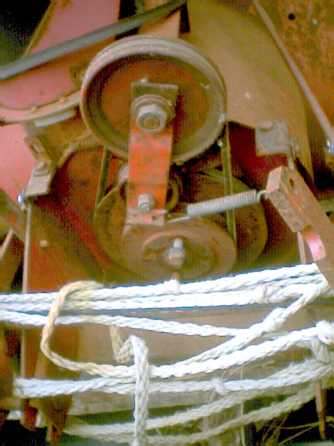

Sorry I didn't get back yesterday but we got home late. It does look like you have the routing correct and your photos are much better than mine, but here it is, hope you can see it.
Smiley
Smiley
Awesome! Thanks so much.
Alright then - I'm ready for the snow. Bring it on!!
JayC
