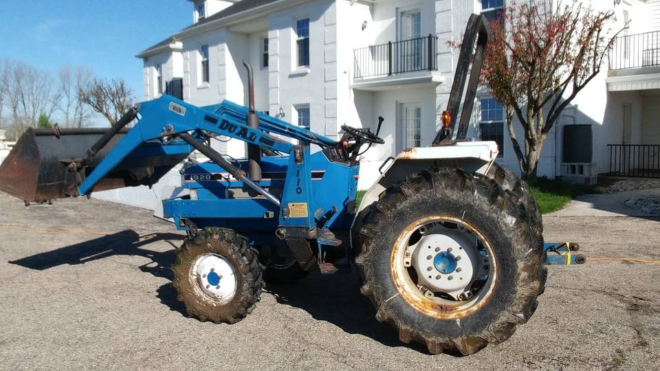

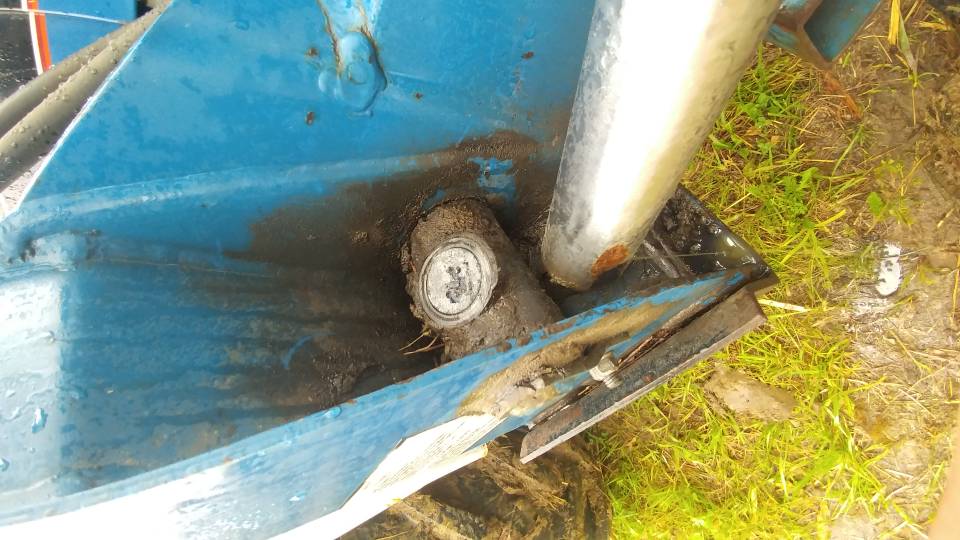

Anyone know anything about a Du-al 110? I snapped the piston when the Clevis pin snapped at full extension.
I can remove the cylinder but am hoping someone had schematics/parts list. Woods is of no help.
Thank you!

This is the main arm/lift cylinder. Not the bucket :(
I'll take some measurements, of course all of our local hydraulic shops are closed on Sat.

Should I take both off and have both rebuilt? I'm concerned if they reweld the length will not match the other side and cause binding or worse.
   / Snapped Loader Piston - Ford 1920 #10
Maybe I am missing something here but if the end just snapped off the rod why not remove both and with the cylinder fully extended weld the end back on.
