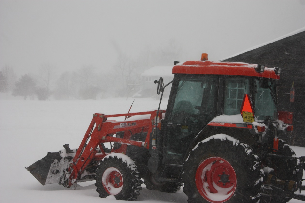

My DK-40 HST with Kioti BH-2485 seems to always jam the smv sign bracket against the back of the BH seat. Dealer says that is just the way it is?! It ends up bending the bracket and the toolbox gets crunched too. What is up with this design?
Anyone have a reasonable way to make it all fit together without anything getting bent up?

You can buy a bracket and mount it to one of the ROPS mounting bolts.

its a flaw with my dk45SE HST cab model also. the SMV sign is in the way of the top link and the remote hoses. so i had to remove it.
i have hazard lights on the back, so oh well. I wonder if maybe the smv sign is added in the USA when the tractor is prepped. I noticed that the sign has a US manufactures label on it.
i honestly looked for another place to mount it...but couldn't come up with one. it fits in my desk drawer nicely though:laughing:

My KB2485 has a SMV bracket on the bucket arm. It's a wedge fit that allows one to easily remove the sign when using the BH. There's a thingy that bolts to the sign that lets you plunk it in the bracket.
There's also a SMV sign on the LR wheel arch (cab model like the one pictured in Lloyd_E's post) so the one for the BH wasn't with the tractor when I got it. I bet a good dealer could look up the parts. The tractor is a 2006 model.
