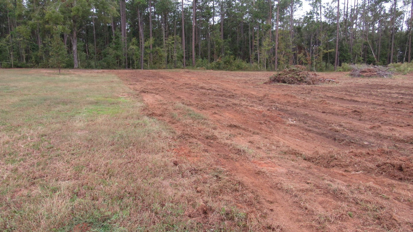

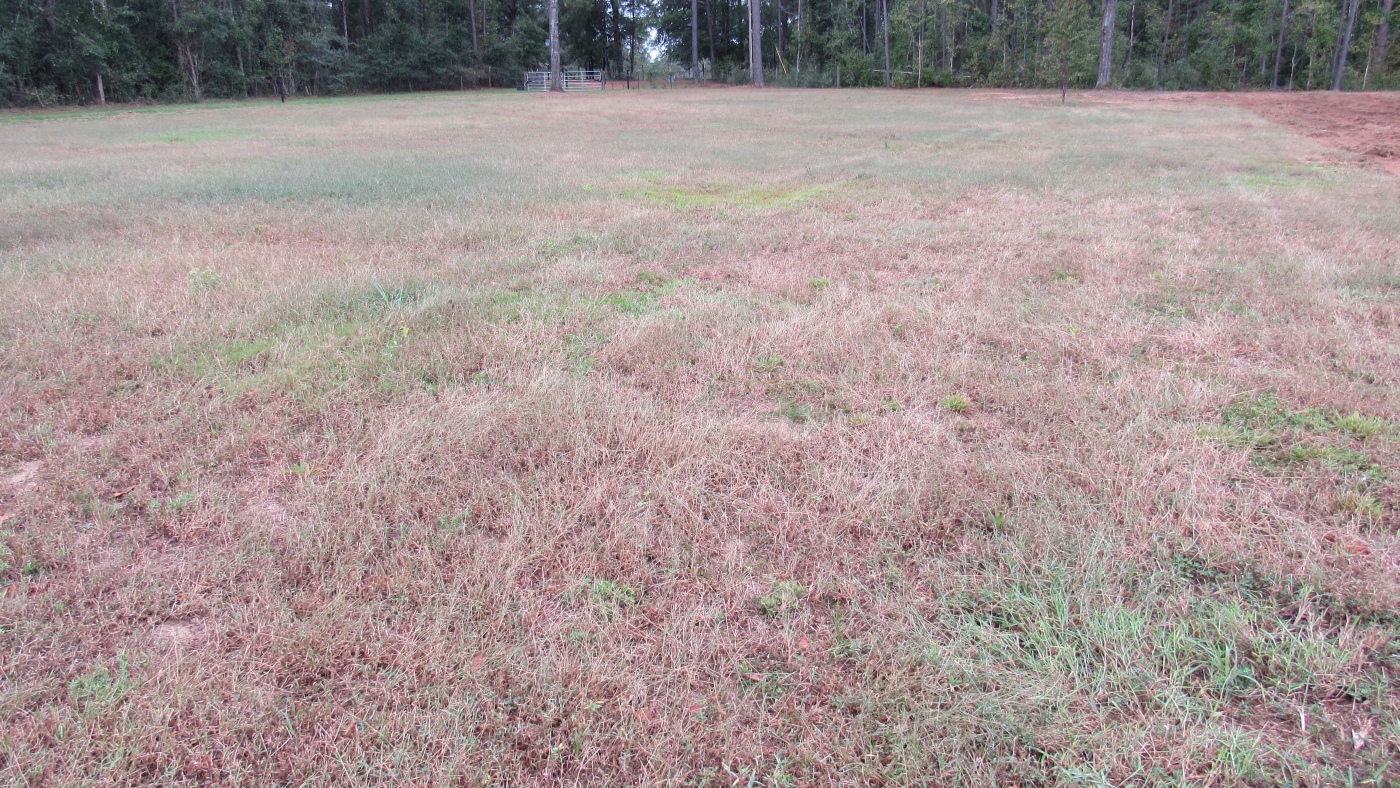

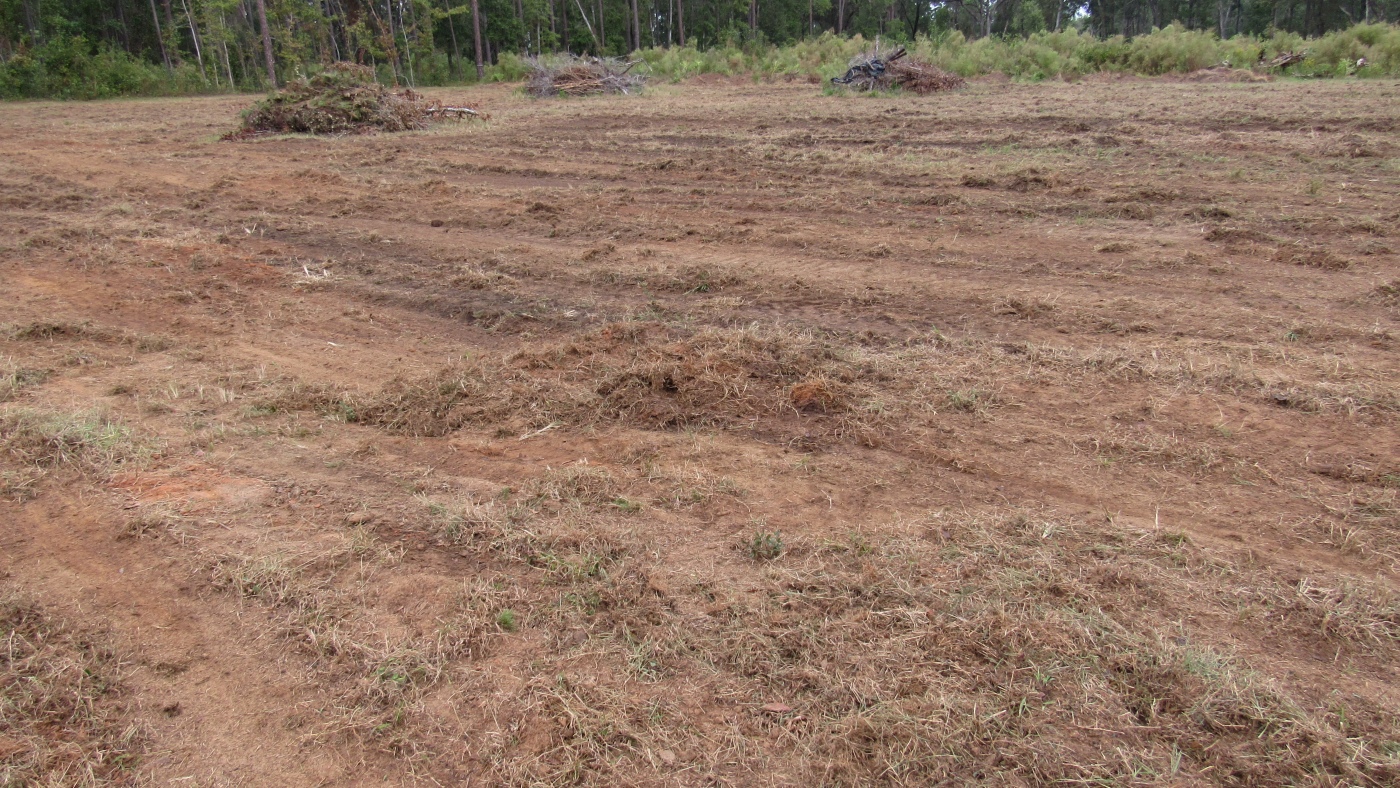

Trying to smooth out a field I neglected to work while it was still dirt. I got half of it decent with the landscape rake before I allowed the grass to start growing but the other half had a lot of irregular areas and low spots. Now that the grass has grown up it is difficult to work out. I cut in in both directions with the disc harrows but then when I try to rake or smooth the grass bunches up and prevents in resemblance of smooth.
The grass is dying back and I want to smooth it out and plant a winter mix for the deer and critters.
Do I just need to let the grass I cut up die out and keep working it or is there a better way to level with the grass clumps in play?
Here is a photo of the better side with the grass on it.
These next two photos are of the field after I attempted to cut and smooth it.

I think a Three Point Hitch mounted, framed Chain Harrow would be the best tool.
The Chain Harrow will accumulate all those grass tufts in the mat, so you need a framed/lift model so the tractor can shake out the accumulated grass tufts from the chain mat off the field.
Once the tufts are removed you can select the most abrasive adjustment of the chain harrow and drag. Chain Harrow should have minimal effect on pasture grass roots if grass is well established. You will not need to drag in any pattern, just from high areas toward low areas, the chain harrow will fill low areas.

Do you want to keep the grass? If so, top-dressing and rolling are the options. Grass will level itself somewhat over time with regular mowing but it's a slow process.

Like you already discovered, raking doesn't provide good results. I have found chain harrows does a better job under dry conditions, but still lose sod balls up between the rows of teeth.
If it's not too stoney, go over it with a brush hog set as low as practical. That will break up and disperse almost all the clumps.

I was thinking of a chain drag. Never used one. Not concerned about the grass growing back. This was just dirt a year ago. Mostly want to clear the grass so I can smooth out the dirt.

I meant to mention what I have available. I don't really want to go buying new tools for this project if I don't have to.
I have a disc harrow, grader blade, finish mower, brush mower, and a landscape rake with tail wheels.
I have some old fence and posts I might try to make adrag with. My neighbor may have a chain drag I can use. They are always offering to loan equipment but I'm not going to borrow anything that might tear up.
We are getting some rain right now. I might try running over it with the brush mower and follow up with the disc harrow again. If I can get it to dirt I can smooth it out with my landscape rake.
