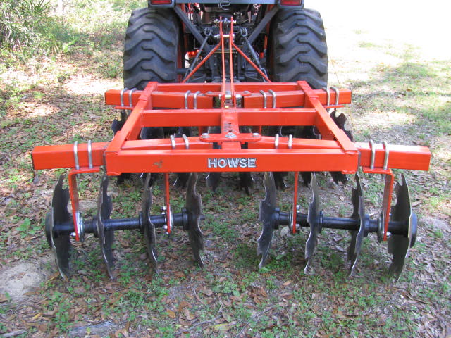

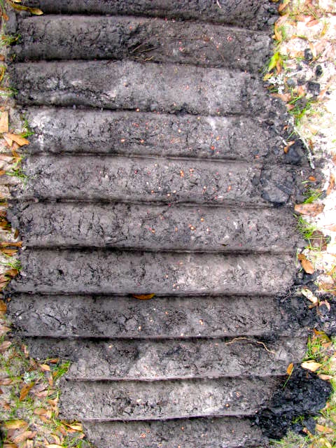

Notched discs will CUT and chop crop stubble and grass. Smooth discs are somewhat better for SMOOTHING minimally vegetated fields. Smooth discs have a a tendency to roll over vegetation that notched discs will penetrate. For Food Plots, unless you have a lot of rocks in your food plot soil, go with notched front, notched rear. If you get a disc with 50-60 pounds bearing on each disc you could go with notched front, smooth rear.
Generally speaking you want a minimum of 40 pounds harrow weight bearing on each disc. For opening 20 acres of food plots, 50-60 pounds per disk will open ground for seeding in one pass. After seeding you need to cover or roll in the seed. ( In a field you can disc more than once at a 45 degree angle across first pass, in a food plot a second pass is rarely practical.)
Disc diameter and concavity influence total harrow weight, how far soil is thrown out and in, and how deep disc can sink on successive passes. I recommend 20" or 22" disc diameter on 1-1/8" axles, not 18", for your 4,000 pound tractor.
You could pull a 7' to 7'-6" disc harrow with 20" disc diameter in a field with no strain. But for food plots, where you will be maneuvering between trees and boulders and working on slopes, buy a disc 5' to 5'-6" in width. Anything wider and the tractor will pass through gaps but the disc will "hang up" and you will waste a lot of time extricating tractor+harrow combination.
You need minimum of 5-horsepower per foot of disc width plus four wheel drive. Your Kioti has plenty of horsepower plus ample weight at 4,000 pounds.
You probably want a disc harrow with 9" spacing between the pans, rather than 7" spacing. Wider spacing will have less "float" and therefore cut better. Also, a little easier to clear vines from axles with wider spacing. (That said, EverythingAttachments.com offers interesting, HEAVY 20"-22"-24" Disc Harrows with 7" spacing.)

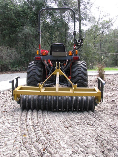

Consider the purchase of a CULTIPACKER to roll in your seed and help prevent erosion. Rolling twenty acres a CULTIPACKER will improve seed germination enough to pay for itself over five years.
