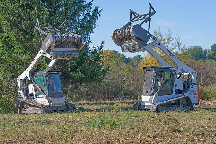

Rent one of these
you won't go back to anything else
