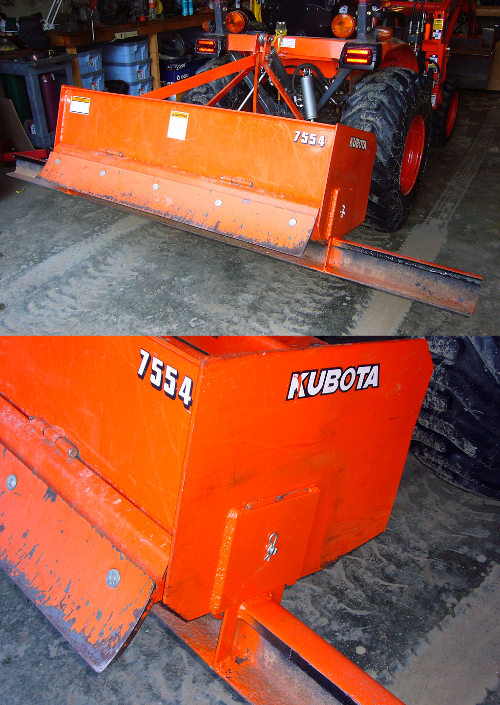

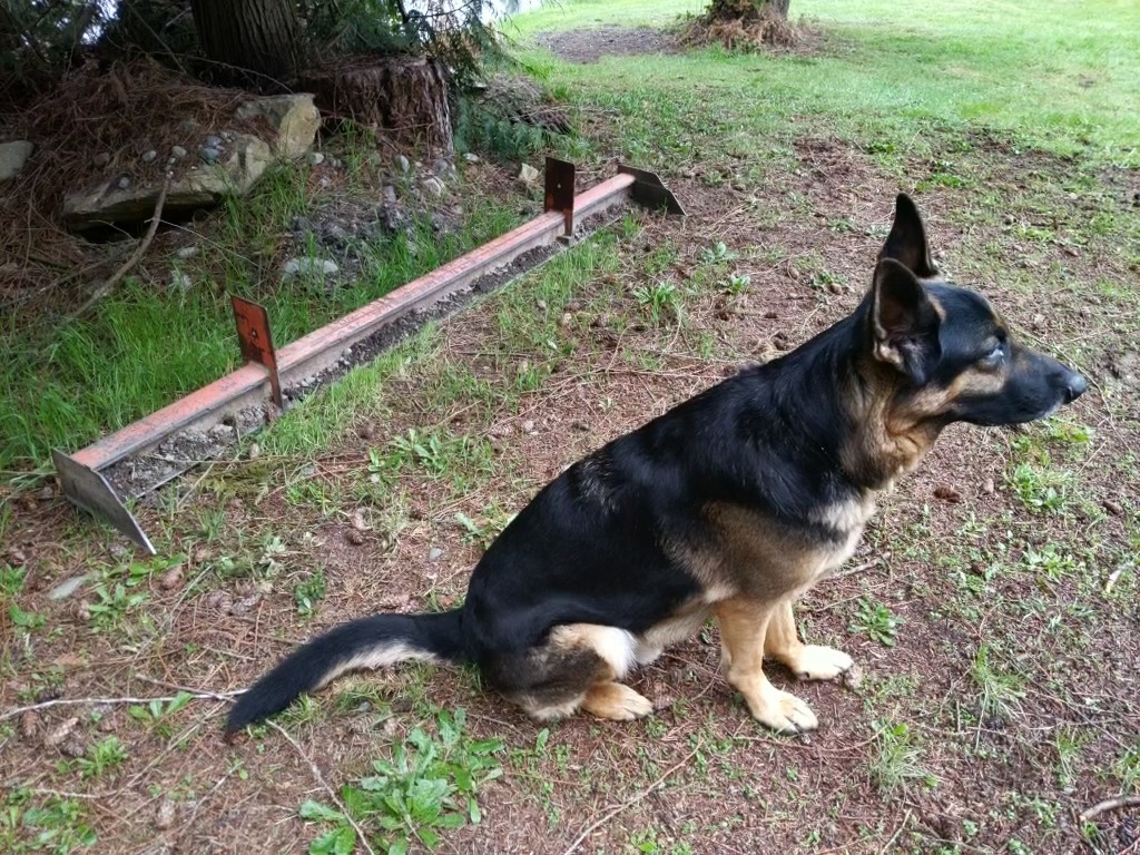

Click here and scroll to the bottom for pics of an 8 foot 200 pound rail attached to the bottom of a 370 pound box scraper. I really works!

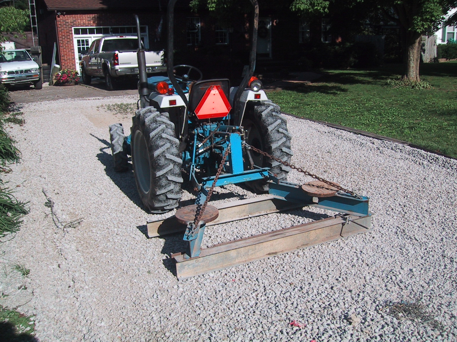

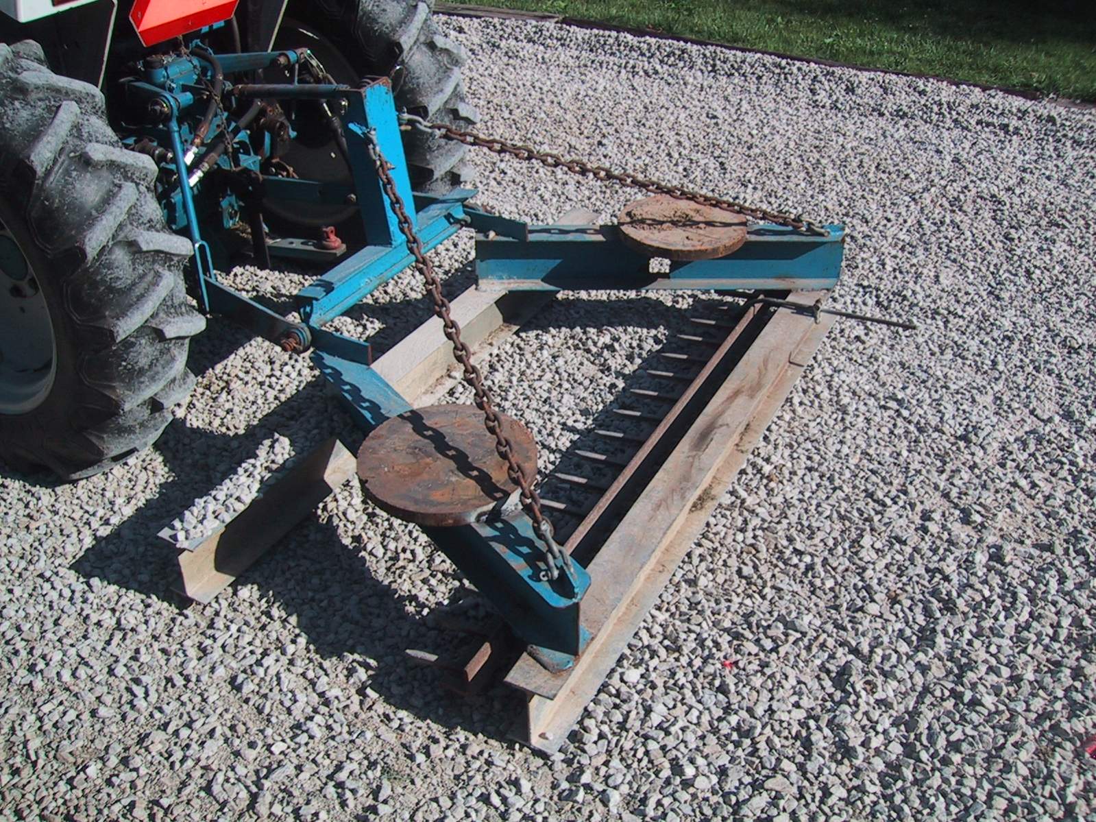

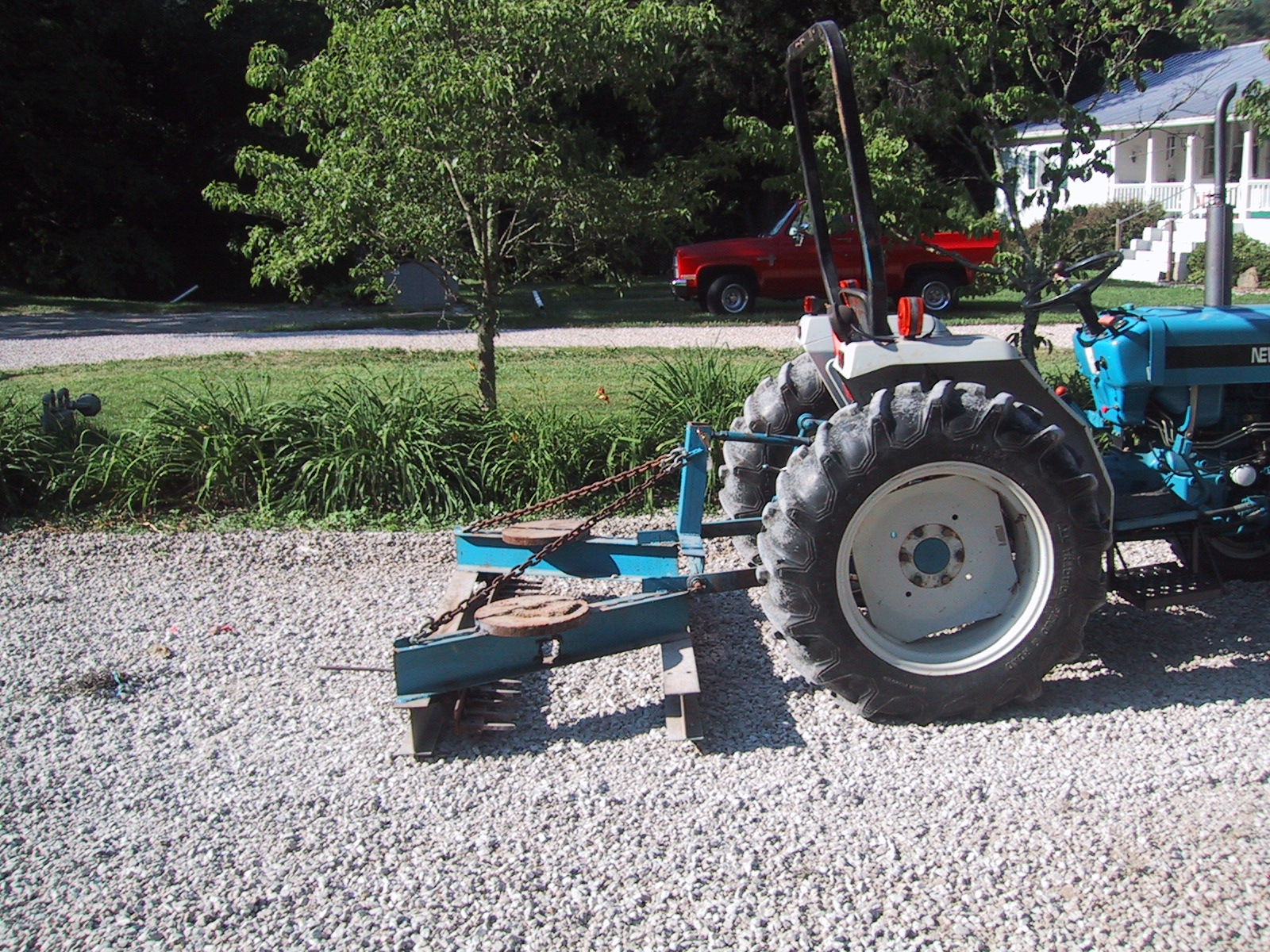

   / Smooth and level gravel driveways... #3
I use a homebrew grader , Made from guard rail post given to me by a friend.

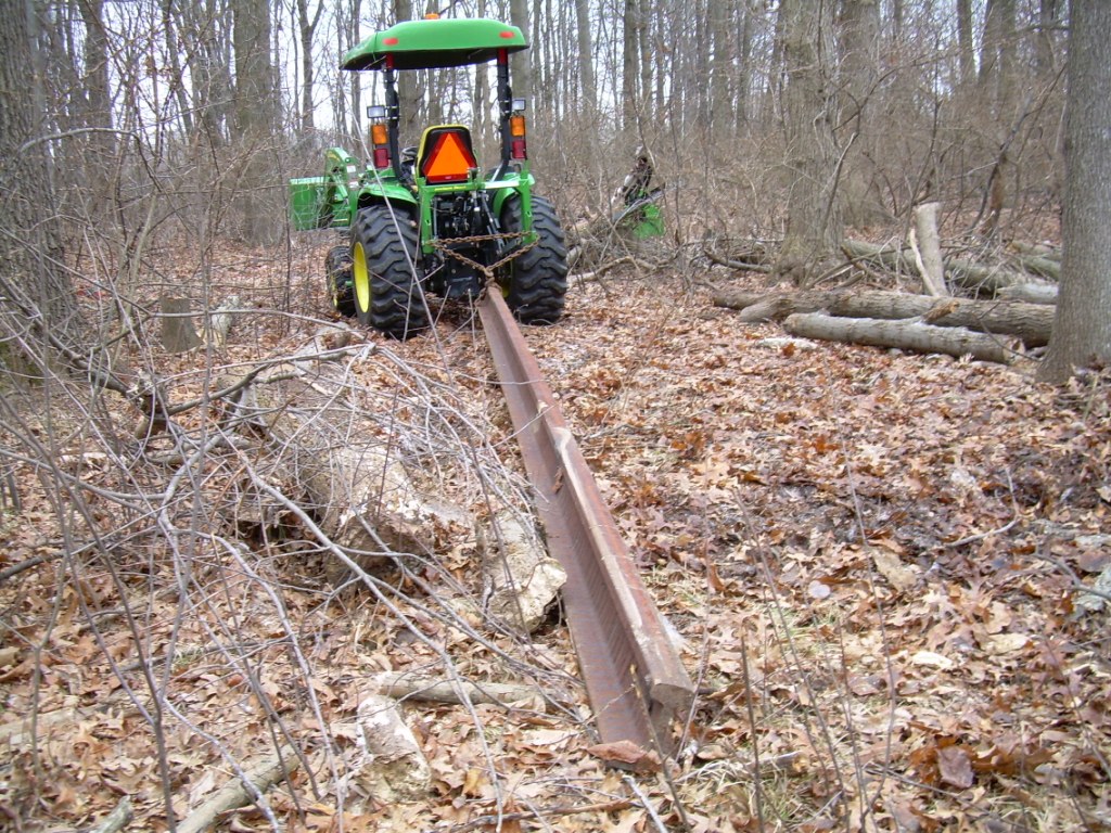

   / Smooth and level gravel driveways... #5
All sound like good ideas, I've got a ~20' pc of heavy rail waiting to be put to good use.
JB.

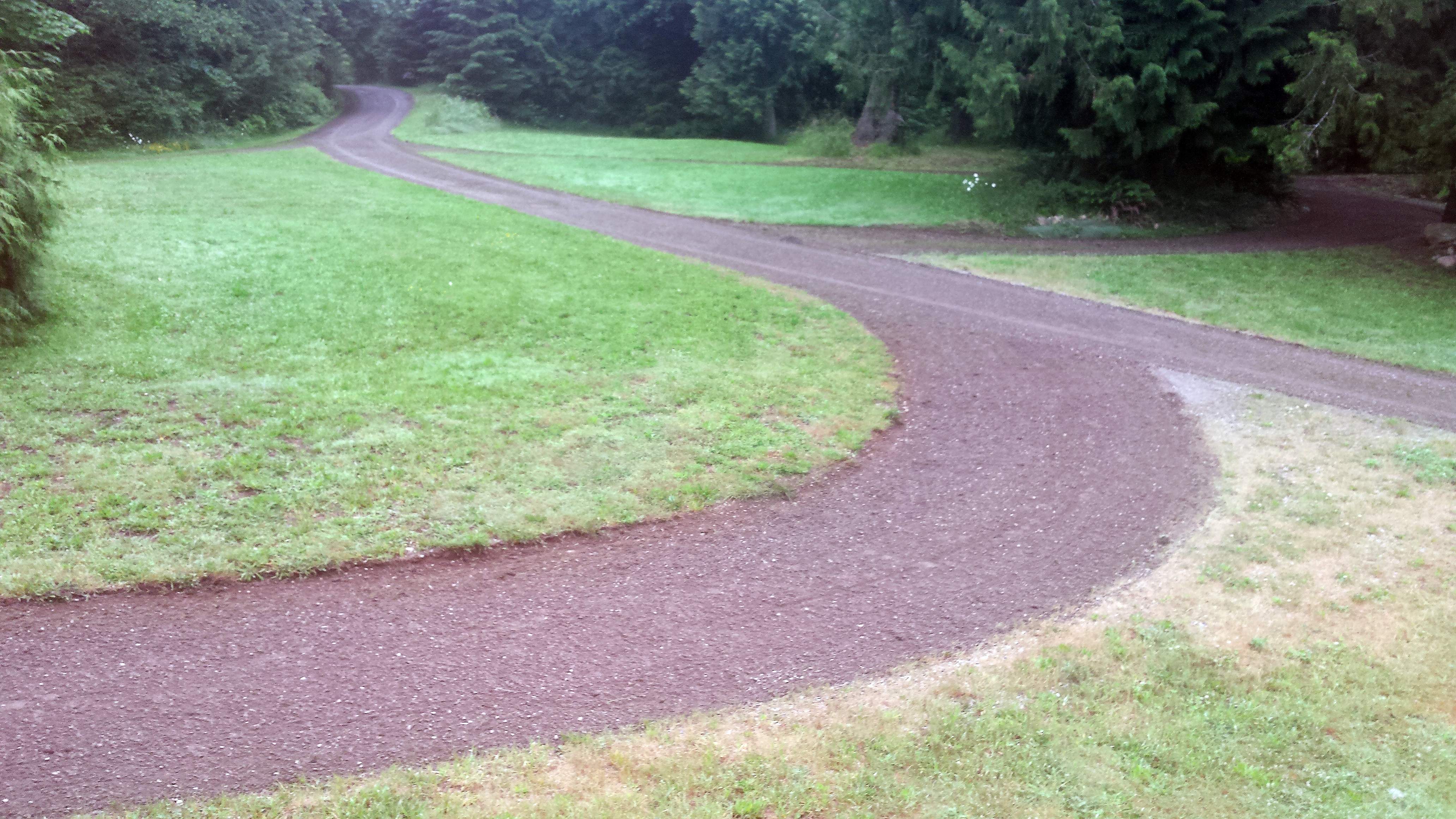

The OP link is broken so here are a few pics ...
   / Smooth and level gravel driveways... #7
Wow. Your roads look nice!!
The rail weighs 200 lbs added to the 400 lb box scraper. I have since added end plates to the rail to control spillage over the ends of the rail that tends to create brems at the edge of the driveways.

I have two RR tracks welded together into a frame. Ruined a perfectly good Plasma Tip burning shackle holes in the track.
The only problem with perpendicular anything, is that it ejects material out the sides, and off your driveway.
