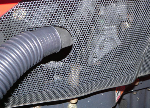

MF 1532, Kubota B-26 TLB
There have been other threads here on venting tractor exhaust outside of a garage, and several good solutions. For me however, I didn't need an expensive or permanent system for prolonged inside running. I only wanted to route the exhaust outside for just the few minutes at startup, when the engine pumps smoke. My solution was to use a piece of 1 1/2" flex sewer pipe ($10 at HD) which happens to fit snugly around the engine exhaust. The length is only about 10' so back pressure is not a problem, and I remove the plastic pipe in less than 1 minute so heat is also not an issue. It works great for that first 30 seconds or so when a cold engine makes smoke. Solved my smoke detector problem too and it coils up out of the way when not in use. Just don't start her up and go to Denny's for coffee as prolonged use will melt the plastic. /forums/images/graemlins/shocked.gif

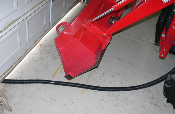

Pic-2 routed under the roll up door.

Beyond the wife thing, it's back to the smoke detector. That first puff of smoke at startup was enough to set mine off even with doors open. Even when I pulled directly out after start up. That's why I went with a heat detector in place of the smokie (see this thread). I still have the smell to contend with and the pipe idea sounds like just the ticket. Anyone doing it with vertical exhaust stack?
