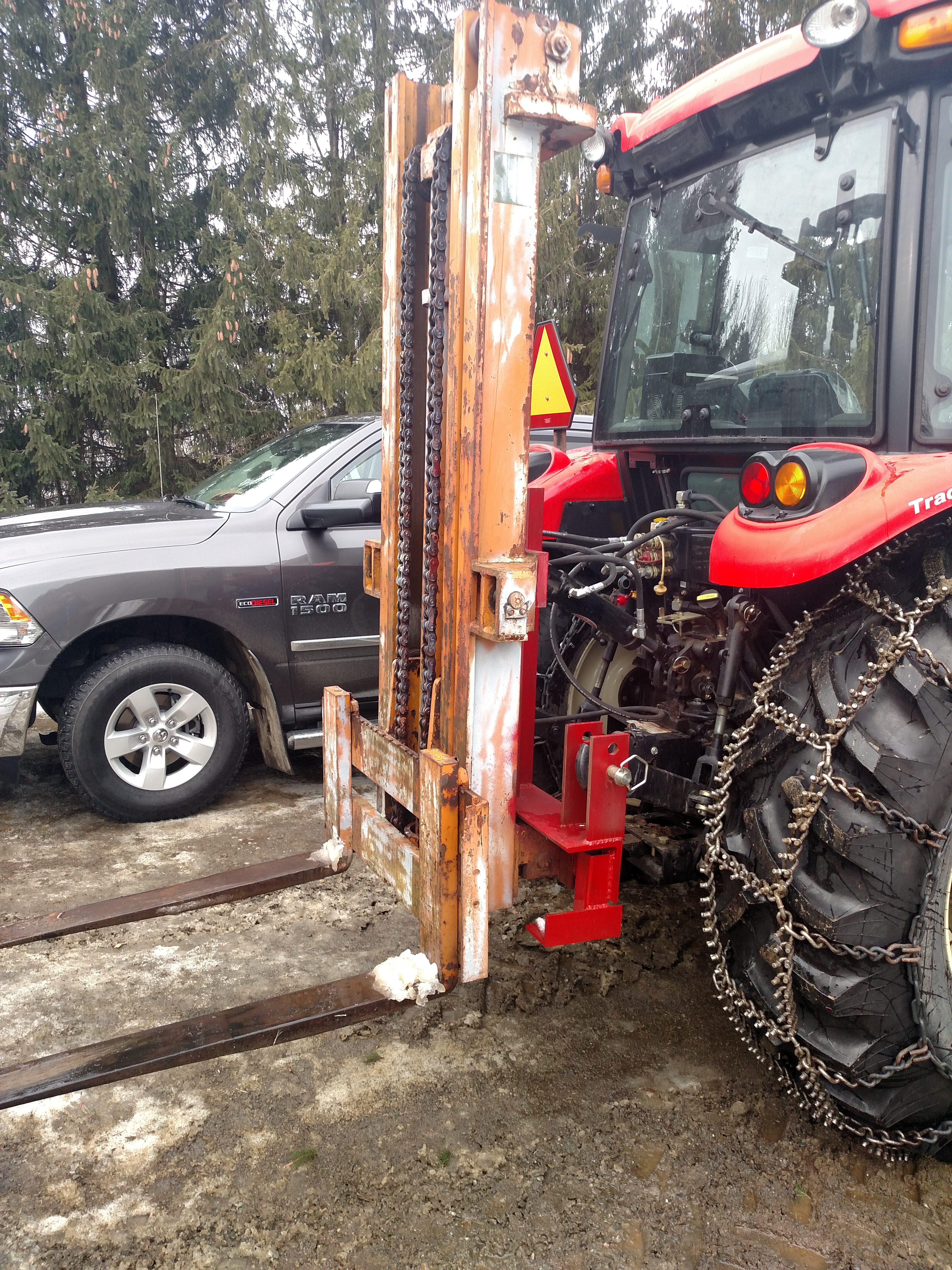

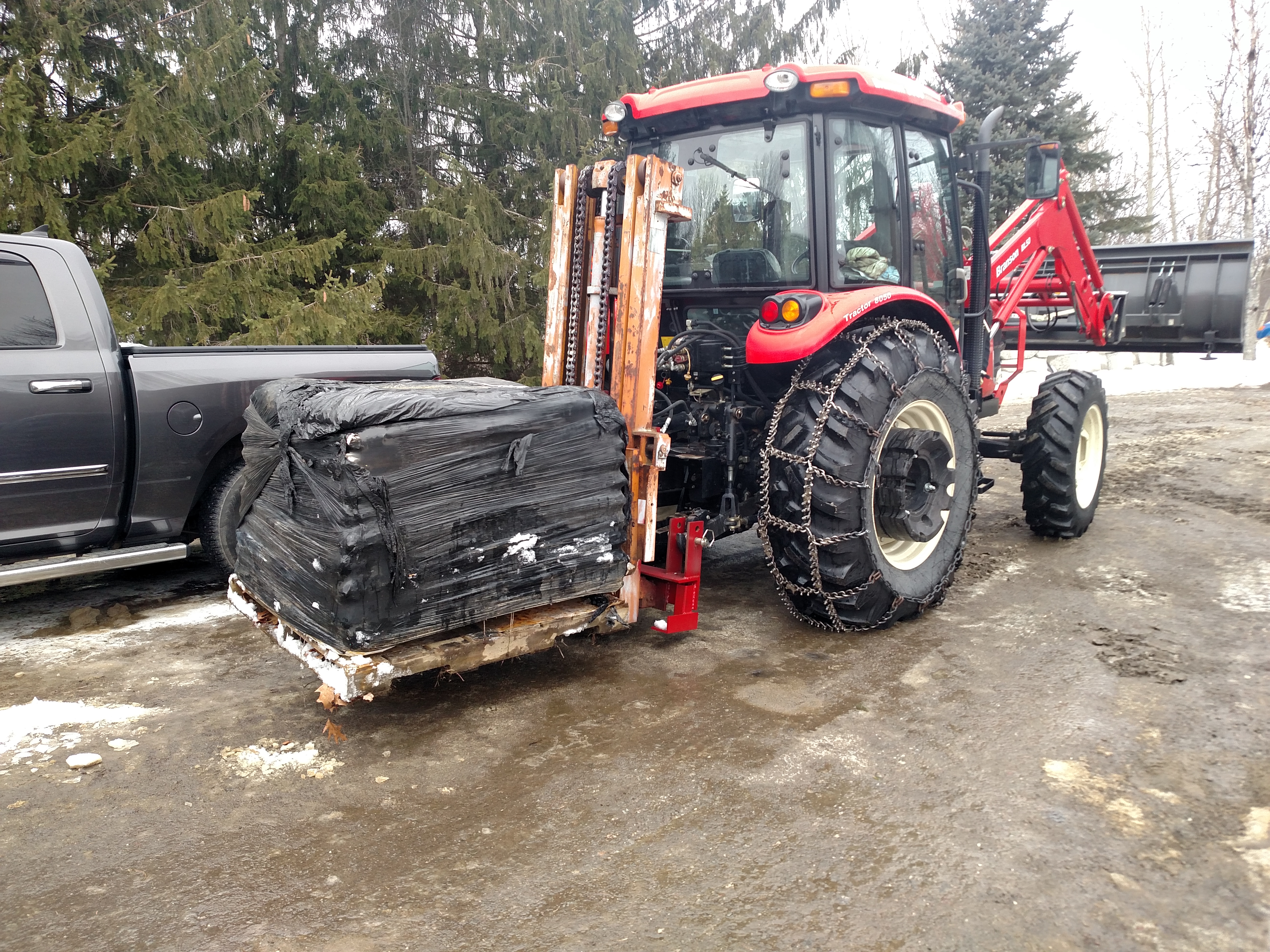

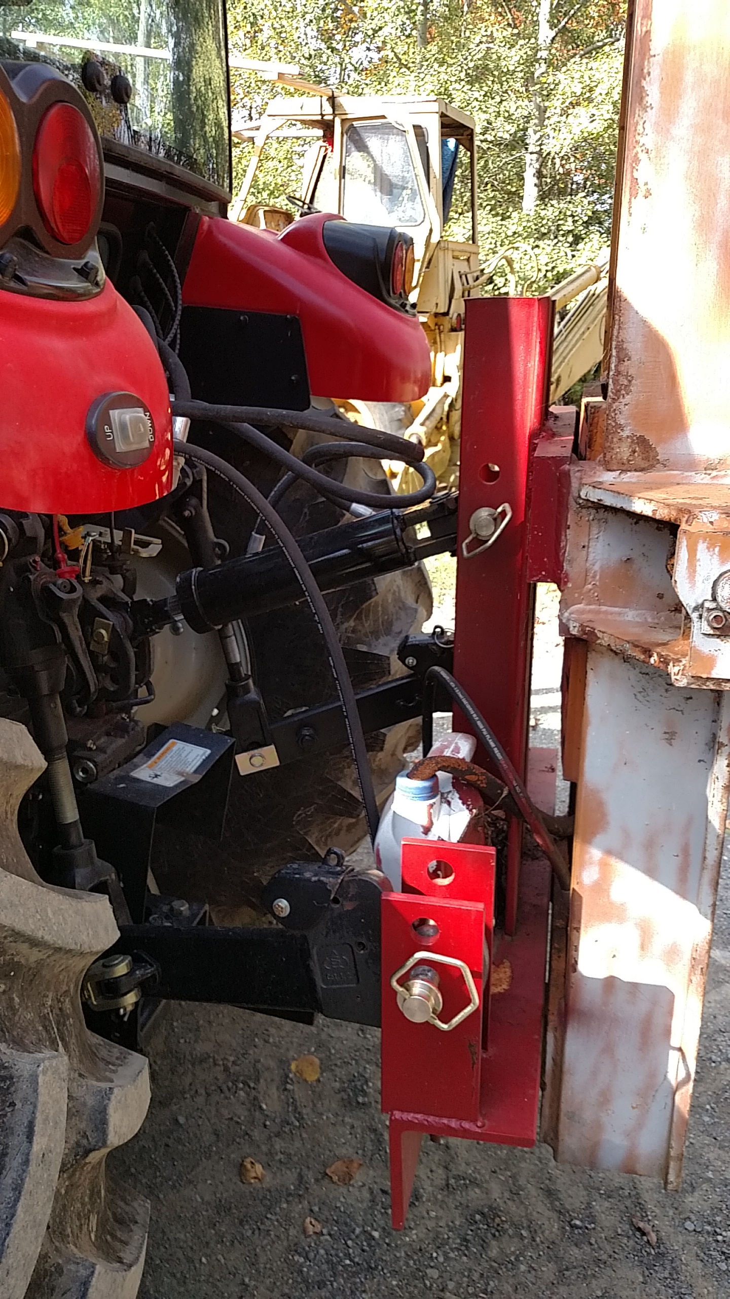

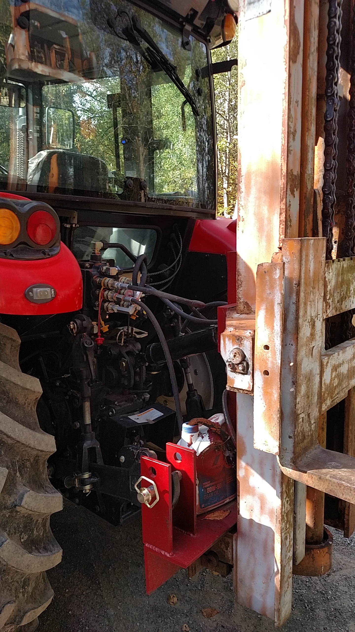

My 3 point fork lift is from an old mast and I use it on both my tractors which are open center and it's been used at the farm and all but 3 of those are open center hydraulic.
I use a hydraulic toplink to tilt the forks running that off of one of my remotes, I run the mast off another remote and I can use the 3 point if needed as I'm usually only running one cylinder at a time. On my loader on the open center system if I'm trying to curl and lift at the same time I can do so by just feathering the joystick for what I want to do.
