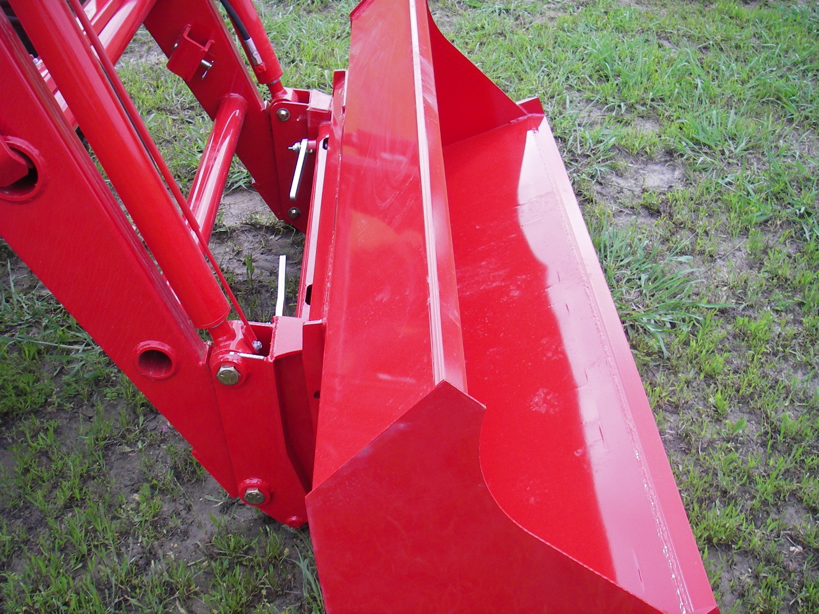

Looking for smallest Skid Steer bucket I can find for my Mahindra 6500 4WD ML265 loader. The loader is made by KMW Loaders for Mahindra. Anybody know of a KMW or aftermarket bucket that will fit? I suspect 48 " is maybe smallest that will fit due to support arms but would look at any size smaller than the stock 78" wide bucket.
Attached is picture of my Loader.

I have a set of SSQA forks from SkidSteerSolutions.com out of Bellingham, WA. They have a tractor section and may have what your looking for. On my 5530 I have the ML266, you have a special application for the smaller size bucket?

I think about a 54" would be the smallest made for the skid-steer connect system. Any smaller would be a different connection system. Many dealers have take-off skc buckets, because when a guy buys a tractor with a 4-n-1 a dealer will generate an extra bucket. I think I have a 60" and a 67" in stock and I bet you have a local dealer that has some as well. Or check a Bobcat dealer or any dealer that sells skid steers of any brand. Rental companies sell off old buckets as well, like United Rentals. The nice thing is that you have a standard connection system so you are not forced to shop only one brand.
I've never had anyone ask for a smaller bucket....what's up?

Well that makes sense, you are using it as a digging bucket. Might be good to get one with teeth on it as well. I bet you can get a half worn out skid steer bucket at a rental yard. 60" should be easy to find, much smaller might be tough. It would not be hard to narrow a bucket down with a plasma cutter, just make it the width of your loader arms plus an inch or two. Cool idea. Do remember to be careful when you turn a loader (meant to pick up loose soil and such) into a digger or dozer.

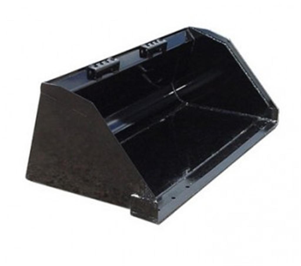

48" is the smallest I have seen, the SSQA is 44" wide, so that would be the minimum unless you go to a stump bucket.
48" Utility Skid Steer Bucket

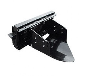

Since you are planting trees, check this out.
24 Inch Tree Scoop
