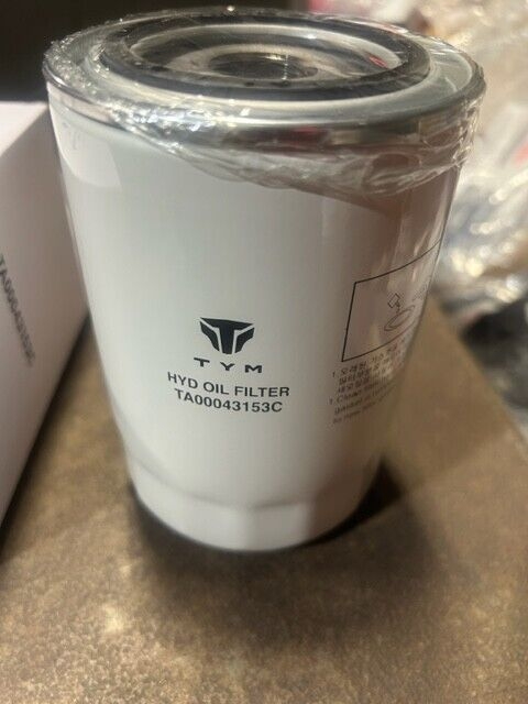

When do you replace the smaller hydraulic filter?
I know the oil and hydro-static filter get replaced at 50 hours, but I can't find any info on the smaller filter.
In my case the filter in questions is TA00043153C.

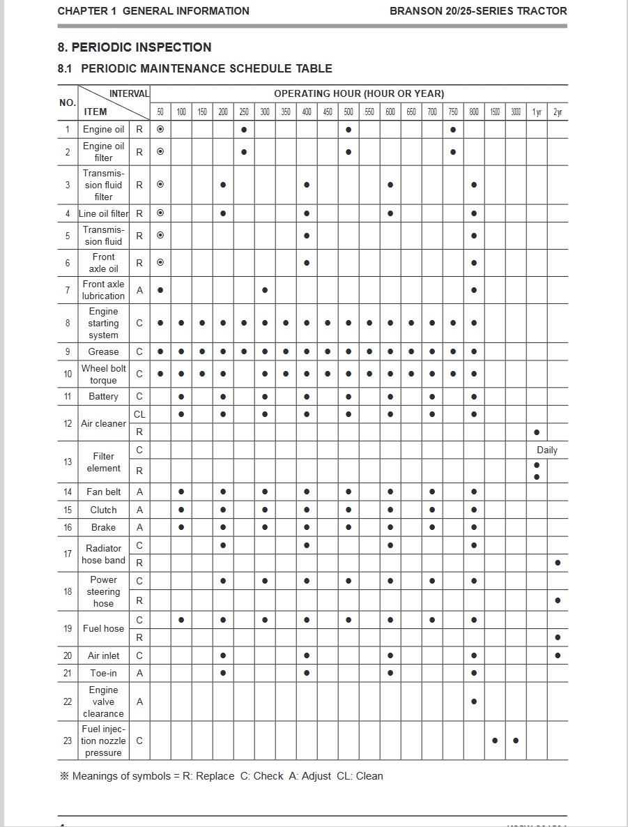

   / Smaller hydraulic filter #2
New tractor 50 hours I replaced all the hyd filters.. Then at 250 hours the small hst hyd filter, 450 hours the large hyd filter on my l3800 Kubota ..
   / Smaller hydraulic filter #3
All filters, all fluids at 50 hrs.
Then I was aiming for 300 hrs for all fluids and filters again, but went over this time by nearly 100 hrs. Didn't really intend to, but "life" hit me with a brick this year. Not trying to encourage such things, but in my case, nothing went "boom". All fluids looked brand new (except engine oil-which was still "clean looking") and peering into any of the old filters looked clean and debris free (including the bottom of my fuel separator).

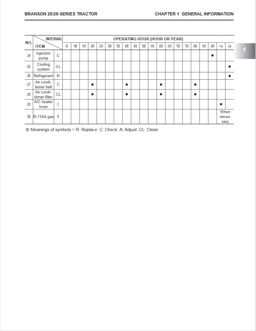

Was just wondering, as I can't find the small hydraulic filter being mentioned anywhere in the manual.
