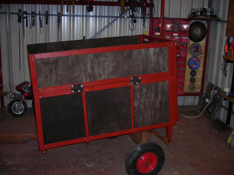

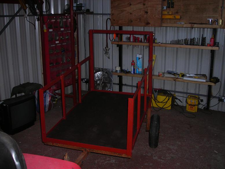

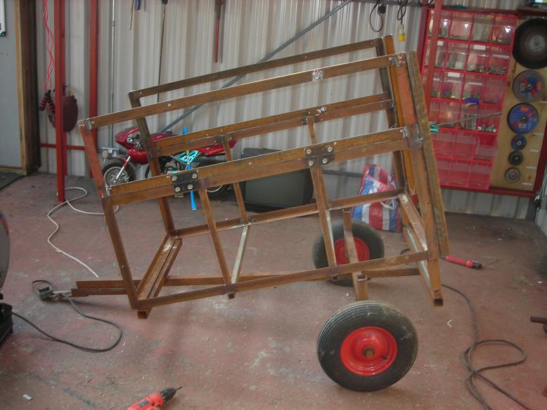

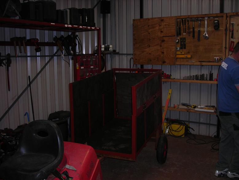

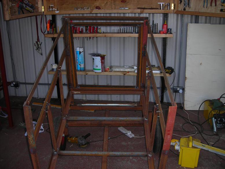

i went ahead and built the body for the trailer. Here are some pics of the building and end of the job. I still have to add a mechanical tipping mechanism and change the material of the back door to something that will allow air but not grass to go through it. some early testing showed that while it gathered the grass it was being blown back out by the air coming from the mower. When i am happy that the trailer wil work i can go ahead and get the tipping mechanism done and at least i will have a realistic weight to work out my working pressures

I think your on the right track with your trailer. Expanded metal or some screen over a cutout in the back of your trailer should work for letting air out. Are you going to put a tarp or something on the top? The duty cycle of pump motor will probably work for your small trailer. They have some on larger equipment trailers over here that work on same principal, power up, weight/gravity down. Good luck.
