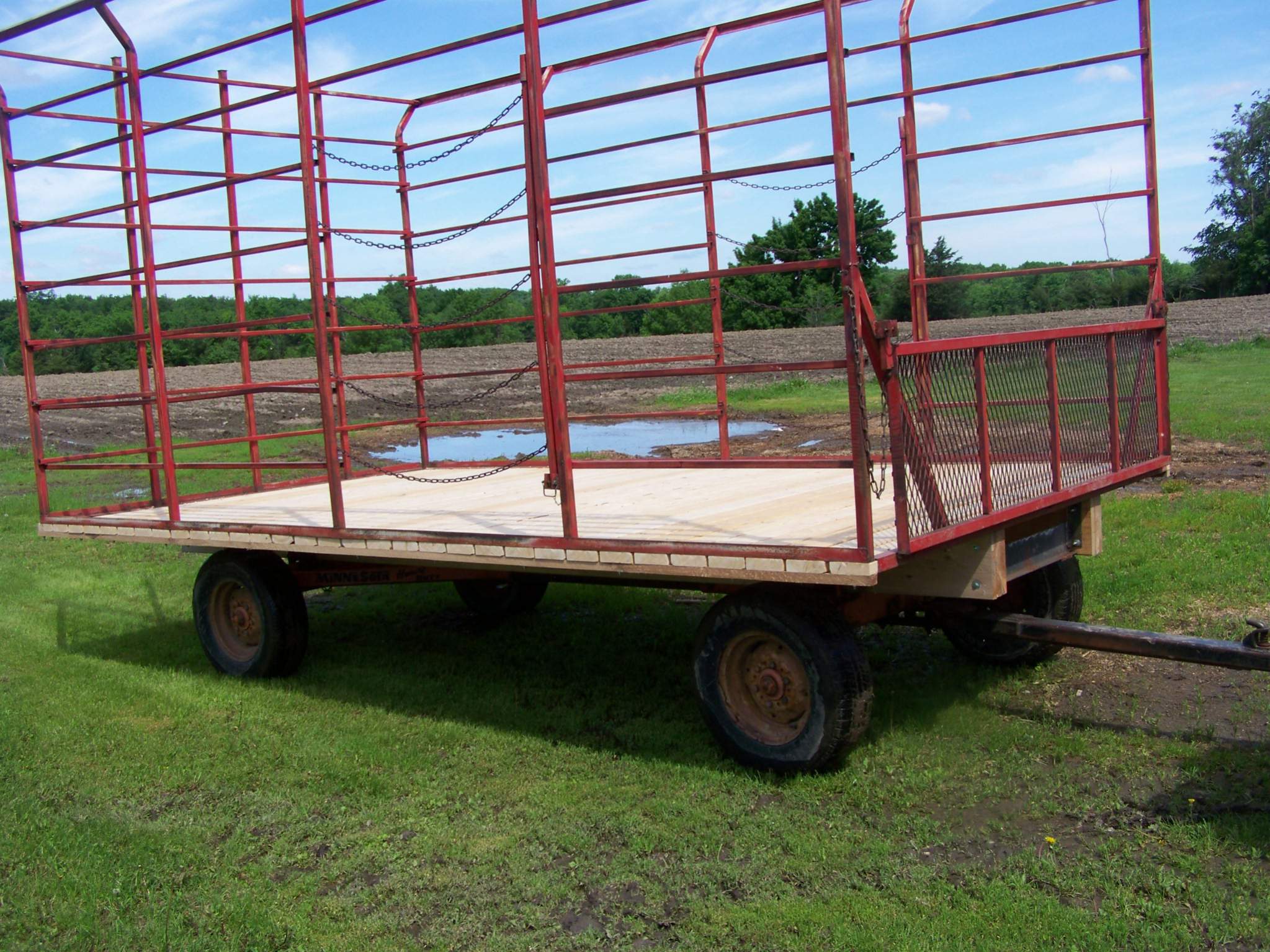

We have 9 x 16 foot wagons, and our bales are about 3 foot. We can also steer the thrower, which helps a great deal. A typical load is 120 bales without stopping. If I stop to re arrange the bales, I can get another 15 on.
I just put a new floor in this wagon last year. I tried something different, and put the boards on cross-ways. It takes less lumber, and it worked very well on the first season.

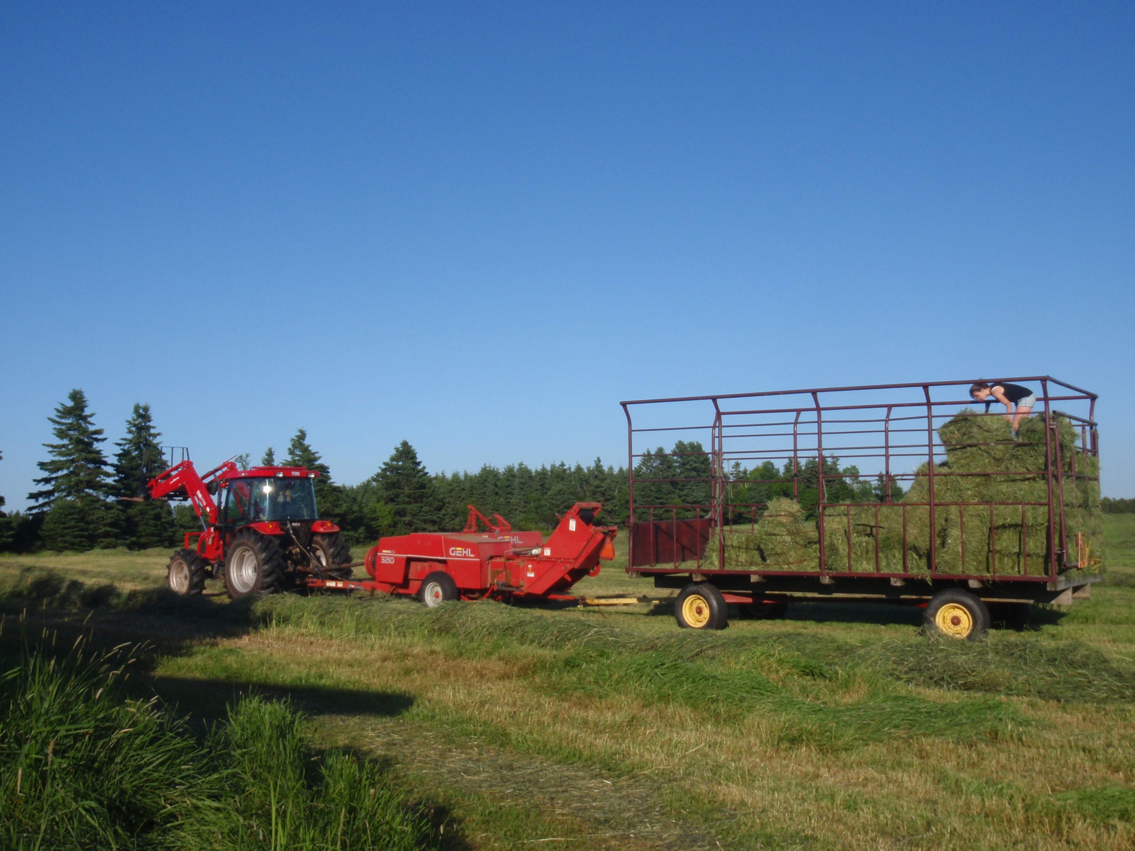

We have a Gehl 3210 with the bale thrower on it but someone usually is on the wagon and stacks the bales as they come in (less trips in from the field) and we get around 120 maybe a bit more like 140 on a big load in a New Holland rack wagon, I don't remember the dimensions off the top of my head (see pic, don't mind the mess on this load my sister was stacking). As stated above with the length, the bales will bow when they land if they are too long or not tight enough. I would say 4' is too long.

Canuck--Your Gehl 3210 is almost certainly 8 ft wide inside by 18 Ft
It could possibly be 20 ft long.
