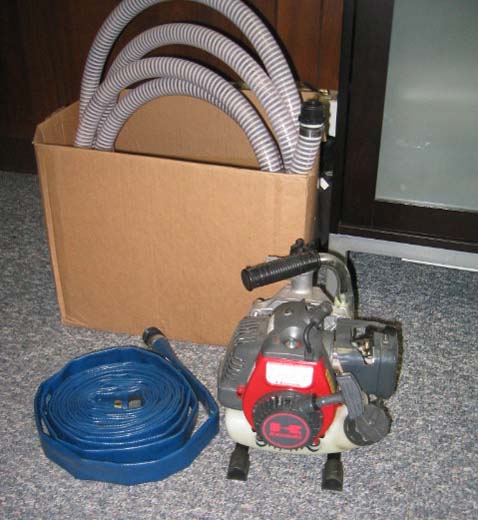

Something like this little baby pump I have? Last year it was about $149 (I think) from Northern Tool.
When it runs you'd swear it was a weed wacker! The engine is a Kawasaki, I ran this little thing for almost 2 straight days (but not over night, the gas tank is only good for about an hour of run time) without any problems.

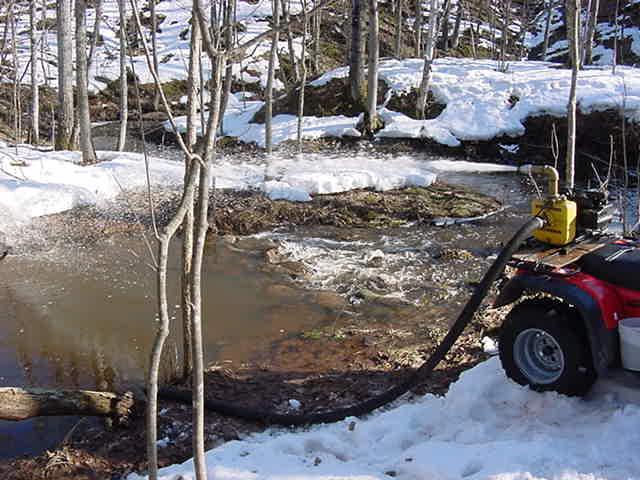

Honda has a wide selection, may want to chk their web site - I've been researching for one for my camp - use it for pumping from the creek when washing the tractors and irrigating small fruit trees. Handiest outfit for cleaning the equipment when there's no electric power supply. Attaching a pic of a Mac that I sold a few months back - too much pump for my current needs. Tuning it up prior to sale.
penokee /forums/images/graemlins/smile.gif
