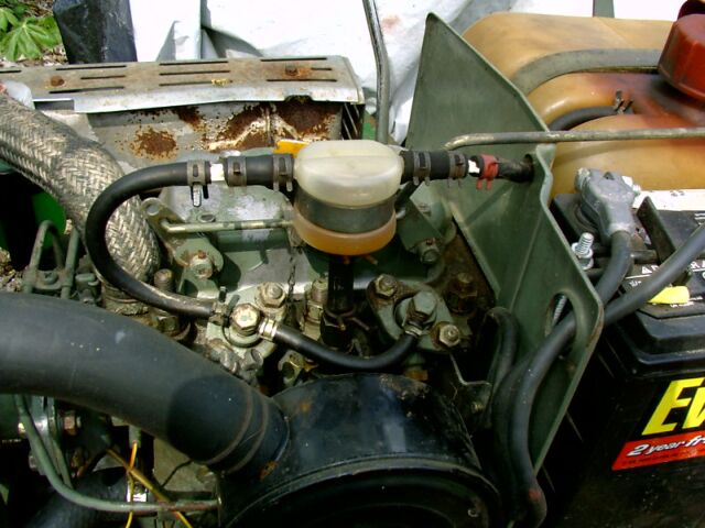

I did! I have a YM1301D that has the refilling type reservior, and a YM1110D that had the manual refilling type. I ordered an extra for the YM1301D and put it in place of the original on the YM1110D. Connecting hoses turned out to be a bit of a challenge because the 1301D used a larger diameter hose for the injector return line so the reservoir needed the larger hose. I ended up using a couple of adapters and clamps. It looks a bit jury-rigged, but it does work. Of course, I have never used the thermo-start since because it just seems too close to the paper air filter element for my comfort.
Now if you are going to do this on a YM240, it is possible that it already has the larger hose, so it may not be a problem. While you are doing all this, I highly recommend replacing all of those fuel lines.

yep, sounds like thermostart bottle to me.
and yes, i've installed the later model botle. seems to work OK. but then again, it's hard to tell, kinda warm now to really need it.. but nevertheless, the bottle does fill jus fine. -arthr

Here's a photo of the automatic refilling bottle I put on my YM1110D.
