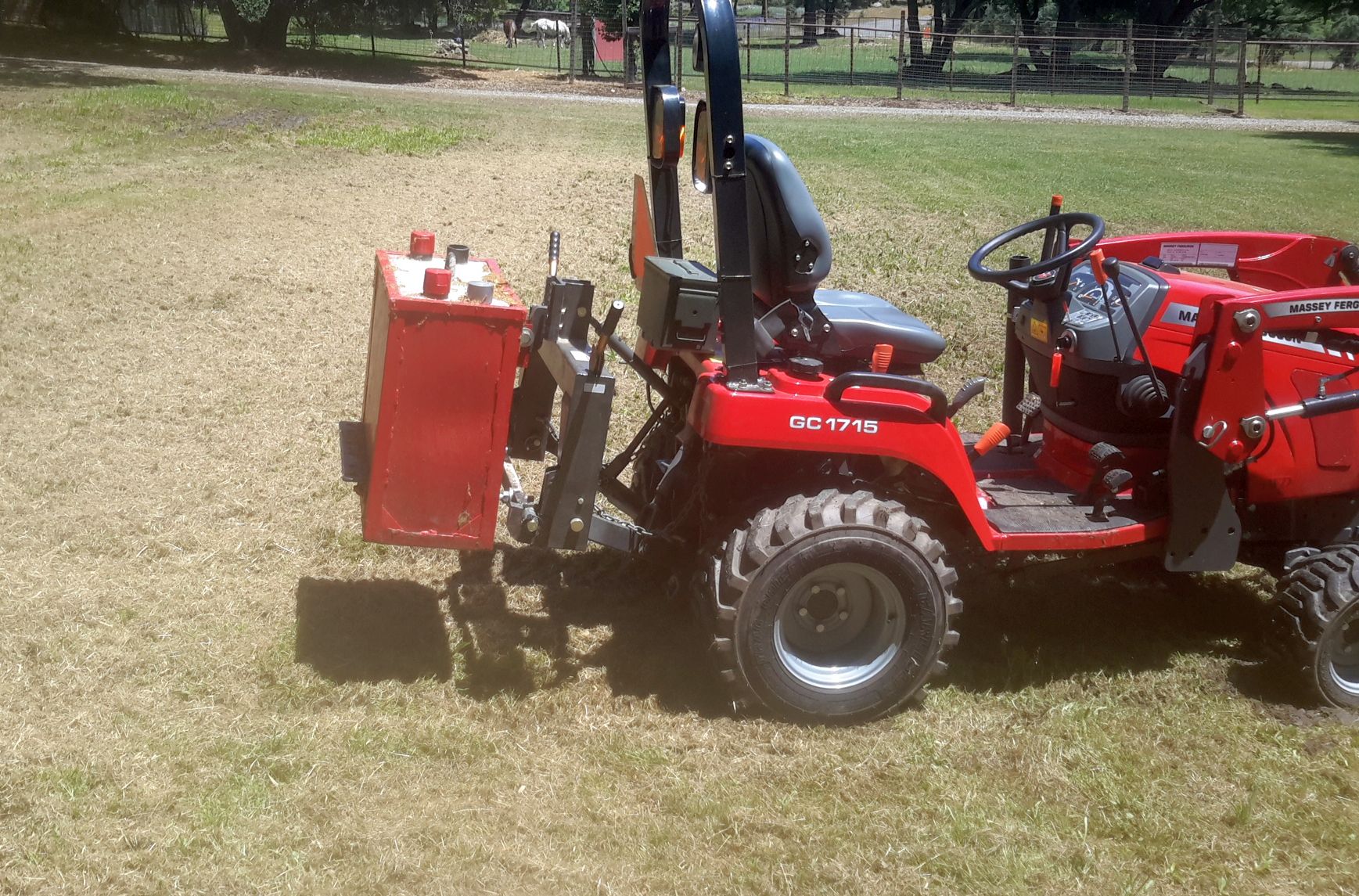

My JD L120 died on me out on back property, yeah "Runs Like A [Dead] Deer", anyway went to retrieve it and with front bumper and wheels of L120 I managed to wedge it into FEL...
Came in from back property and while L120 was still elevated in loader jumped off tractor.... MISTAKE... My 215 pounds were enough to counter balance the weight of the L120 in bucket....This was a lesson... NEEDS BALLAST....
So made a 500 pound ballast box and now pretty confident about heavy weights in FEL....
According to JD manual the L120 mower weighs in at 520 pounds...
Without ballast box and 215 pound (fat boy) in operator seat..
With ballast box...
Approximately 500 pound Box (about 4 cubic feet of concrete)

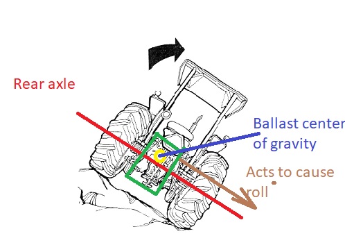

Rear ballast is critical but.... what I see in recent posts is not going to provide the stability being sought.
The rear axle height is a critical part of any design. The tractor draw-bar is located below the rear axle height. Owners are cautioned about pulling from a higher point on the tractor than the draw-bar.
The center of gravity of any rear ballast needs to be below the rear axle height to provide roll stability.
Locate the center of gravity above the rear axle height and the ballast will actually make the roll over worse..
Ballast needs to be low and wide not tall.
Hope my marked up sketch makes sense
Dave M7040
Dave M7040
Yeah I know, and yes ballast was a bit high, but I was doing this in controlled situation and was pretty sure it was safe... If was hauling weigh in bucket (on the fly), both FEL and ballast would be low....
Its a lot like instructive youtube videos, it was contrived to show a example...
Dale
