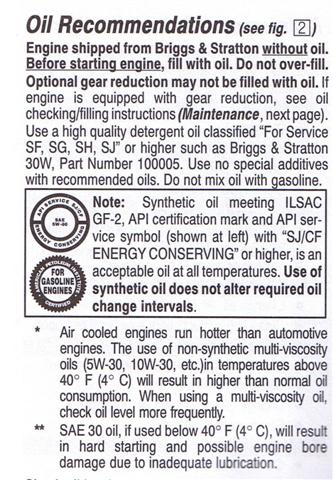

Hi all. The search function doesn't work this AM, so this may be covered elsewhere. What does everyone think about using synthetics motor oil in, say, a wood splitter? Mine is an 8 hp Briggs horizontal that runs at full governed RPM with variable, sometimes heavy, load. I'm thinking of the benefit of easy starting (recoil) mostly. I change oil yearly, after maybe 40 hours operation. Engine is in good shape. Thanks, Jim

Thanks all. I guess what I was wondering was whether the engine which doesn't use oil now would start burning with synthetic. I use straight HD30 dino now, and store this thing in a shed. It starts well but pulls hard, and I always wonder how quickly it's getting lubed at startup. I hold the throttle down to slow idle for a minute or so. I think I'll just switch over and see how it works.
Is a multigrade synthetic like 5W-30 safe for this splitter application? Thanks again, Jim

Hopefully you can read a copy of the manual from my new Briggs motor(after resizing). It should answer a couple of your questions.

Had a serious several conversations with factory rep for small engines 10 years ago, said don't use synthetics, their tests showed their engines ran hotter on them.

Depending on the geographical area, low weight multi-grade oil can cause an engine to rattle and or smoke a little until it reaches operating temperature. Although the synthetic oil that I use stated that it would not void the manufacturers warranty, to avoid any chance of having a claim denied if it ever became necessary to make one, I used exactly what they said to use until the warranty period was over, which was dictated by date and not by time on the motor.
