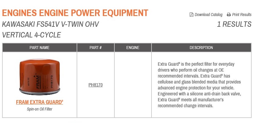

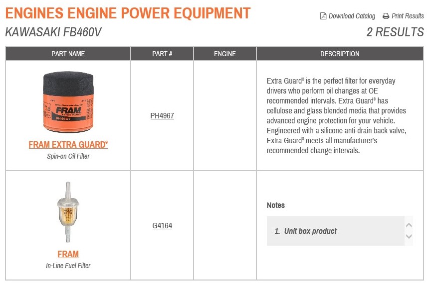

Having a tough time getting aftermarket filter for a new to me Kawasaki FS541V commercial engine. I have a Kawasaki FB460V engine on a mower for 20+ years now and I can get that filter anywhere and at a reasonable price ( $10 for a tiny filter spin-on is nuts). Anyway after wondering if the FB oil filter would work on my FS engine, I looked up equivalents on NAPA ProLink only to find that both oil filters sold by NAPA have the same Filtration and same Gallon per Minute Flow. The Bypass pressure was about the same as well. They are shaped different enough BUT can I assume that if the Gasketing area mates with both filters that I should be able to use one for the other? Do engine manufacturers play with shapes and part numbers just to have us paying premiums and jumping through hoops?
/ Small Engine Oil filters. Same Spec just different sizes? #2
Fram has a really good parts search on their website. Just enter the engine model number and let it search. From the Fram number you could probably cross reference to any manufacturer you wanted. According to the search the two engines use different filters (see pics below, screenshots from the search page). I was curious because you listed the FB460V. I have an FH451V on a mower which uses a Fram PH4967, the same as your FB460V and also the same as the 1996 Toyota Corolla I used to own. I discovered they used the same filter when I got rid of the car and had a few extra filters leftover so I've been using them on the mower ever since.
Here's a link to the parts search page:
Parts Search | FRAM
