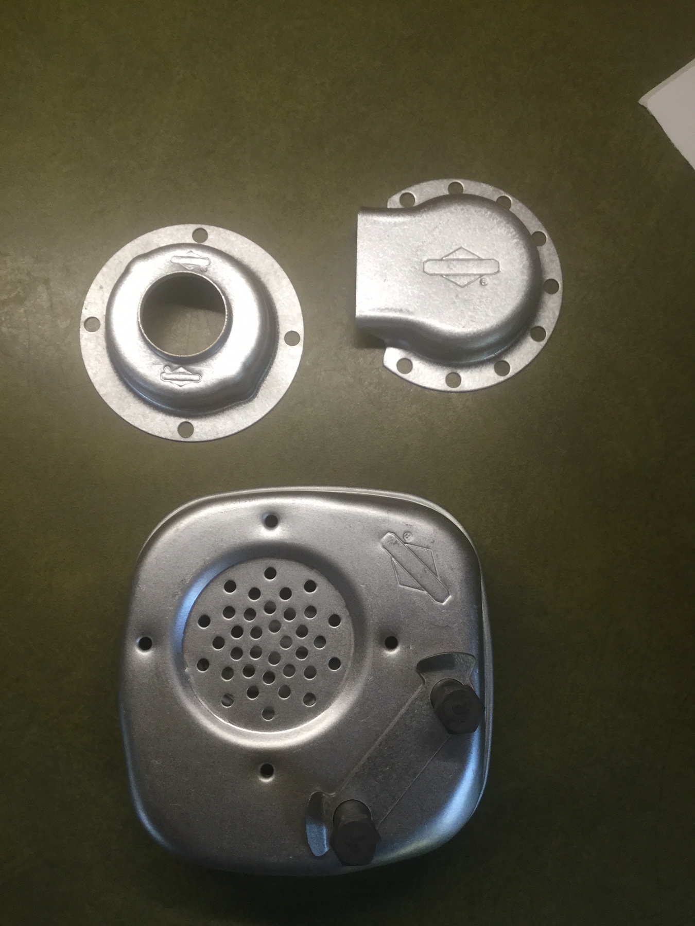

I ordered a new muffler for my mom’s 1970 Montgomery Ward’s rototiller. It’s has a small single cylinder Briggs and Stratton motor on it. New muffler came with “extra parts”. That is, the existing muffler doesn’t have a “deflector” that screws on to the exhaust port like the new muffler. 2 styles of deflector came with the new muffler.
Should I use one?
Will one style make it more quieter than the other?
Will one cause more back pressure and rob power vs. other?
Hopefully these “deflectors” make a decibal reduction as I don’t think the old muffler is too bad, just missing a deflector.
What say you?

It looks like a universal type, and the deflector would be for keeping the exhaust from blowing on you if the muffler faced you. I doubt very much if it will make any difference if you use it or not, performance wise. If you can point it downward it will likely reduce the noise a bit.
So the “90 deg” one is probably quieter than the “straight through” one?

It should be; it can be mounted in four directions so the exhaust can be directed down, up, forward or backward so you should be able to get a configuration where it isn't blowing in your face when using it. Either downward or forward should be best for lowering nose level for the operator.
The round one has the potential that you can weld a sweep on it at say 4:30 so it will direct the exhaust down and a bit forward (or backward depending on which side). Looks like a chunk on 1.375" fence tubing would work, cut a section out of an old bent frame corner.

Ahh. That makes sense. Thanks.
