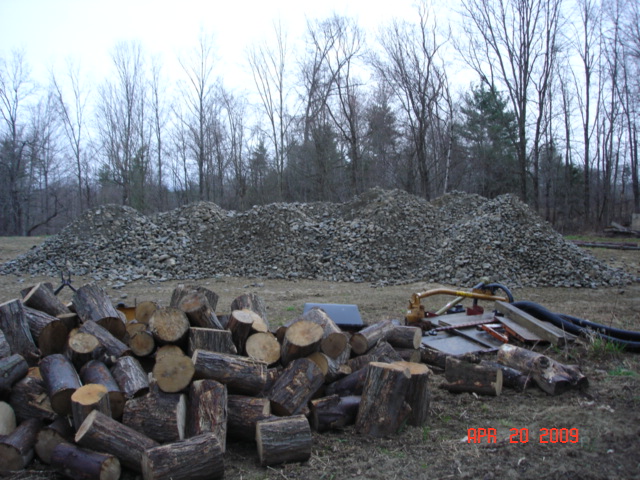

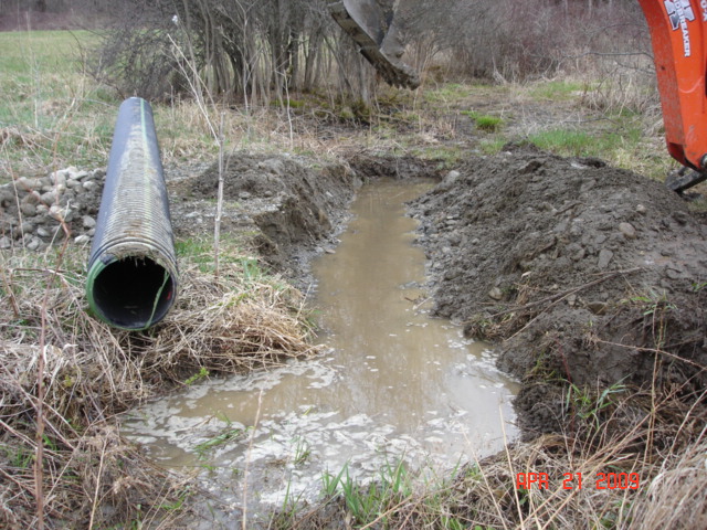

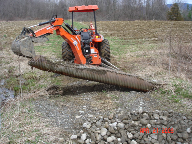

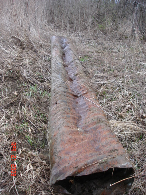

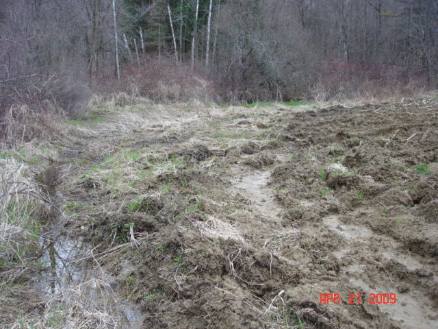

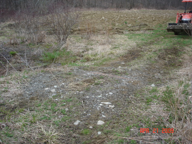

Another evening, another culvert to install. This farm field crossing was troublesome and dangerous. The culvert was old and collapsing and water had saturated the approach and departure areas. The loss of hydraulic capacity caused water to back up and settle out bedload in a little wetland area upstream. Then the little stream jumped and started into the edge of the cornfield, spreading out and flowing into the culvert fill areas. The culvert came out too easy, as the top was exposed in sections. Here's some pics.

Yeah, I'd say that culvert has served it's time. :D
Always fun to put the tractor to work.

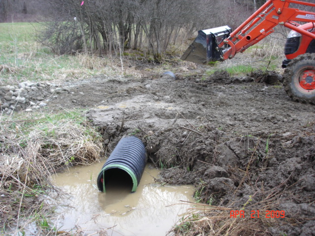

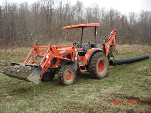

I prepared the streambed bed by excavating about one foot to drop the invert and cause a hydraulic drop into the culvert. This will create a headcut of the stream and re-establish the proper grade to dewater the cornfield. Accordinly, I created a little pool downstream to accept the bedload as it is transported through the culvert. After the stream reach has stabilized, I'll create a small wetland area at the culvert outlet, where there is room. This will help mitigate any sediment and nutrient load before it reaches my pond, several hundred yards downstream.

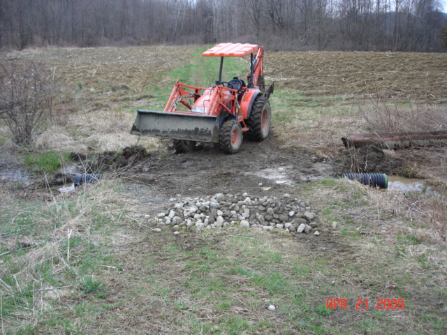

It took less than an hour to do the work. This one was easy. The first one I did was a "beach"....
Of course, some cobbles for more cover fill will be in order.....
