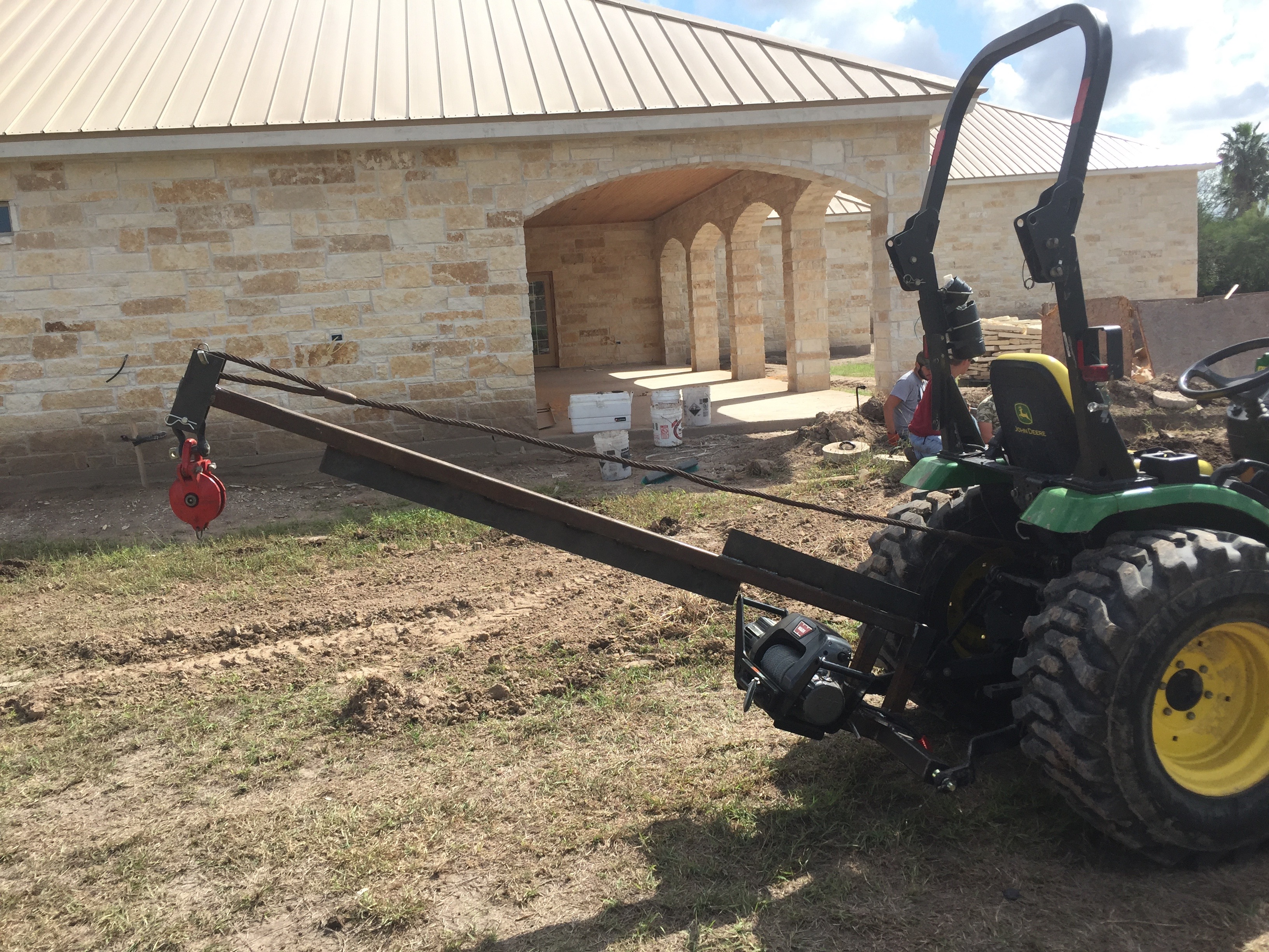

I needed to remove two septic tank 5 ft. lids. I borrowed a boom pole hoping to remove them with my JD2520. No dice. The lids were too heavy. They wouldn't budge an inch. I have a 9.5k winch and knew the winch wouldn't have a problem lifting them.
So I came up with this.

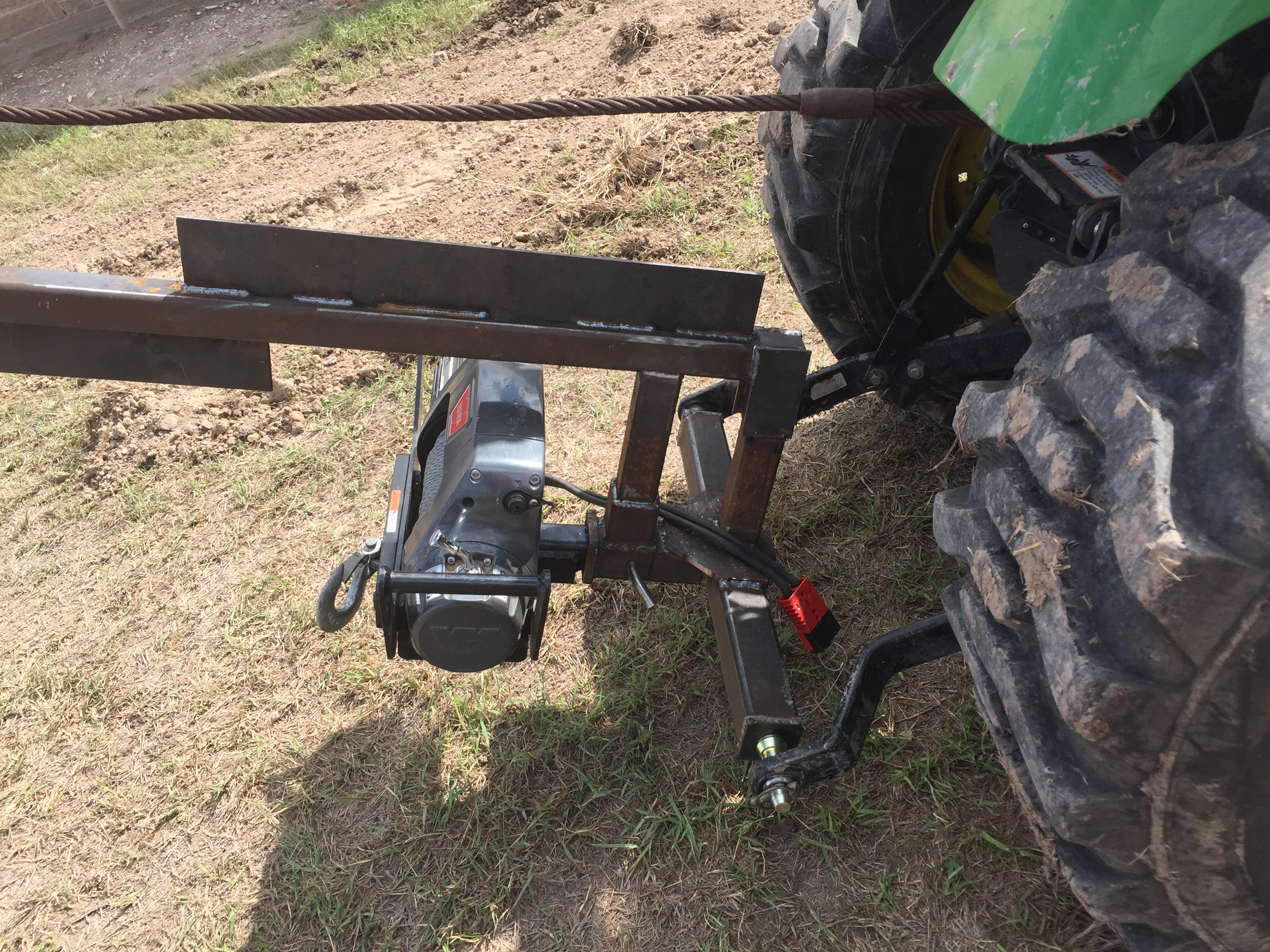

I used 2x2x1/4 tube for boom, 2 1/2 x 2 1/2 x 1/4 for three point attachment and receiver hitch. The cable was borrowed from boom I borrowed earlier. Cut a 3/8 inch plate and drilled 5/8 inch hole on either end for pins at end of boom. The support braces are cut from 1/4 inch plate. The two plates at the end (behind the winch) are cut from 3/16 inch plate. The gusset plate on the 2 1/2 inch receiver/cross member is 3/8 inches.
It couldn't ask for better results. The crane did exactly what I needed it to do. I returned the cable and ordered an 8 ft. 5/8" Single Leg Thimble and Thimble Wire Rope to have for later use. I really don't like borrowing things.

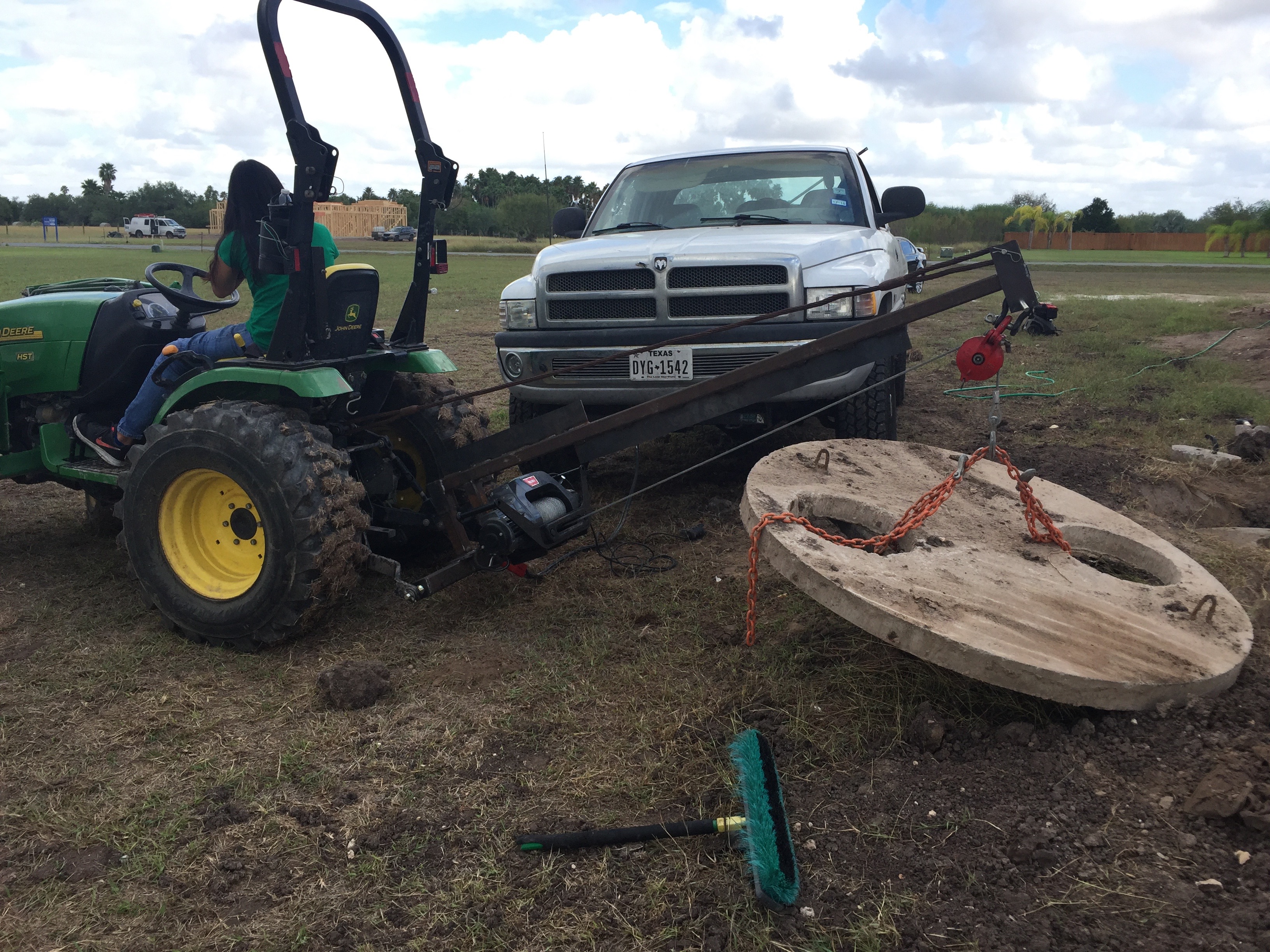

I noticed on the photo that it appears the chain hook tip was inserted into the middle of the chain loop. If so be careful and be sure to slip the chain hook over the loop midsection as the bottom picture shows on the left with the loose dangling chain. Will help prevent failure and the results from such.
Neat adapting of what is available to get the job done :)
   / Small crane for JD2520
I noticed on the photo that it appears the chain hook tip was inserted into the middle of the chain loop...
Wow you are absolutely right. Sure glad it held the way it was hooked up. I looked at another photo and you can definitely see the tip of the hook in the middle of the chain loop. That's a serious accident waiting to happen. Great catch!

The winch is lifting the load. The 3-point is just holding it in place. The first attempt of removing the lids, I had the chain wrapped around with a lot of slack. I lifted the hook all the way up to the pulley and still needed about 4 more inches to clear the ground. Tried to raise it with the 3 point and it wouldn't budge. Had to lower the lid and take out some slack on the chain.

Curious why you did not use the lifting eyes built into the lid?
Glad you got that done either way.
