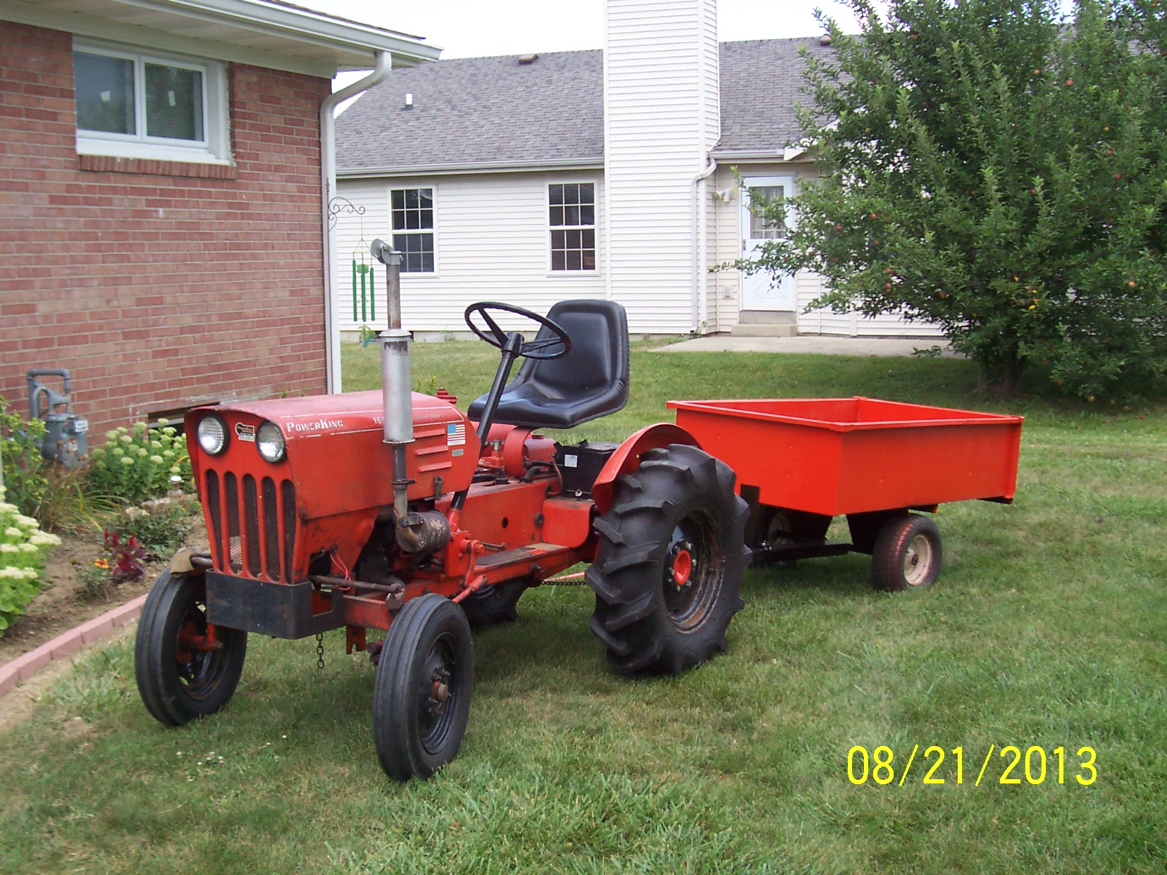

This was my unit for removing snow, until I bought the Kubota, B-2920. I still have the Power King, but it has become my Antique Show Tractor. It is a 1980, 1618, Power King, 18HP single OHV, Kohler K-361 engine. Hyd 3 point hitch, 2 transmissions, in tandem. Both have 3 speeds, and reverse. :thumbsup: Don on one of his tractors.jpgPK with snow blade.png100_1430.JPG

That's a classic design and a very handsome machine.

Thank you sir. I like it. We have a large garden and it served us well, until we bought the Kubota B-2920, and we semi-retired the Power King Take a look on you tube, and do a you tube search, (javahjoeo) you can see the Power king in action. (notice the spelling, javahjoeo)
