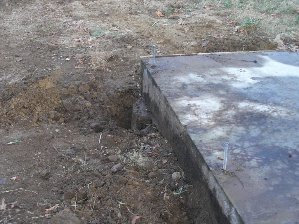

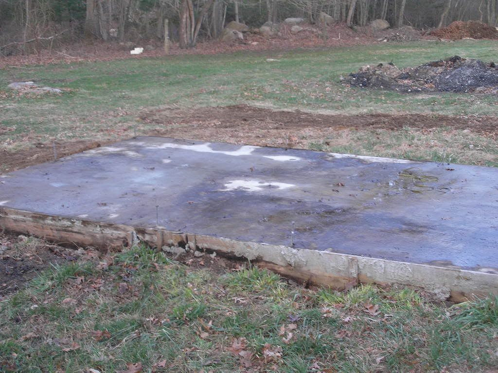

I am looking in to building a 2 stall horse barn on my property. I was thinking 24x20 with a hay loft would be plenty (I don't want to make it any bigger or the wife will buy more horses :D ) The previous owners at one point decided to start to build a shed but they never got passed the foundation. This slab is 15' by 10' and it is right where I want to build. I was going to have it torn out and start with a clean site. I dug some areas around the slab to see what I was dealing with. This is what I found:
The slab is 1 foot thick and every 4-5 feet around the perimiter is a 10 inch diameter footing that goes down 48 inches.
Now the problem, I still want to build on this site. but ripping out that much concrete and having the area filled leveled and compacted will raise the cost of the project beyond what I can do right now. I cant do a pole barn on this site with out being able to put the footings in the middle.
I was looking into the Socket Systems Gable frame kits, allowing me to have a 24ft clear span. I would dig the piers along the outside of the existing slab then I would drill the existing slab and place in rebar and rebar mesh and extend the slab. I do know that where the existing slab meets the new concrete will crack but its a horse barn the entire floor will be covered in rubber mats.
Does any one have any experience with these Socket system kits? (I did do a search and some reading most of the links and pictures have been broken since all posts are over a year old)
Does any one have any other suggestions?

It would be a shame tearing out a nice free :D slab like that. I would alter my layout a bit and incorporate that slab as an extension building to the new stable - There's aways a need for another building somewhere on a horse farm. In fact, that building could become the insulated tack room and you can then squeeze in one more horse in the new stable :rolleyes:
This is a time for some creative planning...

Perhaps you could build your horse barn (with stalls) right beside it, and let the slab be the foundation of a "lean-to" tractor and equipment shed attached to one side of the barn...

Set your post (4"x6" treated) outside of the existing slab and build it any size (dig a ratwall and pour concrete between post) you want. Just incorporate the existing slab into your design. Many lumber yards stock 4/14 pitch 24' truss's. Piece of cake to build.

The slab is probably not 12" thick. What I think you have is called a slab on grade foundation, with piers, (The piers are overkill, unless this is in a swamp). The outer edge is 12" thick. But, If you drill a few holes in the middle of the slab, I bet you will find it is only 4" thick. If so, demolition with an electric pavement breaker is possible.
I would find a way to use it, even if it is as a porch.

The slab is thick in the center, I drilled a hole with the longest masonary bit I had at the house for the hammer drill and the slab is over 7 inches in the center. As far as being a swamp, this is New England where frost heave is a real issue that is probably why the piers are there. I know here in Rhode Island that even piers for decks need to be in at least 48 inches in the ground.

Is the slab where you want the horse barn to be located? Or are you locating the barn where the slab is because it's already there? If it's where you want it to be, then incorporating it into the design of the building makes sense. Since you mentioned that it's not ligned up with the house or property line, I'm wondering if you'll be happy with the horse barn being there over the long term?
It's a real shame to not take advantage of what's available, but sometimes it costs more to try to use existing mistakes then it does to tear it out and start all over fresh. If you plan to live there for awhile, then doing it right should be more important then saving a buck and and avoiding a fews days of labor.
Renting a jackhammer and removing it isn't all that dificult, it's just time consuming.
Do you want concrete under the horses?
