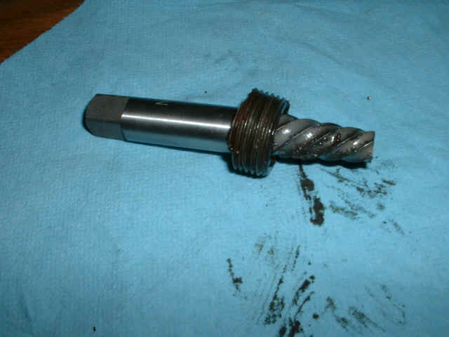

   / Sludge question #7
And if the drain plug already has a hole through it you're half-way there.

   / Sludge question #8
might not be that easy.. the oil pan drain bung on a ford is aftually a flanged arangement abut 2" around.. has a flat square head in the center that people like to mangle up with adjustable wrenches and pipe wrenches after the el-cheap-o previous owner put it on with no gasket and instead used gasket glue, or used a mountain gorilla to torque it to 15 bajillion pounds to keep it from leaking...
at least all the fords I've ever bought were like that... it's really unfortunate since you can make like 12 gaskets out of a sheet of 8.5x11 card stock and an exacto knife.. in about 5 minutes. a cerial box or shoe box will work too.

Good news and bad news. I dunked the oil pan overnight and now it looks fantastic. I figured a night in the electrolysis bath might loosen up the plug as well. I must have some lowland mountain gorilla in me, because when I put the whole pan in my vice I promptly snapped the plug off. Now I thought I'm really up the creek without a paddle, but this where it's good to have friends. I took it to my friends that own a tire shop, they have a bigger shop, bigger wrenches, and after twenty minutes wrestling with it a bigger vocabulary, but they got it. I got a new drain plug and screen and I'll be slapping them on tomorrow.
   / Sludge question #10
actually.. once the center broke out.. it probably helped you by relieving pressure. all the oem caps are cast.. and once that center broke out.. you could chissle it saw cut it from the id pretty easilly.. that.. or still weld a big fastener to it.. I found that has never failed so far..
