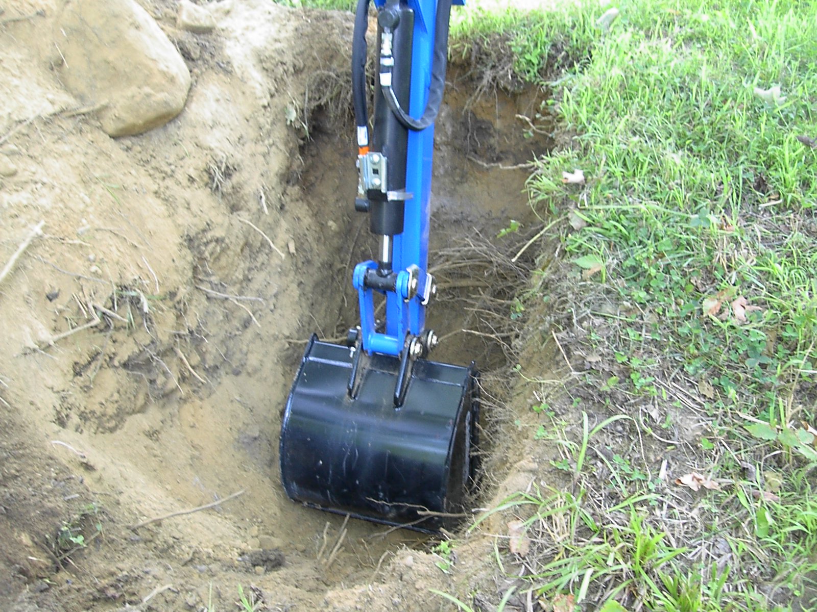

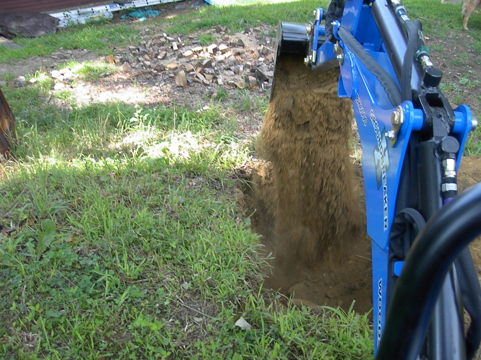

Well..... i will leave it as-is for now. Perhaps more seat time is what i need. I've run backhoes and excavators in the past, so its not a matter of being totally green. Of course, i'm not trying to say i'm smoooooth at it either. Just seems as though the main boom up and down is much faster than the other functions, even with the valve just slightly open.
Mike, i have been taking pictures. I had some gussets cut at the local welding shop yesterday, and have spent most of my day welding today. My subframe is still many hours from being done, but during my "test fit" earlier, i felt i had enough welds on it for a little easy digging. I will continue my thread on my subframe tonight or tomorrow. Stay tuned !! I'll give a little tease with this though....
