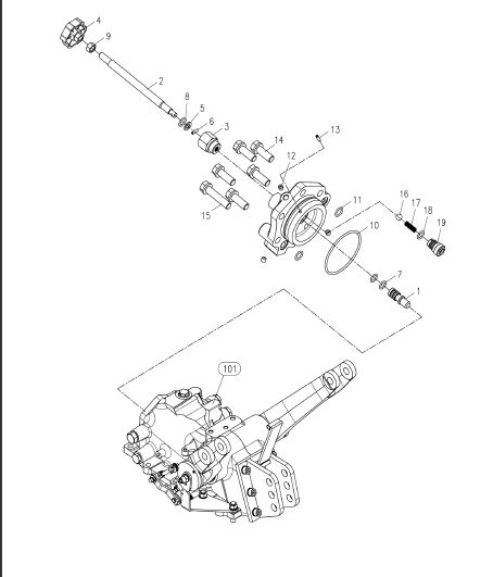

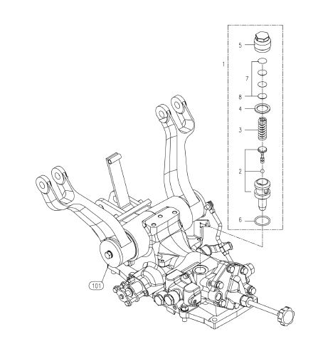

I managed to find a parts diagram for the 20R series, which confirmed the location of the pressure relief valve for the 3 point hitch. I removed the cap and spring, but that is as far as I have gotten. I would like to pull the plunger (valve) up so I can inspect the mating surface of the valve to the valve seat and see if any gunk there, however not sure how to best get that valve up from the seat. There must be a procedure or technique? I thought that maybe if I had a magnet that would fit in there that maybe I could pull it up from the seat. I also had a thought about putting the cap back on without the spring and operating the backhoe controls to see if the pressure would pop it up. If anybody out there has experience in how to do this, or a service manual that describes the process, your help is appreciated. I have also noticed a check valve (ball bearing & spring) in the stop valve housing. I am attaching thumb prints of both the relief valve and the stop valve assemblies .
sassafraspete
