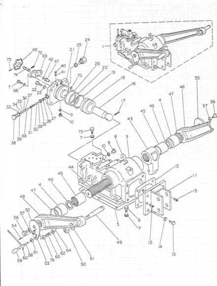

The 3 pnt. lift on my 1510 moves very slow, I have tried to adjust the valve under the seat but it is stuck. Is this the correct valve for adjustment? Where can I get a replacement? What can I expect to pay?

The movement is very slow going down. On the lifting side it is pretty quick. The problem started when I had to replace the transmission cover in which the valve is located. I got a used cover with the valve and all included. The old valve was easily adjustable, but this one seems to be stuck in position. When I replaced the cover, the old one went back to the dealer. I had broke the 3pnt. Lift lever right where it goes thru the cover.

Any suggestion on how to free the valve? Can I remove the valve frome the housing to work on it?

   / Slow 3pnt. Movement? #8
Yanman, Here is a scan of the 1500D parts. The 1510 could be maybe kinda the same. It looks like number 12 and 11 hold the valve 9 in. Wally

   / Slow 3pnt. Movement? #9
Sure! No much room for error. Retainer nut is probubly to tight or the oil around the needle has hardened up. Plenty of WD-40 to help loosen it up and some clean oil to put it back together with. Remember have fun!/w3tcompact/icons/grin.gif

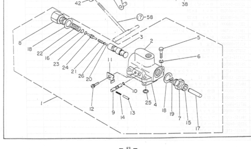

   / Slow 3pnt. Movement? #10
Attached is a scan of the knob and housing. Once again it is from a 1500D and might be maybe kinda the same. 69 looks like the part the valve stem is threaded in to.
