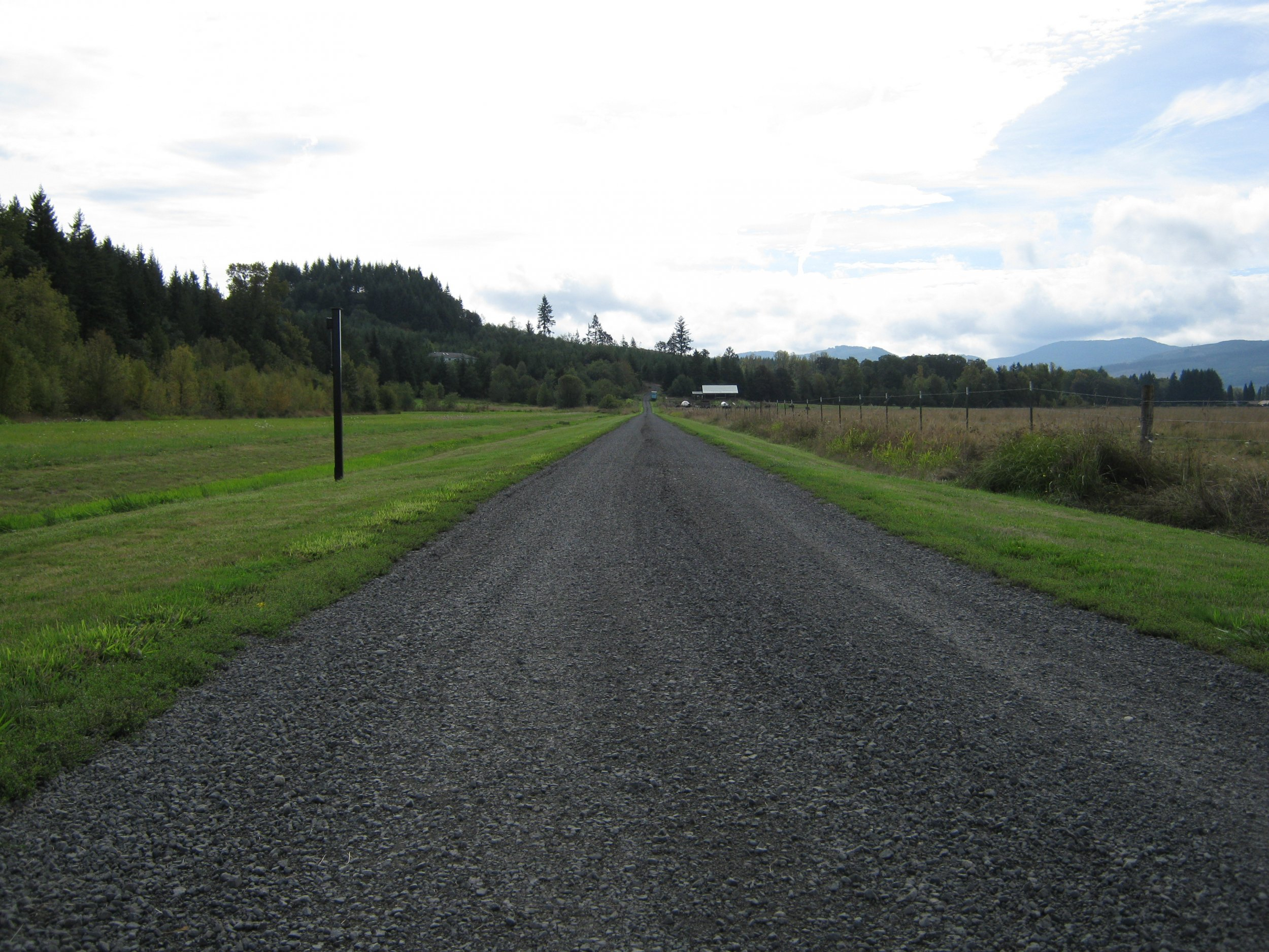

I would like to improve the drainage on our 110 yard sloping gravel (3/4" crushed stone) driveway. It is not ditched and the huge amount of rain this summer has turned it into a small creek which drains into our neighborhood road (also unditched) and helps turn it into a bigger creek. I would prefer a solution short of building up a crown, paving, or use of those expensive plastic paver grids. I am considering installing some type of french drains slanted across the driveway in three places and trenched farther into the woods on a downward slope. The driveway slope is not great but enough to cause problems when we have a downpour. Would appreciate any ideas or experience on this subject.

Slope the entire drive slightly to one side then ditch on that side to where you want.
   / Sloping Gravel Driveway Drainage #3
French drains always plug up. You can spend more money on them to delay this, but they will still plug up eventually.
Open ditches are the only way to ensure proper drainage for the long term.
Culverts need to be big enough to handle the worse storms, and they need to be protected from erosion with concrete at both ends to remain in place for the long term.
Sometimes the only solution is the one you don't want to do the most. Dig the ditches and solve the problem.

Regular french drains (FD) will clog up. But OPEN french drains usually will not. What's an open FD? Kind of like a trough drain. Instead of covering the perforated pipe with dirt, or crushed stone, cover the pipe with #57 or larger stones (no fines) so that the water will fall into the FD freely. Personally, I'd use perforated PVC pipe that they use in leach fields for septic systems, rather than the black perforated corrugated flex pipe. Place it 4"-6" below the finish grade of the drive, slope downward and it should work pretty good. For 110 yard long drive, I'd probably do them every 20'-30' on the steepest sloped areas, and every 50' on the flatter areas.
As another poster suggested, slope the pipe outward to the low side of the driveway, and then dig the drainage ditch to relieve the water from the driveway. Your profile says you have an FEL. Dig the ditch with that if you don't have access to a mini excavator. I dug a drainage ditch/swale with my FEL that was 300' long. Works fine. Have to clean it out once every 2-3 years, but no biggie.

You don't say how much the drive is sloped?...I generally agree with 'Eagle1'...the key is getting the water (runoff) to run off the drive and not DOWN the drive...pitch to the low side if there is one (even if it requires a culvert)...
...Stop the water from running down the drive and it will stop any loss of gravel due to storm water...because there is no room for accumulation...
