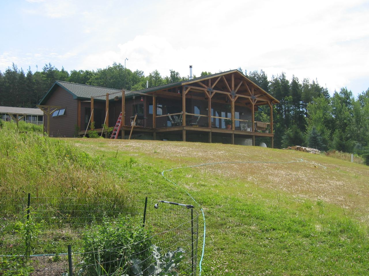

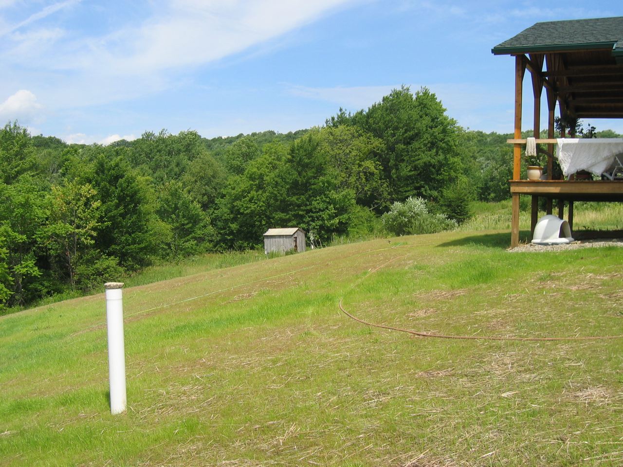

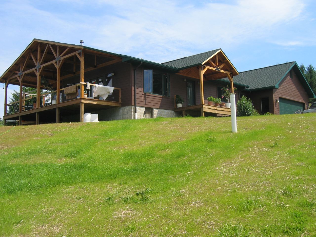

I've been lurking here for a while and with the rates and new equipment Kubota has out I'm thinking of taking the plunge soon. I have been working on the house for the past 4 years. Well this year I plan on getting to the landscaping and maintance of the yard. Just another excuse for toys my CFO says! I'm really looking for some advice on a tractor that will help with the following. I know that no one unit will do them all well but what can I live with.
Requirements:
1) We supplement the radiant with a wood stove so I'll be moving logs and wood.
2) Living in Western NY we get our fair share of snow so I'll have that to deal with that.
3) landscaping round the house and at the pond out back. I'll need a loader and maybe a BH... Thoughts?
4) Mowing... This is a major concern...As you can see from the photos its a good slope and I'd like to mow perpendicular to the slope (fewer turns and no turn at the bottom where its steeper!)
We (the bank) own 7 acres and maintain about 4 the rest is pond (1+acre), steep hillside (1+acres) and fields which I'd like to brush hog regularly.
What tractor if one exists would you recommend for this job?
Thank you for any suggestions!

Beautiful home!

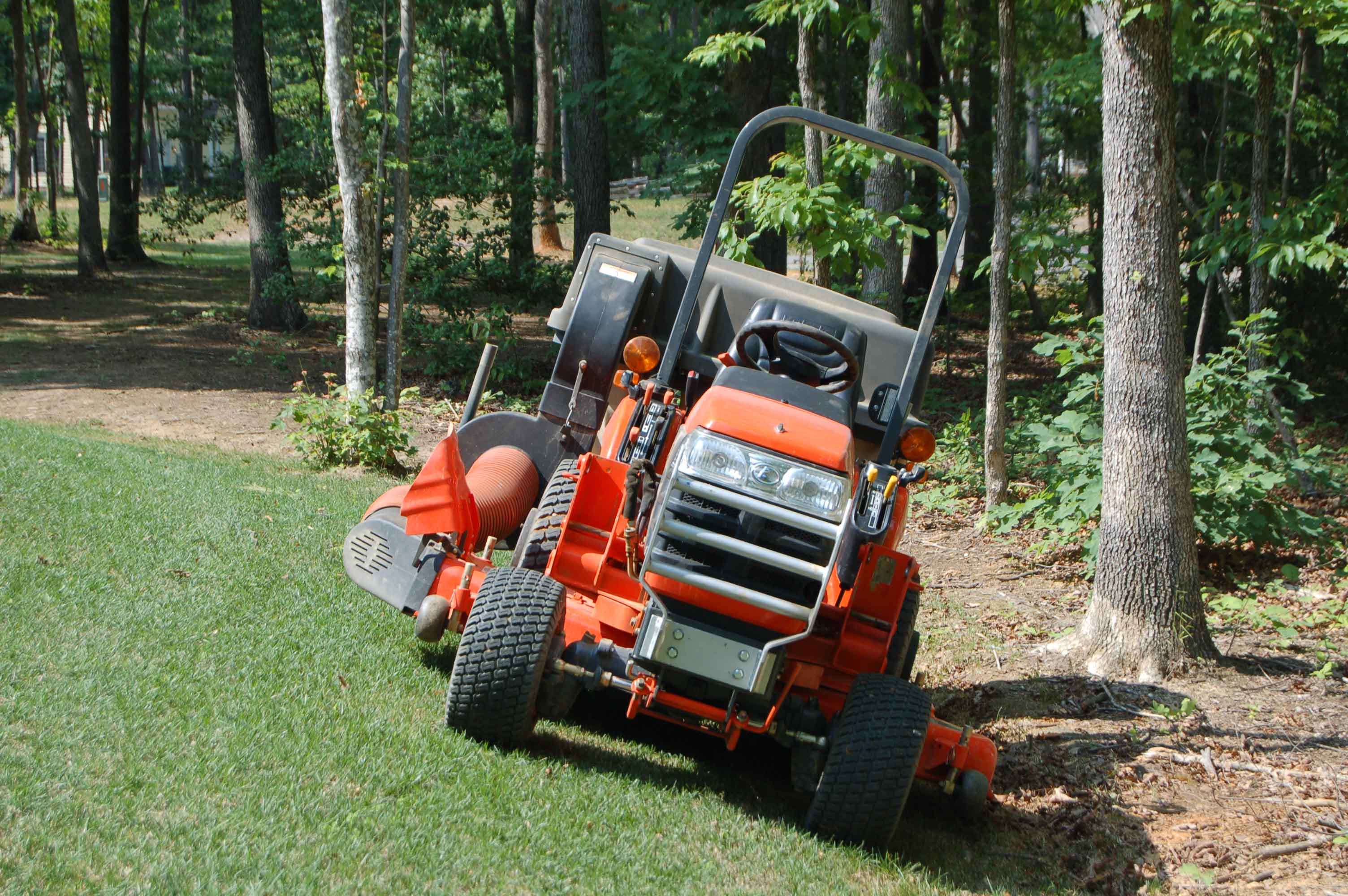

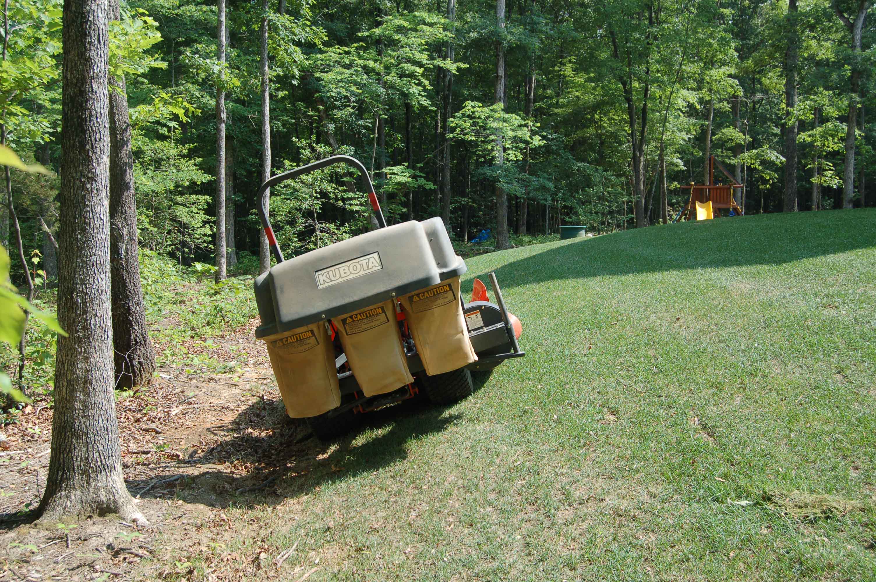

Slope looks tough. I've attached some images of my tractor on the "steep" part of my yard. I'm probably fairly safe, but always feel a little uncomfortable on this part of the yard. It feels much steeper when you are perched on the seat with 2,000# of very expensive (and paid off) machine under you.
Doesn't look like much in the pictures, but I am fairly certain that with the FEL and 100% certain that with the BH attached, there is a real risk of a tipover. I've tried it and can't get up enough stones to get too far down the hill. Remember, it isn't just the slope, it is if you hit ONE LITTLE HOLE or soft spot with the front or rear tire. Heck, a branch under the back tire at the wrong moment could send you over very quickly.
That said, I don't see how you could get around purchase of a ZTR for mowing that slope. I would feel concern just going up and down that slope, but if you are smart about it, you should be OK. Up and down. I don't think it is reasonable to think you could traverse that slope sideways with a tractor.

Since you've been lurking for a while, I'll assume you've been following the threads on the new standard B series machines. I think one of those would be a good starting point. Light enough to mow with, though you should go with liquid ballast with your slopes, and should be powerful enough to do most of your chores.

Bandit67 when I started my research a little over a hear and a half ago I first thought because of the slope that the BX 24 would do all I wanted. Then after reading, and reading, and reading.... I was concerned with the low ground clearance. After all its not a suburban lawn... And I have read that some have had issues with the oil filter getting the wrong end of a rock/log.
My next move was the B7610. I priced one out w/loader, BH, mmm, loaded tires, chains, front plow for around $24k!!!! I thought that was steep but it was low enough I thought to comfortable on the slope (if that is possible) yet large enough to do the plowing and wood hauling I'll need.
Regarding the new B's YES I WANT ONE!! Just finding it hard to compare them side by side. The lack of literature comparing all the B's and their respective loader, BH's..... Does make this more challenging they it should be.
KeithInSpace your slope is almost exactly what mine is. Only mine just gets steeper and ends up being over grown with brush. I'd hate to roll into that!! Speaking of that how many of you keep your loader on when mowing? I've thought that if it were on, and low, it would add more mass to a lower center of gravity? Or am I just hoping?
Just a thought but would I be out of line in asking a dealer if they would allow me to try one on my property? What could they do besides say no?

I'd think that 90+% of the people mowing with a RFM (bush hog) leave the FEL mounted as counterbalance.
At the same time, I'd think that 90% of the folks mowing with MMM take the FEL if it is the quick-attach type. It takes LITERALLY 50 seconds to remove the FEL and having it mounted almost forces you to have something hanging off the back to counterbalance. If you are using a MMM, you are probably on turf and don't want all that extra weight. Plus the arms and hydraulics are quite heavy and well ABOVE your desired COG, so I'd say that if it isn't a wash, the net effect would be LESS stability.
As I said before, I have attempted to traverse this particular slope WITH the FEL and box blade and WITHOUT the MMM and could not muster the courage to do so. As a series of experiments I perform before attacking any unknown slope, I get as far as the uphill rear tire becoming "unweighted" (I can pick that corner of the tractor unassisted) and is the first step to tipping it over.
The only reason I regularly traverse that slope is that the MMM is mounted, the FEL is not, and the heavy bagger turbine is on the uphill side. I won't tackle the same slope going the other direction as the main weight of the bagger would then be on the wrong side.
Then again, maybe I'm a wussy.
