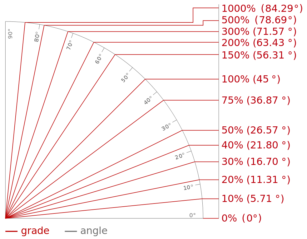

The property has slopes of up to 20%. I don't need to do a lot on those slopes, other than get up and down the slopes to the areas where most of the work will occur.

A 20% slope is only an 11.3 degree angle. A PT425 with a bucket full of stone could go up that without issue. Pulling a trailer is a different story.
