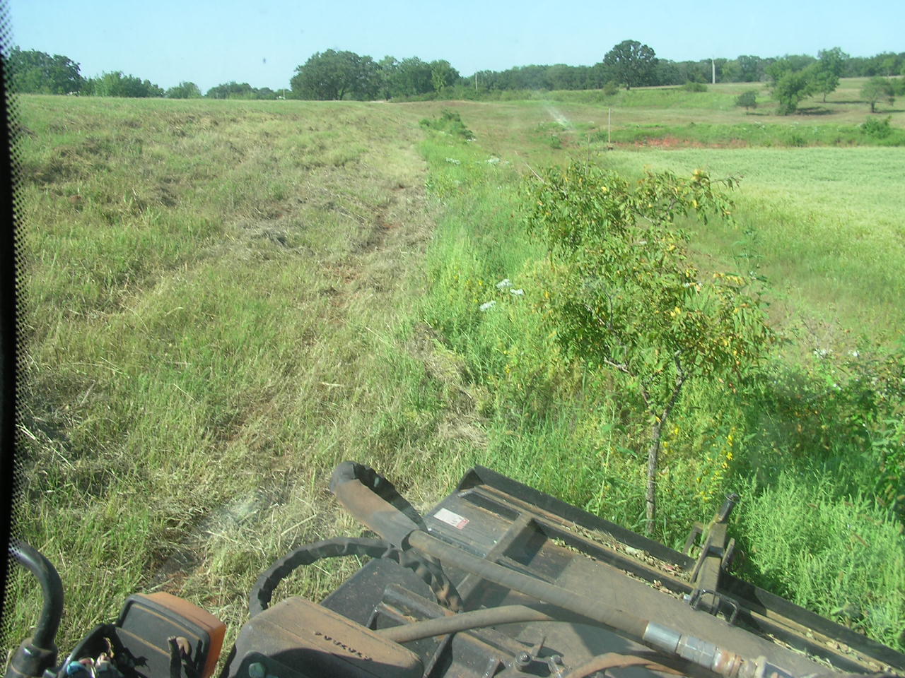

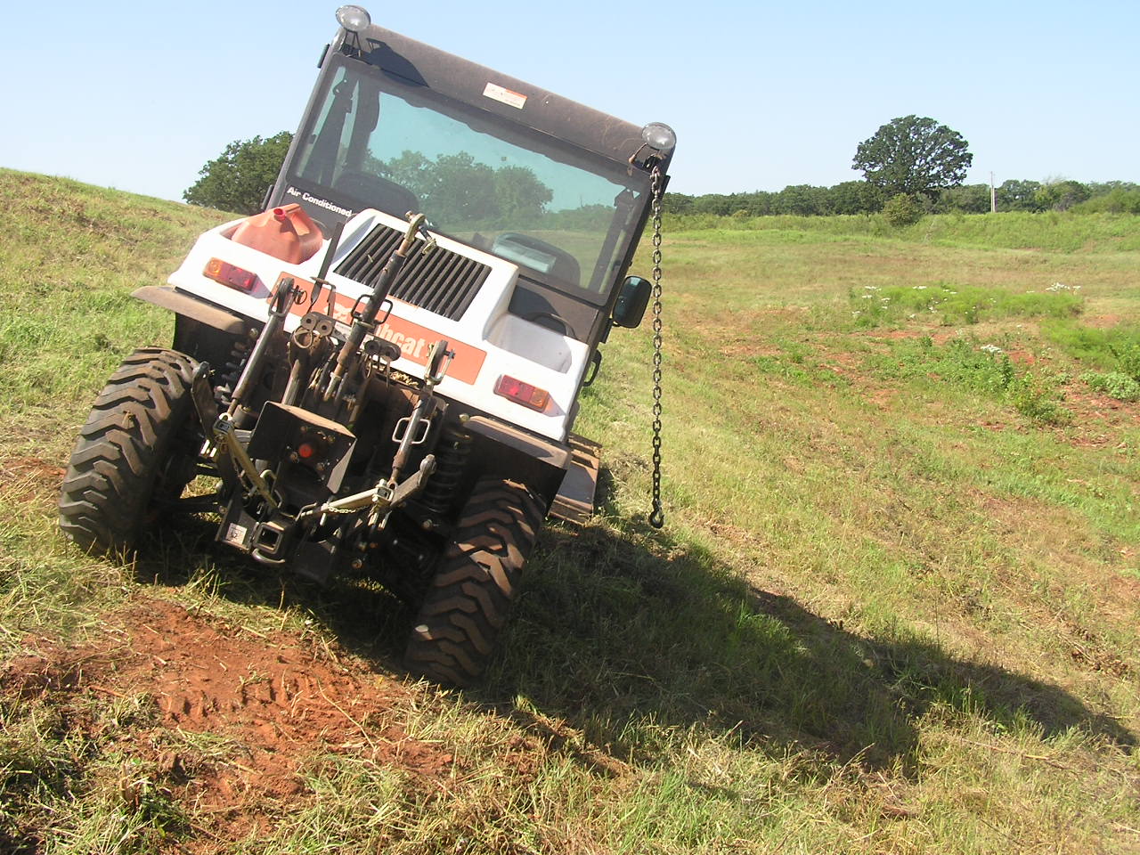

I am resurrecting this old thread, because the question of operating on steep slopes keeps coming up and there is good info in the first post.
I am more comfortable setting on the high side of the slope.
I set some crab steer to offset the mower to the right and the rear to the left.
Then I mow across the slope with the mower downslope and the rear of the Toolcat upslope.
This is supposed to be a 3:1 slope. View from the seat.
Straightened the rear wheels and mowed straight forward. Hung a chain from the rear work light bracket to show true straight up and down

I may be wrong but it looks less likely to rollover with the offset, compared to going straight.

You could mow a steeper bank if you would remove that heavy chain hanging from the low side light, and hang it from the high side light.
