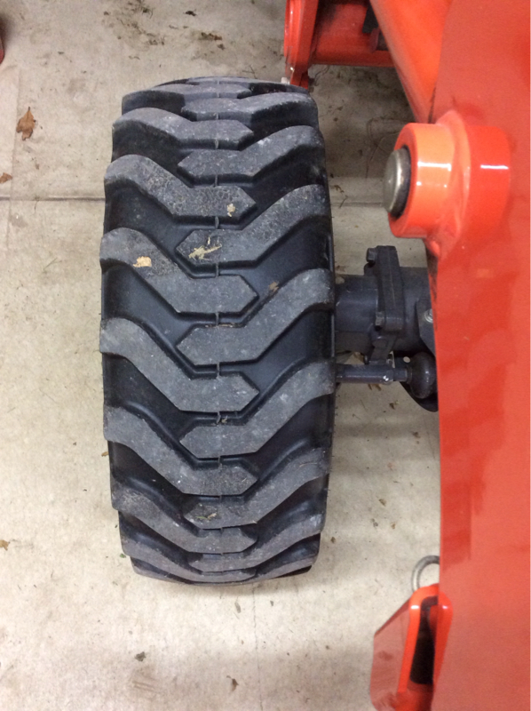

Here's what I did to my front tires to increase traction in the snow. Before image-231748115.jpg After image-1726278173.jpg
I'll also be siping the rear tires.
   / Slipping an sliding with R4s, R1s on the front any help? #7
Cool, and looks well done. But, I'm interested in what tool you used, and free-hand or with some sort of guide?

Here's what I did to my front tires to increase traction in the snow. Before <img src="http://www.tractorbynet.com/forums/attachment.php?attachmentid=346359"/> After <img src="http://www.tractorbynet.com/forums/attachment.php?attachmentid=346360"/> I'll also be siping the rear tires.
I guess you have more biting edges to gri so I can see it working. Is it a lot better?. I wonder will they wear faster?
