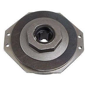

Does it look like this, if so the large nut is the adjustment nut for the discs. IMG_1200.JPG
/ Slip Clutch Adjustment
Does it look like this, if so the large nut is the adjustment nut for the discs. View attachment 624873

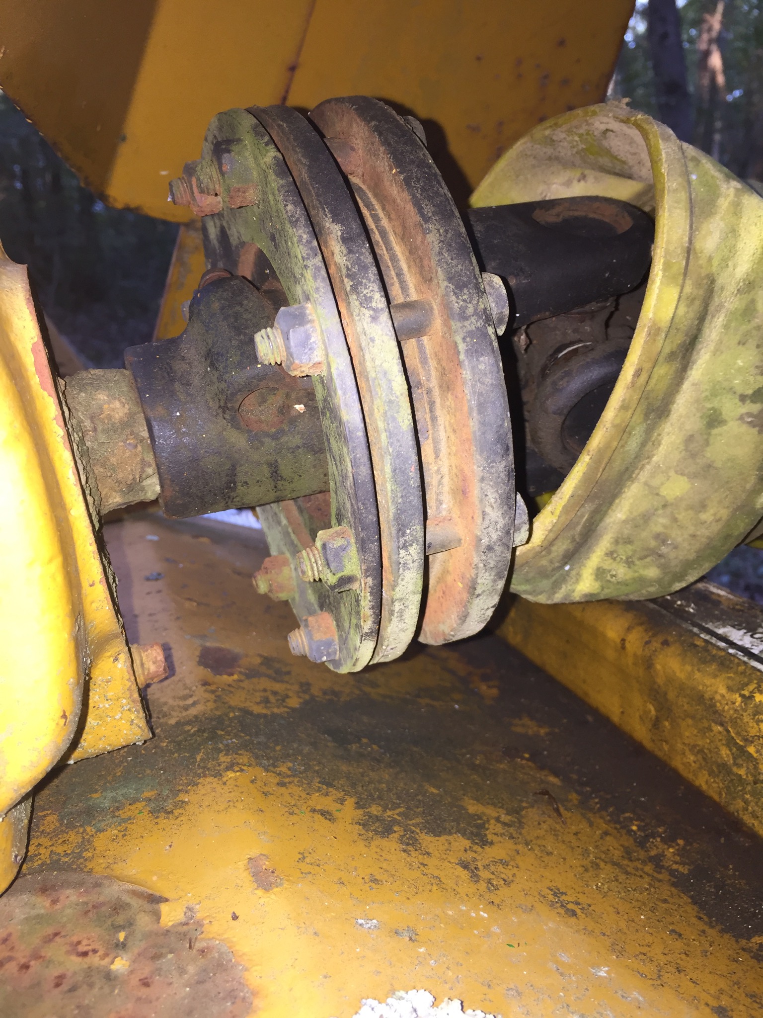

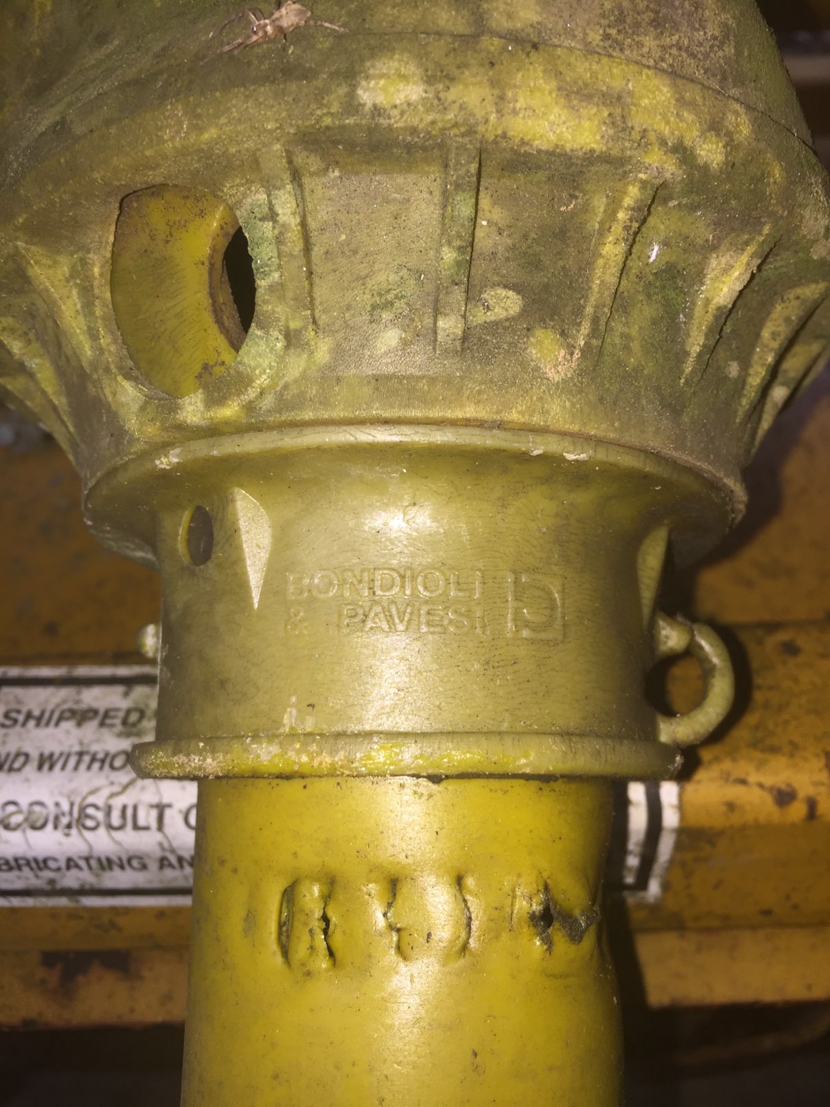

Here is a picture of the slip clutch and model #. Its made by Bondioli & Pavesi. Model is 4 G1 02
file:///C:/Users/brockc/Desktop/Slip%20Clutch.jpg
file:///C:/Users/brockc/Desktop/slip%20clutch%20II.jpg
Not sure if these pictures will open.
Lets try this.
