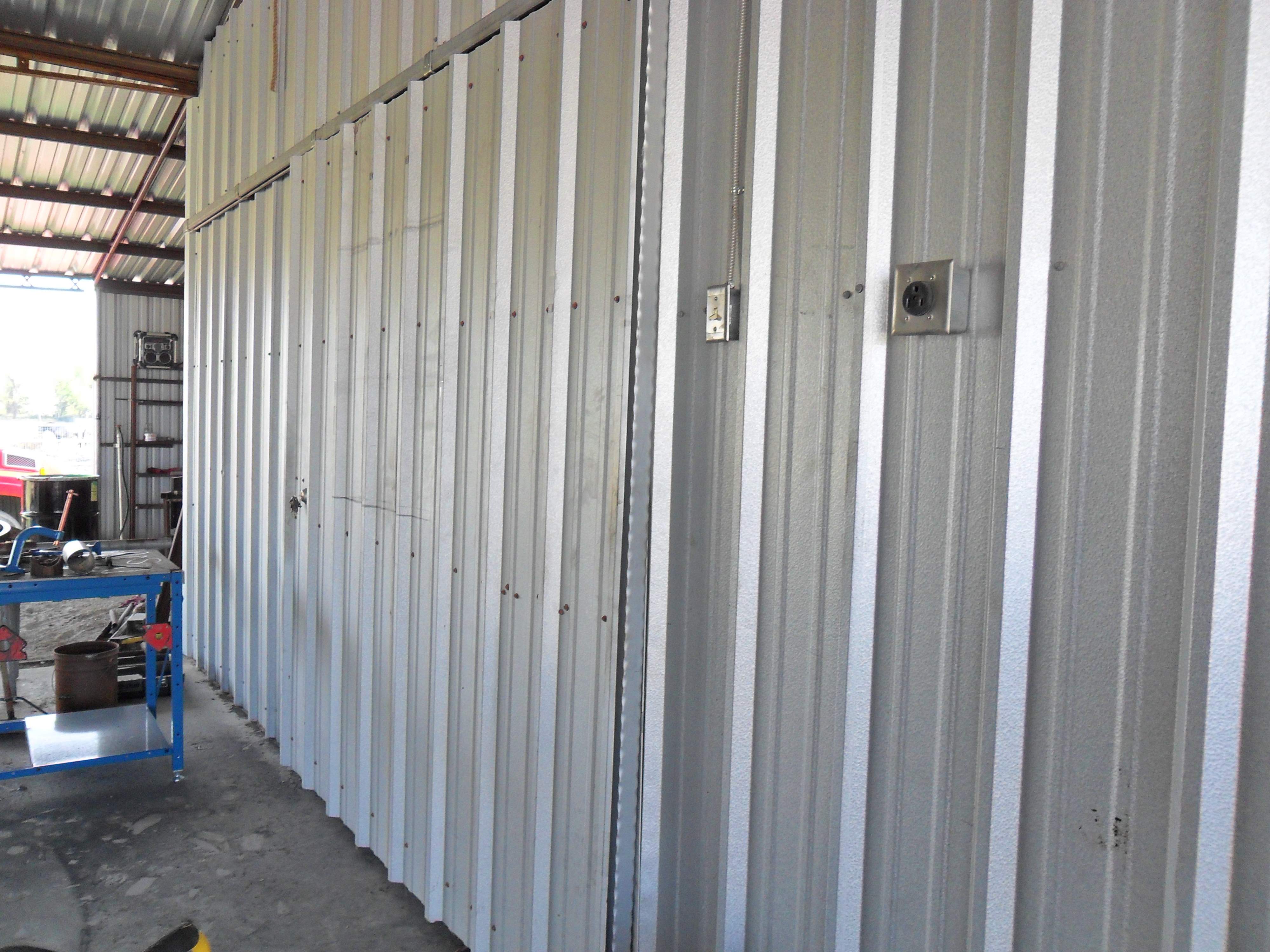

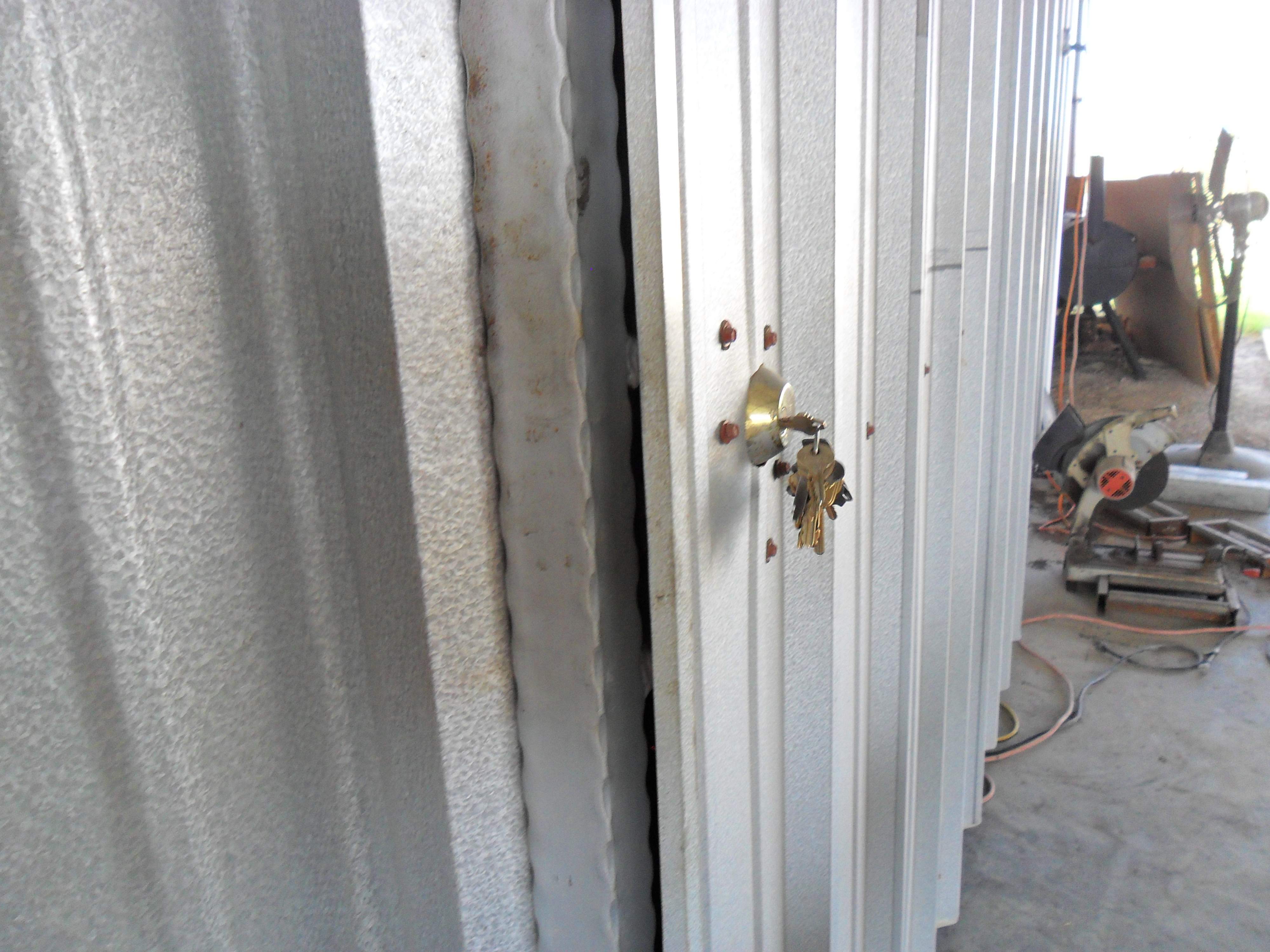

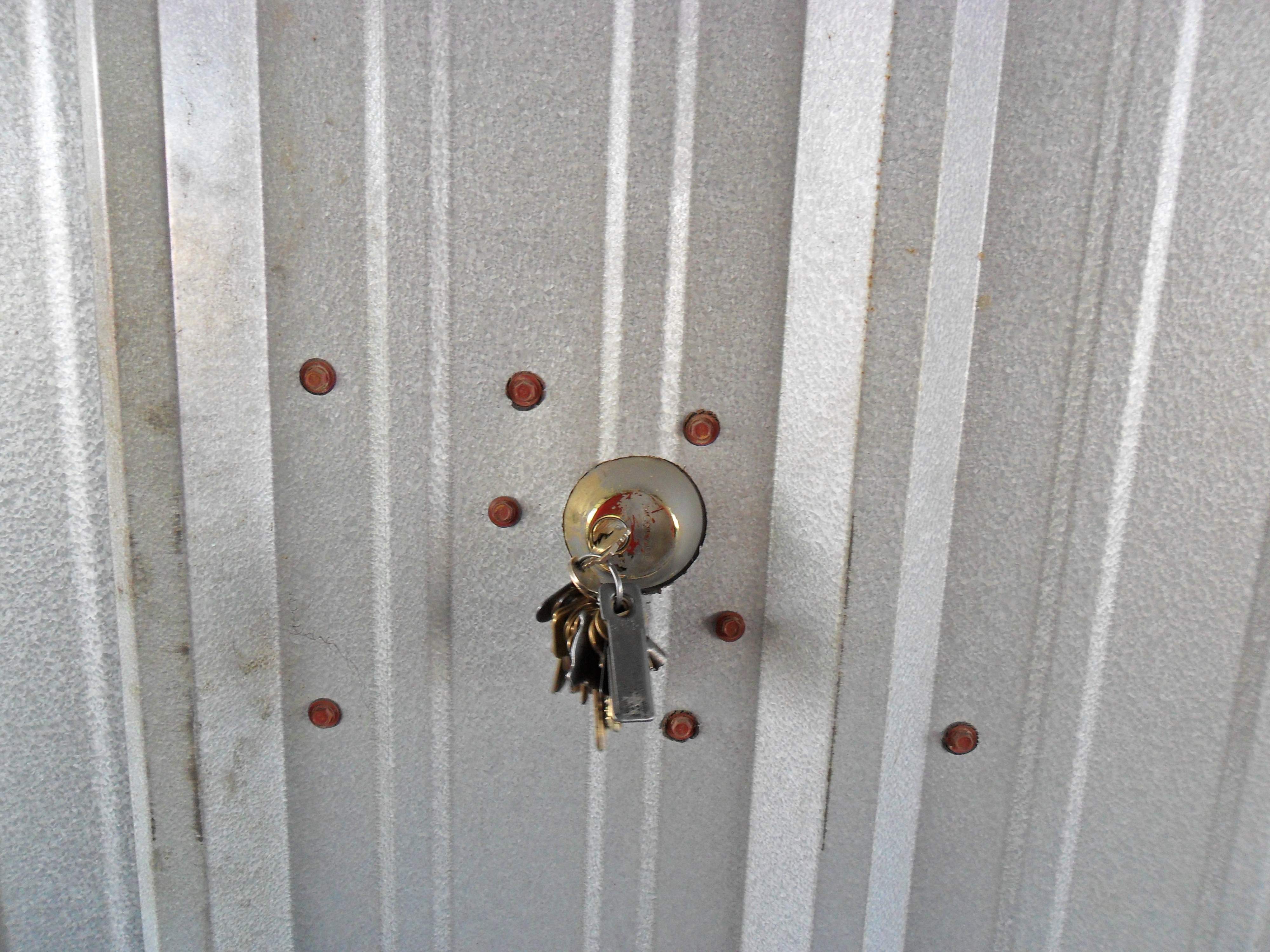

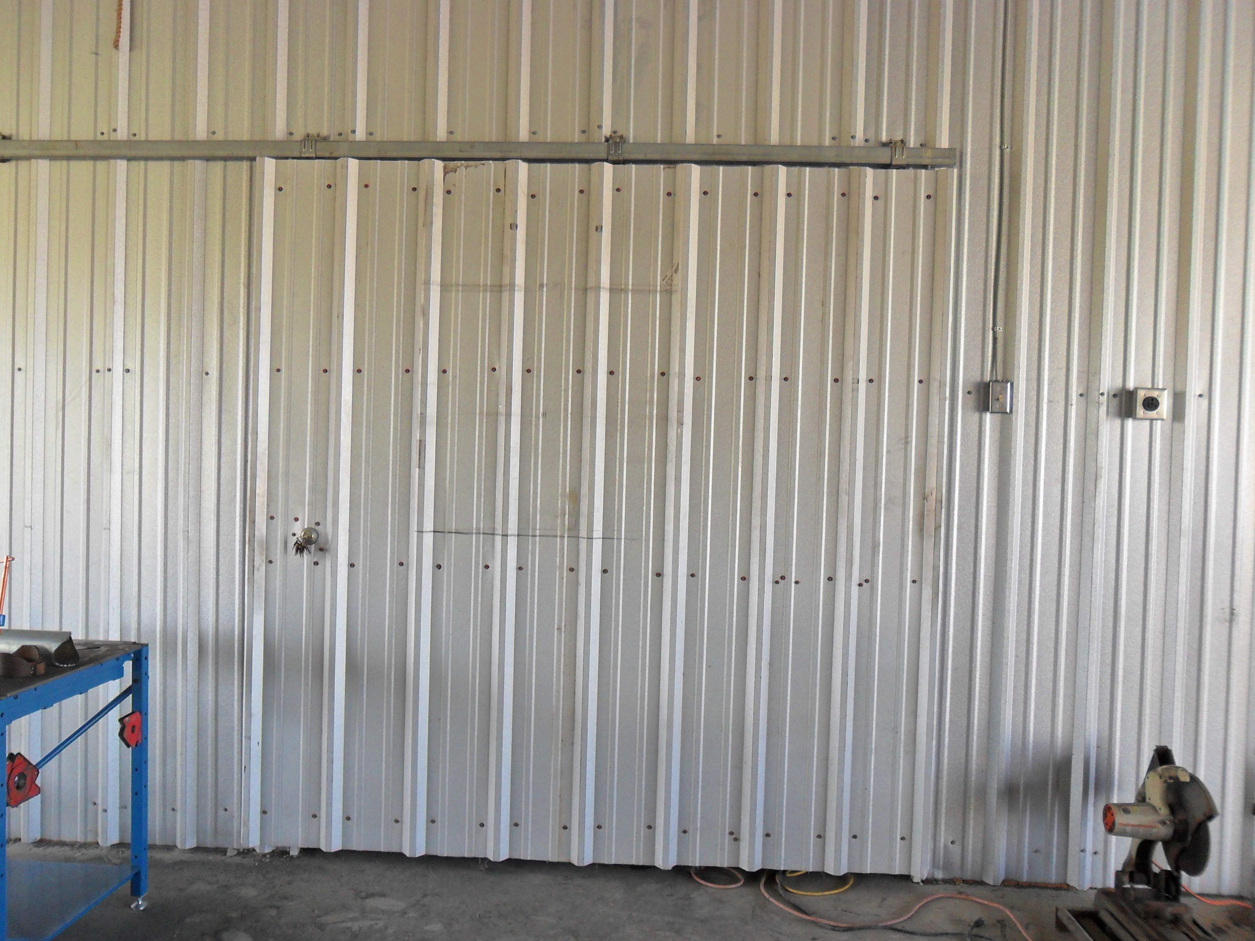

One of my many character flaws involves the way I secure things. I guess a lot of my perverted perspective comes from the lack of respect I have for thieves.
My sliding shop door is an exampe of that.
If you look at it closely there are some things that just aren't right.
The most obvious of course is the door slides to the left and the latch is on the left. The latch is also a deadbolt lock and it offers no clue how it works.
If you was to walk up and try to move the door you would find that it doesn't, move, not at all, you can't even shake it. It can't be moved up or down and it can't be moved in or out.
The disrespect thing, I believe thieves are first and foremost lazy. Getting into through this door is going to take some doing. The other thing about thieves is they're stupid. So when they approach this door its way too complicated to hold their attention long.
As for the obvious before some engineer points it out, the self tapping fasteners, if the thief is armed with a reversable drill or impact they can get in after taking out a ton of screws. What will drive them crazy is some of those screws can't come out, darn.

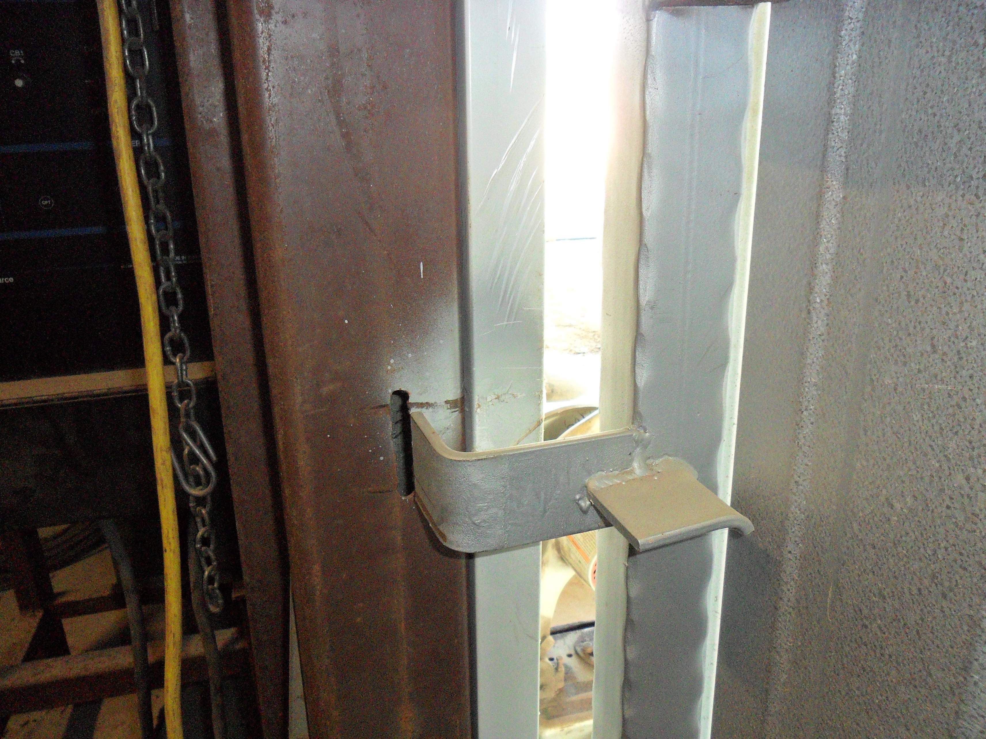

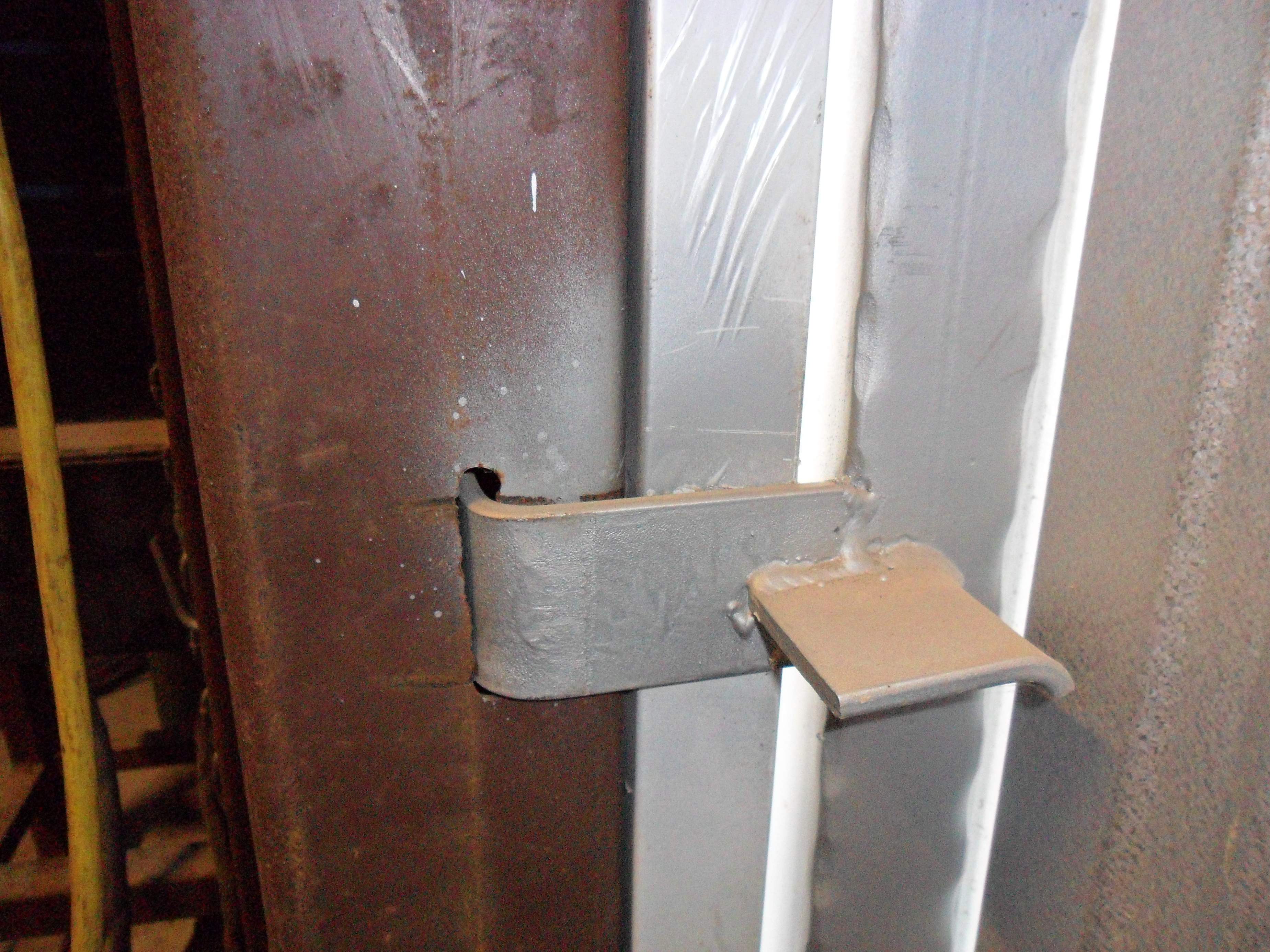

A friend of mine says I have too much time on my hands. He might be right.
What makes the door work is the right end has a tab that slides into a slot in the door jam. The fit is tight. That's what keeps the door from moving up or down on that end.

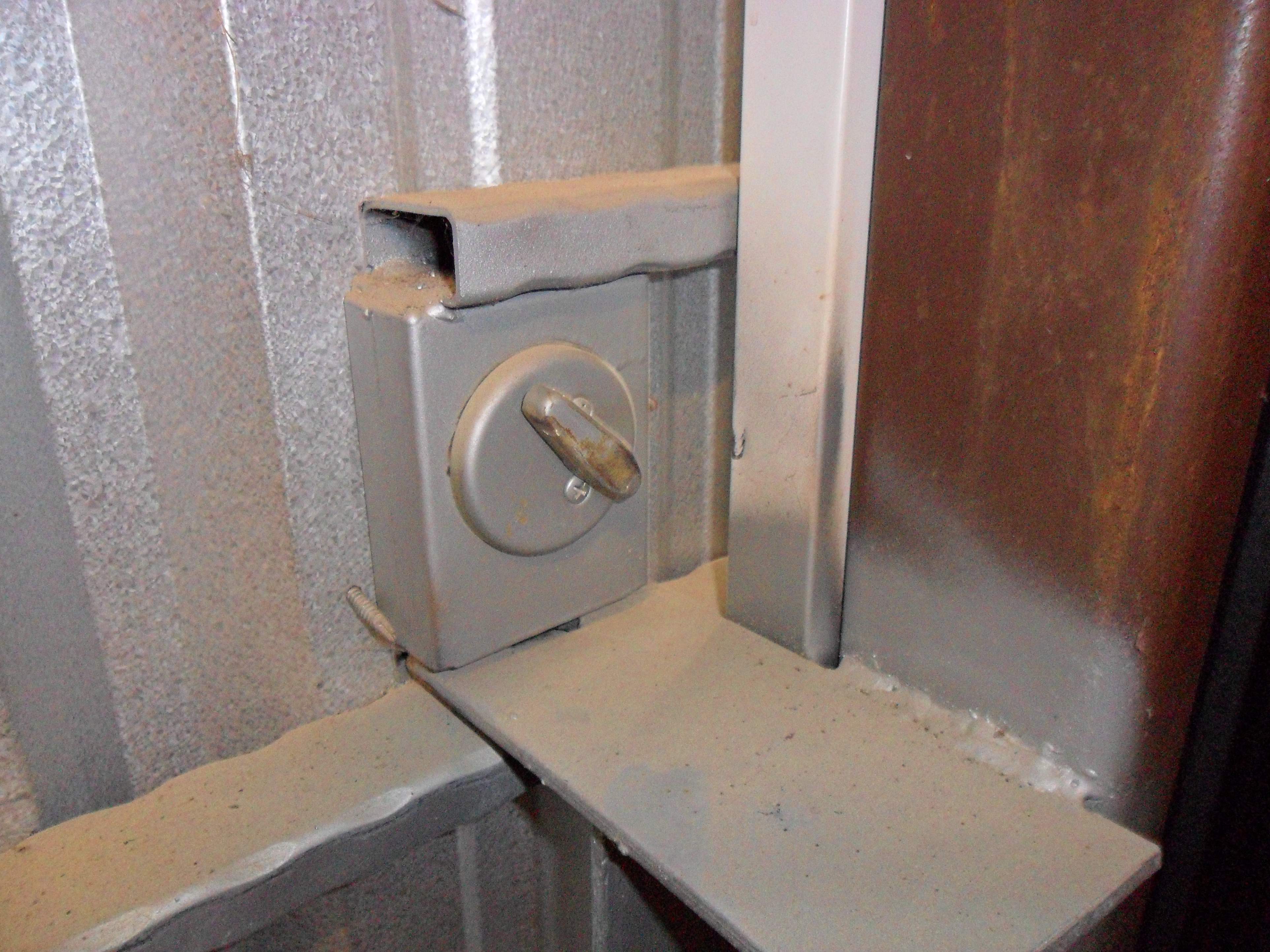

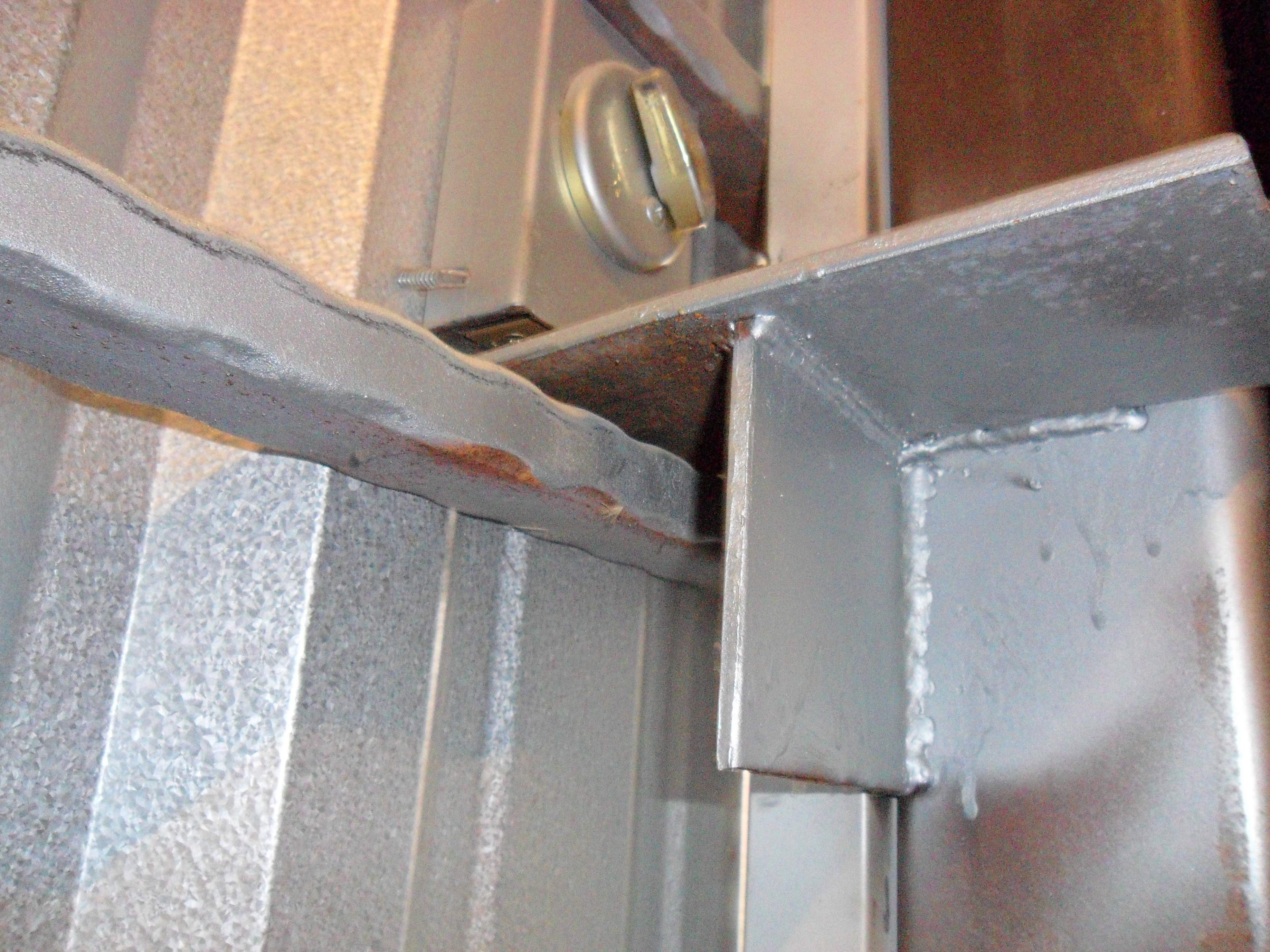

The left side has the lock. It's a standard one hole lock box you can buy at any ornamental supply.
The box itself slides in between some horizontal blocks. This keeps the door from moving up and down at that end. The dead bolt goes into a hole in the bottom horizontal block. This keeps the door from moving in or out at that end.
The door won't stop the determined thief. But it will slow them down and most of the time that's enough.
