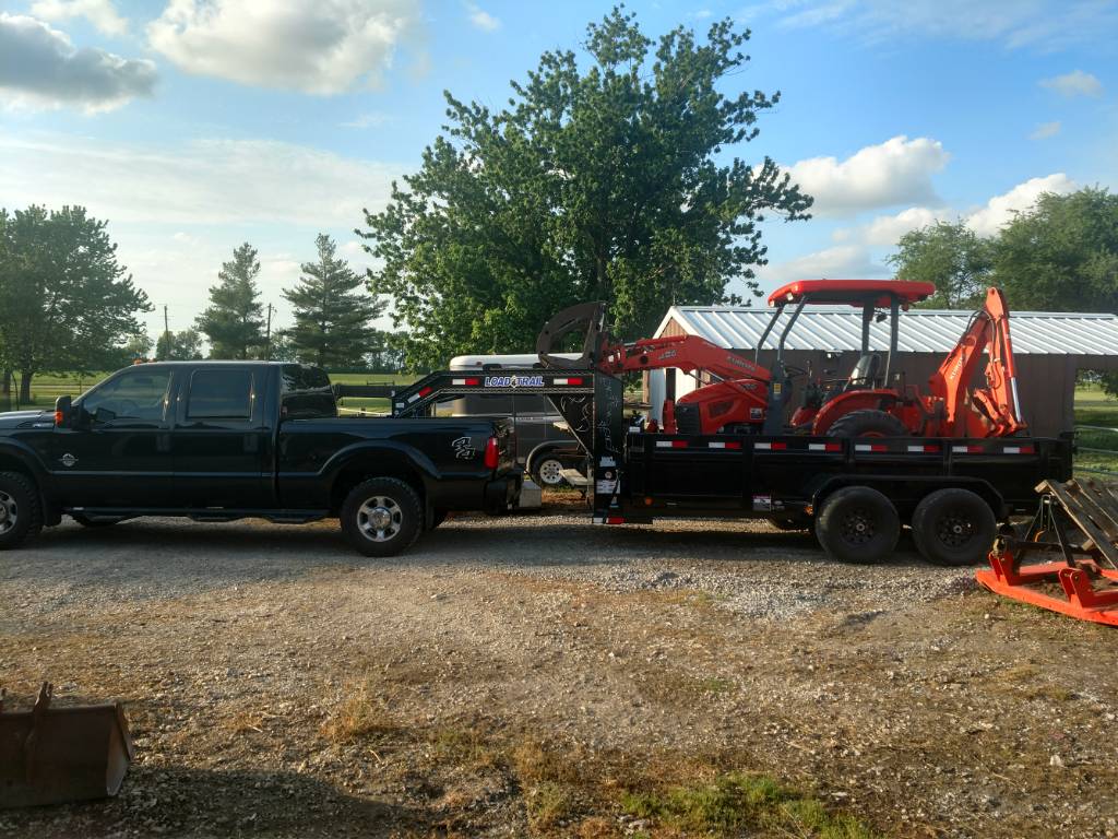

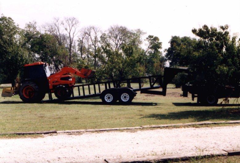

More info:
I have been considering a gooseneck deck over rollback trailer, but tend to procrastinate, so am still waiting for me to do it.
   / Sliding axle gooseneck #6
Nice pics X. I've never saw a trailer like that.

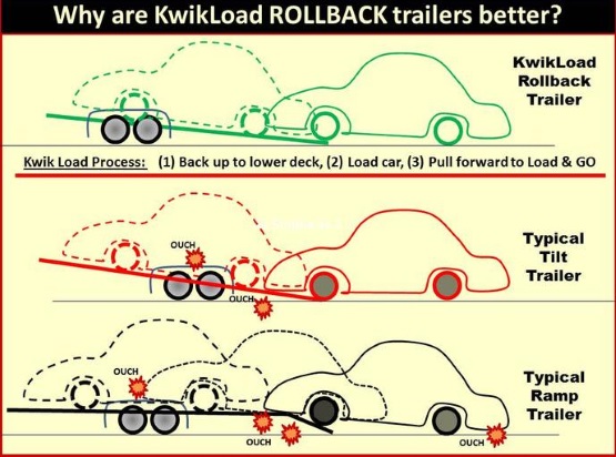

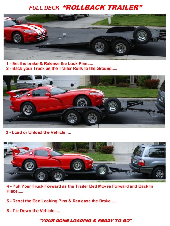

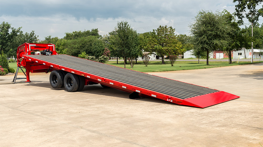

Pictures to prove it exists. This one is a combination sliding axle and tilt It would have less overhang behind the axles than a regular tilt:
When I was looking, Kwik Load said they could build a 16K GN Rollback for me, but I didn't pursue it any further because I am still able to lift the ramps on my 22' deckover 14K GN.
