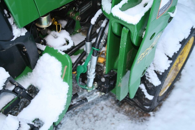

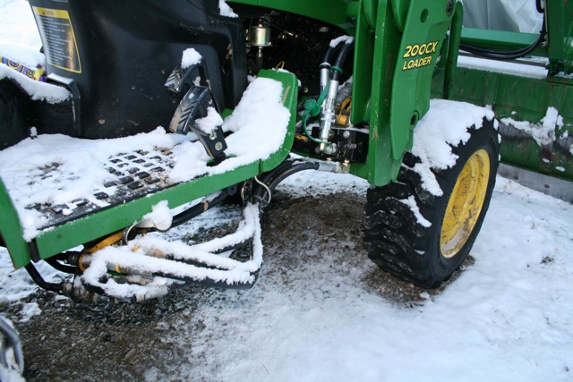

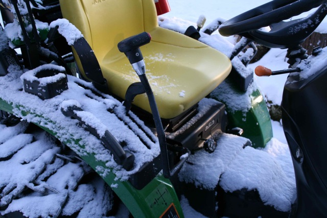

Sure it makes sense - I have the Gresen Diverter valve as do some other guys on the site. Included some pics - I am setting mine up to run a grapple - what kind of thumb are you talking about on the FEL? Anyway, without power the FEL works the same as always - with power from the switch on my joystick (OTTO electronics makes the handle) you divert the curl / dump function to open / close on the grapple.
Good Luck,
Brad
